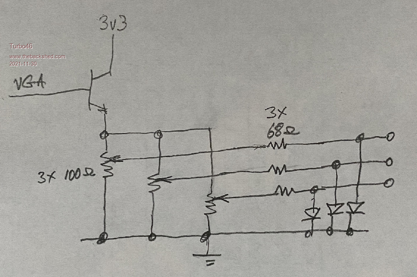

@Grogster, This would be my first pass at a circuit for VGA. Untested and I don't have an easy way to test it.
But I really think it's all a bit OTT and unnecessary. I think Volhout's suggestion is all that's needed, perhaps allow for different value resistors in place of the links to adjust the colour if it's needed.

  Turbo46 said  @Grogster, This would be my first pass at a circuit for VGA. Untested and I don't have an easy way to test it.
be wary: 2.7v into 33 ohm (3x 100 ohm in parallel) equals 80mA of current consumption JUST for the one-transistor video driver!

80mA and more through the monitor inputs. The PN100 is good for 500mA and 625mW so that should be OK. Minimum gain is 80 so only about 1mA base current needed. I did look at that because I was concerned about the load and dissipation.
Edit: I still think it's OTT.
Edit2: 80mA+ has implications for the power supply though.
Edited 2021-11-30 19:29 by Turbo46

The diodes can be omitted as all the monitors I have tried don't mind a bit of overdrive. Up to 1.5 V seems ok. A 270 ohm series resistor will ensure it stays under 0.8V for 3.3V supply.
With (270 + 75 ohms) x 3 at 3.3V = 29mA so the emitter follower may not be needed for this. The MX270 in the ASCII terminal did need it.

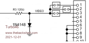

My preferred version of the VGA output.
A modified copy of the mono maximite circuit. The links allow selection of one or more colours and for those who want to fiddle, vertically mounted resistors could replace the links to produce any colour they want.
