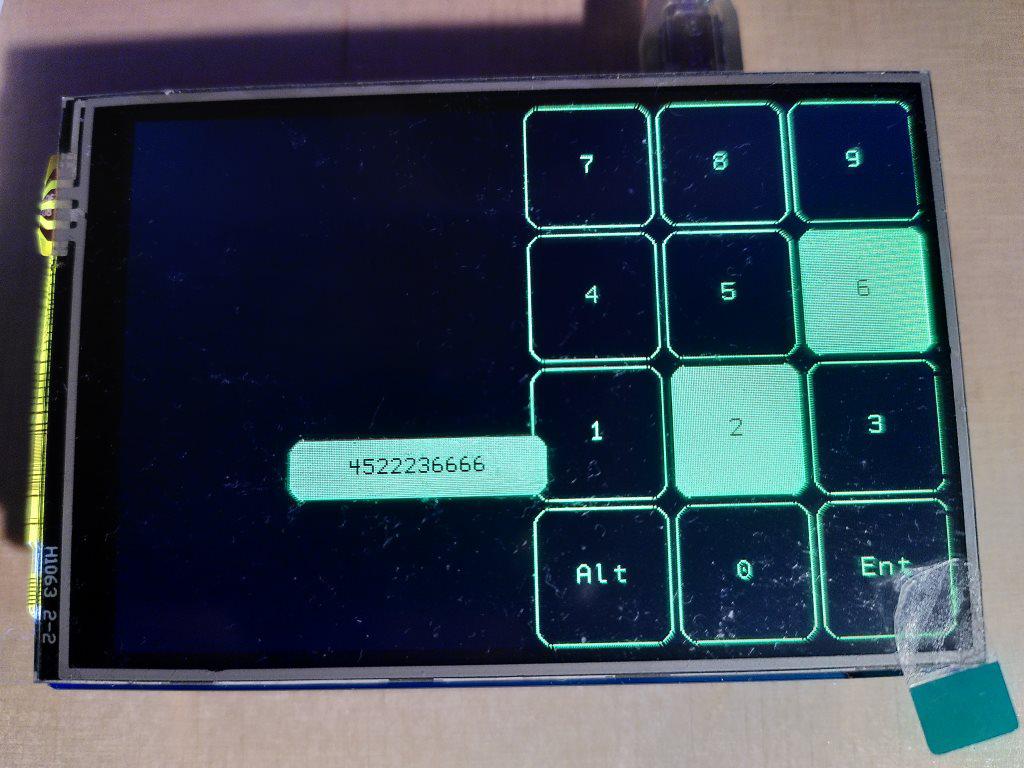

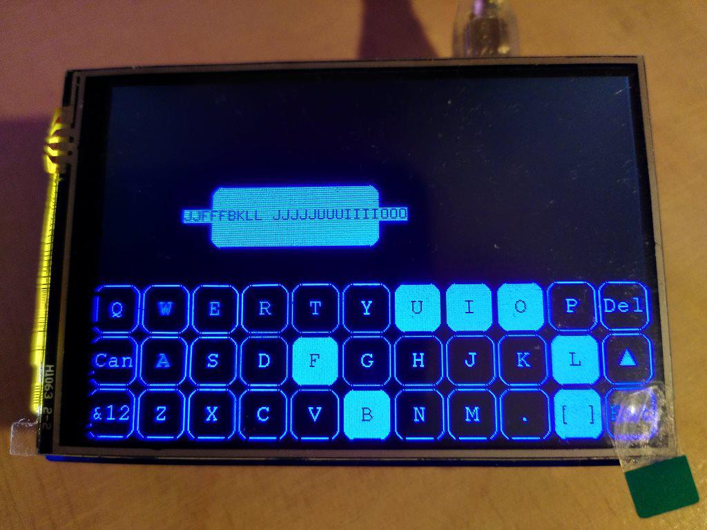

The two GUI elements TextBox and NumberBox still seem to be bugy.
Sometimes the keys remain inverted.
Also there seems to be no possibility to limit the text length, or the text length is only partially displayed [This is an example...] But the content is: "This is an example text and unfortunately too long for the box!"
How can I make sure that only integer values can be entered in the NumberBox? Best still with a value range, e.g. 0-127.
Posts: 3372
Posted: 07:42am 09 Nov 2021
  homa said  Sometimes the keys remain inverted.
Peter?  This sounds like one for you.
  homa said  Also there seems to be no possibility to limit the text length, or the text length is only partially displayed
No, there is no way to limit the length of the entered text.  However, you can trap the key up interrupt and rewrite the text (ie, truncate it) to suit your application.
  homa said  How can I make sure that only integer values can be entered in the NumberBox? Best still with a value range, e.g. 0-127.
Same as before.  Trap the key up interrupt and rewrite the number as an integer with the limits that you need.

led-bloon
Joined: 21/12/2014
Posts: 210
Posted: 09:28am 09 Nov 2021
I must be missing something ... what the hell is that item bottom right of both pictures, that looks like sticky tape attached to the (touch) screen?
led
Miss you George
Tinine
Joined: 30/03/2016
Posts: 1646
Posted: 09:35am 09 Nov 2021
  led-bloon said  I must be missing something ... what the hell is that item bottom right of both pictures, that looks like sticky tape attached to the (touch) screen?
led
It's the screen protector tear-off. Just hasn't removed it.
