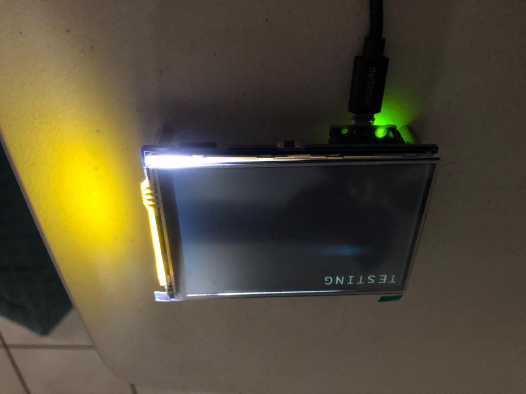

cdeagle
Joined: 22/06/2014
Posts: 273
Posted: 10:05am 17 Oct 2021
Peter,
In order to turn off the grey-to-white display of the 9488, I have to set BACKLIGHT 5.
Then I cannot see any graphics on the display. If I leave BACKLIGHT 100, the display seems to work, at least simple text and GUI TEST LCDPANEL. Of course it's hard to read.
Here's a photo of the display with BACKLIGHT 10 and GUI TEST LCDPANEL running.
David
Posts: 12185
Posted: 10:17am 17 Oct 2021
Just to confirm, the new ILI9488W driver is working but the backlight is overpowering?

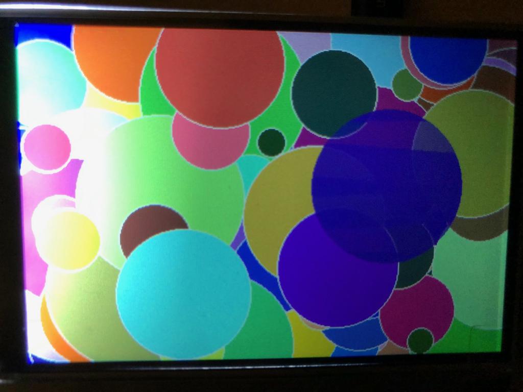

cdeagle
Joined: 22/06/2014
Posts: 273
Posted: 12:58pm 17 Oct 2021
Peter,
ILI9488W driver is working. Latest uf2 has reduced the display backlight almost completely. Still some on the right side of the display. Photo attached.
David
Posts: 12185
Posted: 01:02pm 17 Oct 2021
This is now using the initialisation specified by Waveshare in their demo code so nothing more I can do. The rest of the light bleed is presumably just down to the way the display is made. I'll post this version as a new beta.

Posts: 9329
Posted: 08:26pm 17 Oct 2021
It doesn't appear to be a very even backlight at all. Changing the brightness will be a compromise at best - it's the way the display is assembled. Either that or there's a bank of LEDs down the dark side that isn't working.
