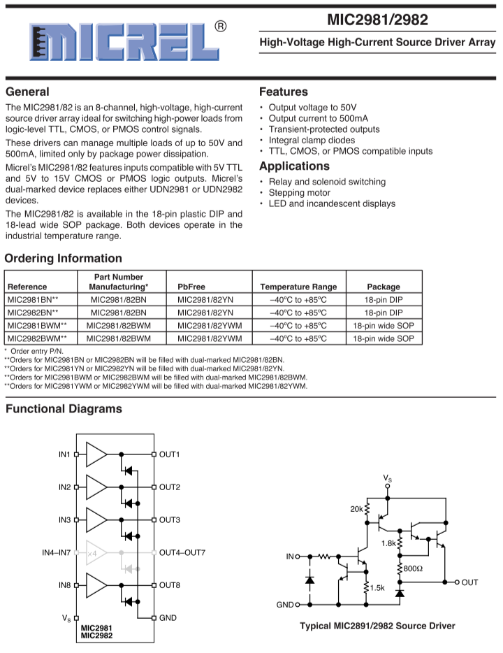

Tinine
Joined: 30/03/2016
Posts: 1646
Posted: 09:59am 24 Jul 2021
PeterB
Joined: 05/02/2015
Posts: 669
Posted: 10:13am 24 Jul 2021
G'Day Tinine et al
That is a bit light on for current but other than that it comes down to cost / convenience / availability / personal preference / etc.
Peter
And just to make it perfect, use a 4N25 etc on the input.
P
Edited 2021-07-24 20:21 by PeterB

Posted: 11:18am 24 Jul 2021
  PeterB said  G'Day Tinine et al
You can parallel the inputs\\outputs for extra current.
AliExpress
Mike
Edited 2021-07-24 21:23 by Solar Mike
PeterB
Joined: 05/02/2015
Posts: 669
Posted: 11:35am 24 Jul 2021
G'Day Mike.
Yes you can but I have always been a bit nervous of connecting things in parallel because you can never be sure how the current will share unless you install an R in each leg and determining the value leads to insanity.
I do think using an opto-coupler is a good idea when connecting micros to the outside world.
Peter
Tinine
Joined: 30/03/2016
Posts: 1646
Posted: 12:44pm 24 Jul 2021
  PeterB said  G'Day Mike.
Peter
Hi Peter,

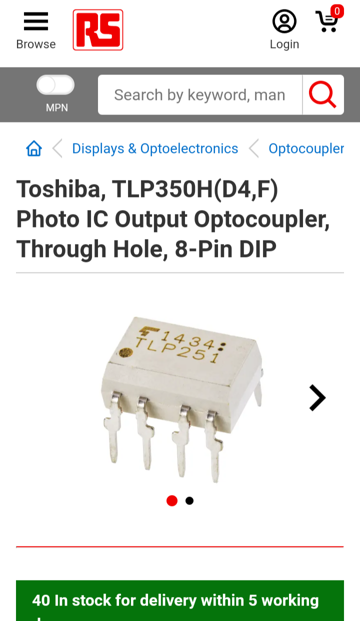

It's common practice to parallel the channels of these devices; it all boils down to the total dissipation.
I would probably use 4 channels for the 900mA and just because they are available, 2 channels for each of the 100mA loads.
Bearing in mind, also that; these are flashing lights and so, presumably, 50% duty cycle?
If opto is a a requirement then there is the TLP350H which will accomplish everything (2A).
Edited 2021-07-24 22:46 by Tinine
