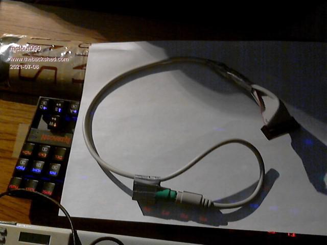

Thanks for responding Jim.  I would like to have a wireless connection to my PC for transfers and coding with MMEdit. Like I said I have a nice PS/2 mouse cable that I use but would like to free up the 40 pin connector for other things and would like a simple USB mouse connection. I can not tell from what I have found so far exactly how to install the HT mouse chip or if there are any other components that are needed to install to use it.
This is a very simple clean solution for a PS/2 mouse with that adapter added to let me use USB-PS/2 mice. I later added a overclock temp switch pigtail so I could use the overclock at will witch is no longer necessary. I need to remove that thing.  I just thought about something.  Will I have to rewire this because the 40  pin connector has been flipped to match the RPI pinout and key notch?
