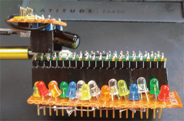

Control of LEDs on PicoMite using HTML
Running on a28 but not using any of its new features.
This uses the LEDs I posted about previously. Pins 1 and 2 are used by an ESP-01, which provides the wifi. Again thanks to Peter Mather not only for all the work on Armmite, CMM2, PicoMite, but also for the framework for handling the html.
I made a little perfboard for the ESP-01 with an LD33 regulator to drop down the 5V. I soldered female headers for the perfboard male headers directly to the castellated parts of pins 1-3 and 38-40 (not using 38 & 39, just soldered to them to increase strength).

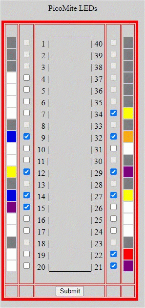

Here's what the HTML page looks like:
Unusable pins are grayed out. Checked pins are lit, unchecked are not. I didn't attempt to match the colors on the HTML form to the colors of the actual LED, though it would not be hard to do that. I used white as the color of an unlit LED.
After you check or uncheck one or more pins, clicking [Submit] submits the form, and the leds are updated almost immediately. It takes a few seconds for the PicoMite to render the HTML page.
Here's a 2-minute youtube video: htmlLEDs on PicoMite
And the program: htmlLEDs.zip

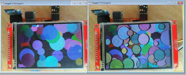

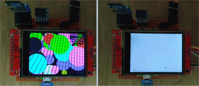

Success with ILI9341 ...
But only partial.
> option list
OPTION SDCARD GP5, 10
OPTION SYSTEM SPI GP2,GP3,GP4
OPTION LCDPANEL ILI9341, LANDSCAPE, 26, 25, 24
For the LED pin on the ILI9341, I used a 47R resistor, 3V3 to LED pin.
(The jaggies in the circles are a camera artifact.)
With this code:
' circles.bas q to quit
' font 1
Dim integer i
 x=Rnd*MM.HRes
 y=Rnd*MM.VRes
 c=Rnd*&hFFFFFF ' and &HF8FCF8
 r=Rnd*50+10
 Circle x,y,r,,,c,c
 a$=Inkey$
 If a$="q" Or a$="Q" Then Print a$+" Exiting": Exit
 i=i+1
 Print i;" ";
 Pause 100
Loop
The circles run through about 50 iterations--then the screen goes white. The counter continues to increment. Ctrl+C returns to the prompt, but running the program again results in white screen from the beginning and count incrementing.
Power cycling allows you to run the program and show the circles again through about 50 iterations.

Similar with ILI9488 with the same code, except that non-camera artifacts appear around iteration 50, and the screen doesn't go white until about 100 iterations.

Lizby, please try this version
a30
PicomiteV5.07.00a30.zip
I didn't get your issue but saw a different corruption. Unfortunately I think the problem is electrical.
Please try running your test with and without an SDcard inserted.
If you get the problem stop the program and type the command TEST then run it again - what happens?
I suspect the RP2040 pin drive is poor and the SPI data is getting misread which causes the LCD to change configuration

  matherp said  ... Lizby -- May also solve your issue - does for me. You may also need a second power source to the Backlight LED pin
The circles program works on a31 for both the ILI9341 and ILI9488--over 500 iterations on each before exiting with Ctrl+C.
I did swap a 68R resistor for a 47R on the LED pin, so a third less draw. Still bright enough for my uses.

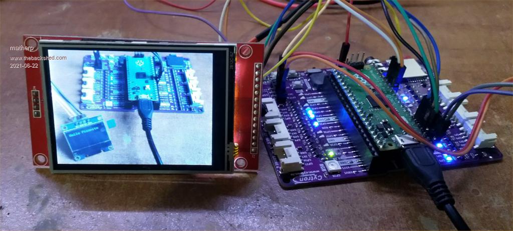

However, You collectively are reporting issues and these get even worse when an LCD is also attached to the SPI pins.
The problem seems to be electrical rather than software. So, for example, I was seeing corruption in the LCD with the SDcard inserted but not with it removed but still configured. Personally I don't see any issues at all with the SDcard.
I can now run reliably with the LCD and SDcard since I included an instruction to increase the pin drive level although I can't confirm this has effect when the pins are configured for SPI. I also power the LCD backlight with a separate supply from the USB
I'm using the Maker board as pictured above for development.

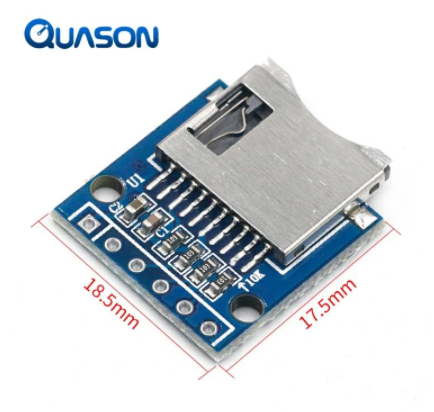

The SD card adapter that worked for me (at least superficially, I haven't really tried hammering this thing yet) was one of these:
I can see that it has resistors and a couple of capacitors, are the former the pullups we don't need ? - remember I really am "monkey see, monkey do" in my electronics at the moment.
I may have just been "lucky" in my choice, because I now see that there seem to be a dozen variations some with just passive components (like this one) and others with transistors (I think) and/or ICs. I don't suppose anyone can point me at a beginners reference to explain this variety ?
Posted: 09:38am 22 Jun 2021
You have pullups but they look like 10K so almost no load and not worth bothering about. The capacitors are GOOD
