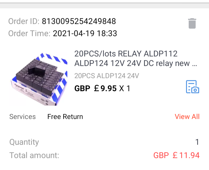

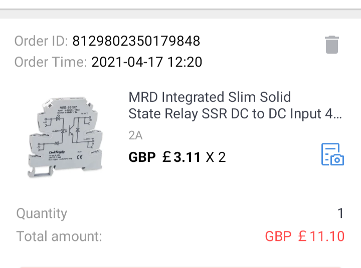

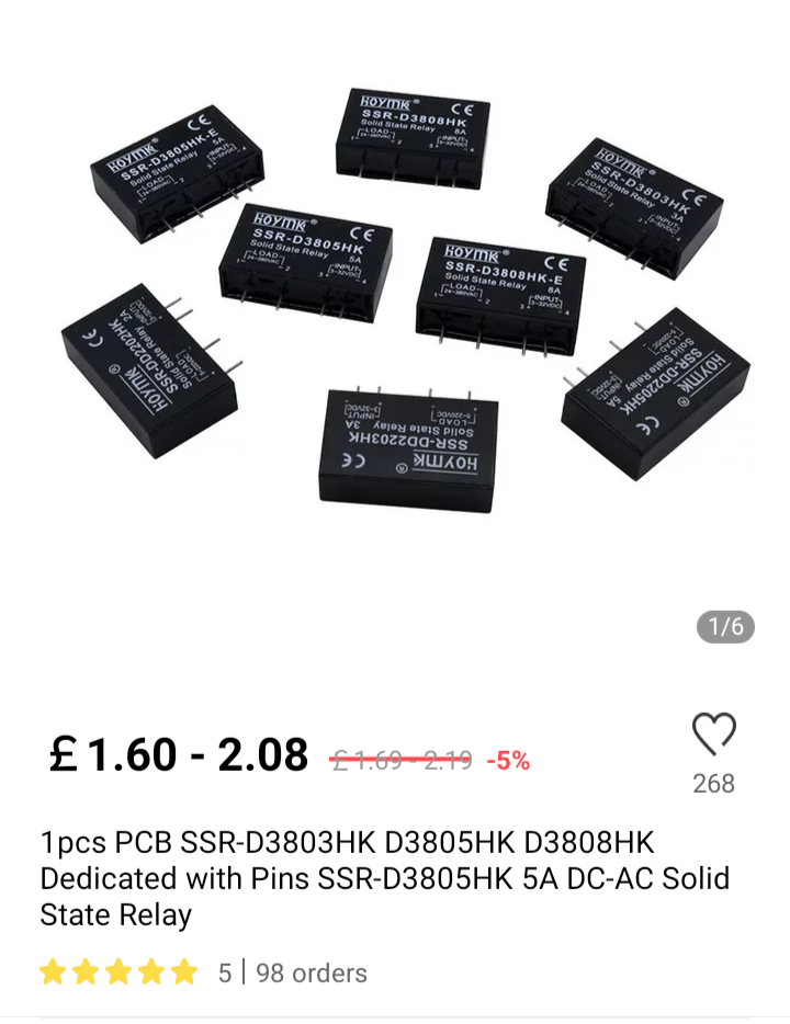

Stuff I have from Aliexpress that I intend to stress-test

Fun toys! :)
I like SSRs but there are some things they aren't good at - low voltage normally closed contacts for example. :)

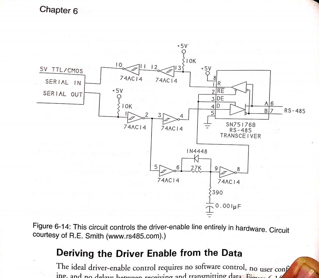

  Mixtel90 said  Fun toys! :)
I'd like to see the PicoMite get native RS485 multi-drop support. It would make a great field module.
As in regards to the 485 Enable?
I seem to remember posting this some time ago:

That's a very neat idea! I like that. :)

The timing in that hardware circuit works only at the baudrate it is designed for. And it may not work with slaves that respond too fast.
Not saying this is no good, but it is designed for an application.

Cheaper on wire to switch it in software and use another pin. :)

Were that an issue, it would be my opinion that the mistake was to go half-duplex.
My own systems are multi-drop 485/422; the master has the Tx enabled permanently.
All command/response and the slaves share the Rx line.
