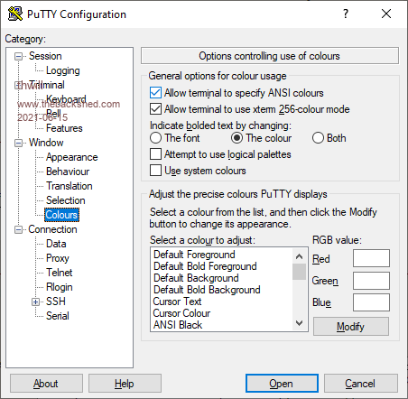

Perhaps, does the Linux version have this option page (from Windoze):
Is there some selection of options in the top-panel that "fixes" the discrepancy ?

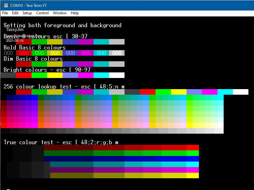

TeraTerm emulates a number of different standards, covering dozens of different terminals, and thousands of different escape sequences:
ECMA-48
AIXterm
Xterm
VT100 to VT340 (and VT525)
TEK4010
the authors of TeraTerm have literally scoured the web, collecting up enormous lists of escape sequences that have been compiled over the last 50 years, and - wherever they can - added support for those escape sequences to TeraTerm.
they have done this so that you can connect to almost anything and TeraTerm will have a good chance of being able to make sense of the data being sent back to it. TeraTerm even supports many miss-formed escape sequences, presumably to accommodate some obscure devices out there that erroneously produce them.
as such, TeraTerm is a highly versatile, extremely complex tool. it is the swiss-army knife of terminal emulators; you would be hard-pushed to find an escape sequence that it does NOT support. it also only runs under windows.

  thwill said  Perhaps, does the Linux version have this option page (from Windoze):
Almost the same, yes. (Under Window | Colours)

Posted: 06:49pm 14 Jun 2021
My linux version does not have
Use system colours
Attempt to use logical pallet

Sorry Jim, but wrt PuTTY this does not appear to be the case. Of the terminals I've tested only TeraTerm renders the colours as intended:
- PuTTY (now tested on Windows and Raspberry Pi) renders comments as grey (should be yellow) and numbers as white (should be red-ish).
 - I've played with the "Windows->Colours" options and that hasn't helped, though unchecking "Allow terminal to specify ANSI colours" does generate monochrome output.

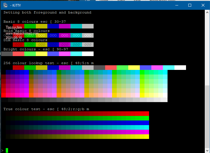

I have now cobbled a short test program for testing
 OPTION EXPLICIT
 OPTION DEFAULT NONE
 DIM INTEGER n
 DIM STRING E$ = CHR$(27)+"["
 CLS
 PRINT e$+"0m"
 PRINT " Setting both foreground and background "
 PRINT
 PRINT " Basic 8 colours esc [ 30-37"
 FOR n = 0 TO 7
   PRINT e$+STR$(40+n)+";"+STR$(30+n)+"m OOO ";
 NEXT n
 PRINT e$+"0m"
 PRINT " Bold Basic 8 colours"
 FOR n = 0 TO 7
   PRINT e$+"1;"+STR$(40+n)+";"+STR$(30+n)+"m OOO ";
 NEXT n
 PRINT e$+"0m"
 PRINT " Dim Basic 8 colours"
 FOR n = 0 TO 7
   PRINT e$+"2;"+STR$(40+n)+";"+STR$(30+n)+"m OOO ";
 NEXT n
 PRINT e$+"0m"
 PRINT " Bright colours - esc [ 90-97 "
 FOR n = 0 TO 7
   PRINT e$+STR$(90+n)+";"+STR$(100+n)+"m OOO ";
 NEXT n
 PRINT e$+"0m"
 PRINT
 PRINT " 256 colour lookup test - esc [ 48;5;n m"
 FOR n = 0 TO 15
   PRINT e$+"48;5;"+STR$(n)+"m"+e$+"38;5;"+STR$(n)+"m O   ";
 NEXT n
 FOR n = 16 TO 231
   IF n MOD 36 = 16 THEN PRINT ""
   PRINT e$+"48;5;"+STR$(n)+"m"+e$+"38;5;"+STR$(n)+"m O";
 NEXT n
 PRINT
 FOR n = 232 TO 255
 NEXT n
 PRINT
 PRINT e$+"0m"
 PRINT " True colour test - esc [ 48;2;r;g;b m"
 FOR n = 0 TO 255 STEP 8
   PRINT e$+"48;2;"+STR$(n)+";0;0m"+e$+"38;2;"+STR$(n)+";0;0m O";
 NEXT n
 PRINT
   PRINT e$+"48;2;0;"+STR$(n)+";0m"+e$+"38;2;0;"+STR$(n)+";0m O";
 NEXT n
 PRINT
   PRINT e$+"48;2;0;0;"+STR$(n)+"m"+e$+"38;2;0;0;"+STR$(n)+"m O";
 NEXT n
 PRINT
   PRINT e$+"48;2;0;"+STR$(n)+";"+STR$(n)+"m"+e$+"38;2;0;"+STR$(n)+";"+STR$(n)+"m O";
 NEXT n
 PRINT
   PRINT e$+"48;2;"+STR$(n)+";0;"+STR$(n)+"m"+e$+"38;2;"+STR$(n)+";0;"+STR$(n)+"m O";
 NEXT n
 PRINT
   PRINT e$+"48;2;"+STR$(n)+";"+STR$(n)+";0m"+e$+"38;2;"+STR$(n)+";"+STR$(n)+";0m O";
 NEXT n
 PRINT
 PRINT e$+"0m"
Posted: 05:00am 16 Jun 2021
And the winner is
Kitty (sorry, Windows only)
https://www.fosshub.com/KiTTY.html
Kitty is a fork of Putty with a few extra features added.
It correctly renders DIM text. DIM and BOLD do not change the backcolour.
Compared to TeraTerm:
Posted: 05:09am 16 Jun 2021
  TassyJim said  And the winner is
hi jim,
  have you tried Kitty with an MX170 and with OPTION COLOURCODE ON editing a program? that is the cruncher.
rob   :-)
