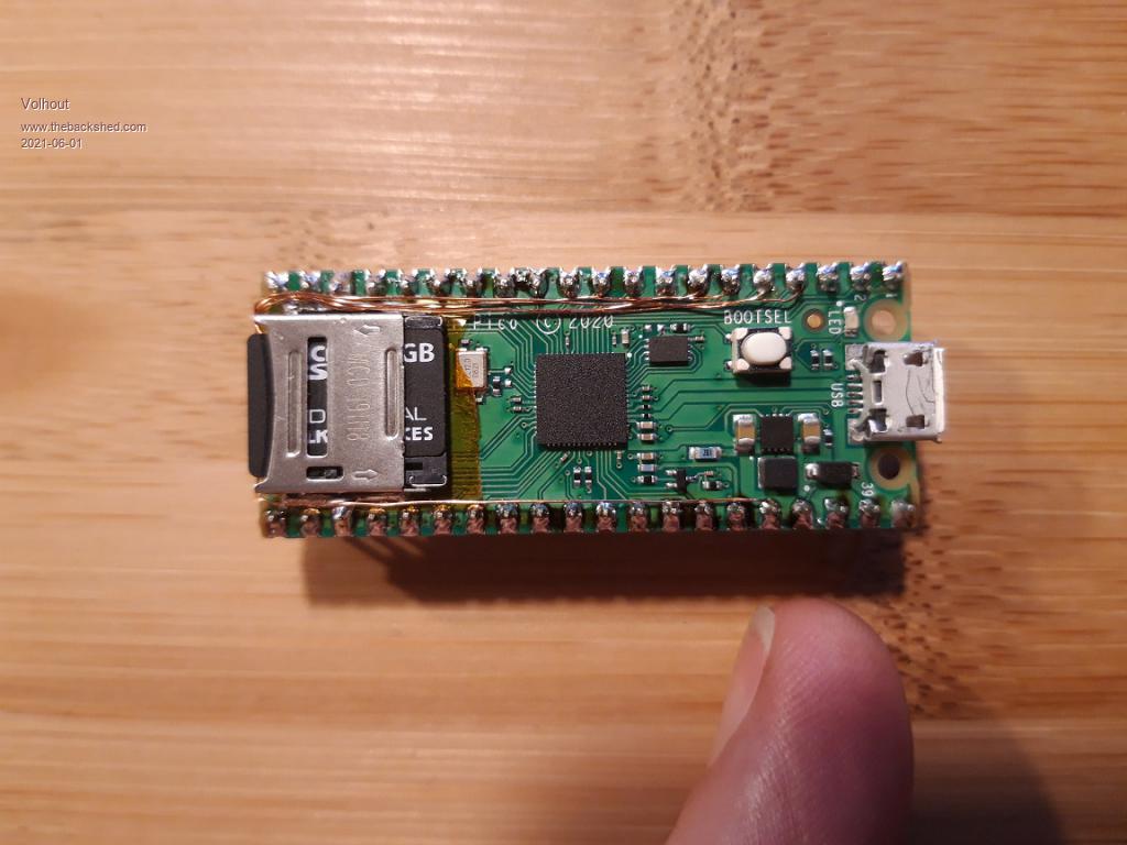

Posted: 07:13am 01 Jun 2021
SD card... it just fits...
Posts: 9329
Posted: 07:48am 01 Jun 2021
Wow....
We are not worthy!  lol
Nice bit of wiring there. :)

Posted: 09:41am 01 Jun 2021
  Volhout said  SD card... it just fits...
very neat!
Before acquiring my laser I used to backwire most projects where I was doing one-offs/small runs. I find it quite therapeutic. The netlist from Eagle makes it really easy not to miss anything.
Edited 2021-06-01 19:43 by CaptainBoing
