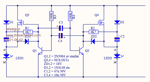

I'm sure Mike Or Warp will help decide if it will work.  Its a simple multivibrator driving the two FETs alternately. It bootstraps the gate voltage for the FET when they turn on to ensure they are fully enhanced for the "flash".
That's a very clever design there wiseguy, looks like it will work, I would never have thought of that; but something more complex comes to mind.
  wiseguy said  .. Dont know how Mike puts up nice schematics within the post I'll just link it to a pdf.
Export from DipTrace and screen capture to png file.

Ok here goes for a schematic without having to go pdf.
Sorry for this essentially useless post.....I created it with "getgreenshot" straight from Altium into a png.
Cheers Mike
Thanks for the compliment.
"But something more complex comes to mind" had to laugh at that.  In its first iteration it had 4 Fets 2 transistors and a lot more stuff. Half the fun was trying to minimise the component count and in the process make most remaining components perform more than 1 task !

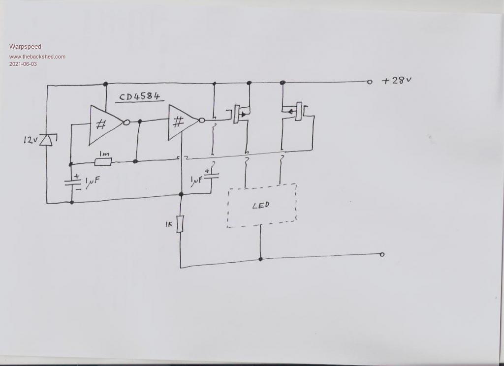

Posted: 07:01pm 02 Jun 2021
The most minimalist design I can think of uses a CMOS chip as the oscillator and a couple of small P channel mosfets.

Posted: 01:42am 03 Jun 2021
  Warpspeed said  The most minimalist design I can think of uses a CMOS chip as the oscillator and a couple of small P channel mosfets.
Warpspeed I'm trying to understand how Mosfets work on the negative .
If I took your circuit and put the Lights on the positive side of the MOSFETS could N channel mosfets be used then? Could I invert the cmos outputs to achieve the same thing?
Edited 2021-06-03 11:44 by bob.steel
Posts: 3421
Posted: 05:17am 03 Jun 2021
No, for Warpspeed's design if the LED lamps are tied together at the negative end the MOSFETs have to be P-channel.
If you want to use N-channel MOSFETs Wiseguy's circuit is the best option. Capacitors C1 & C2 provide the required voltage boost to drive the gates. The zenner diodes, when forward biased turn the MOSFETs off and when reverse biased limit the gate voltage. Very clever.

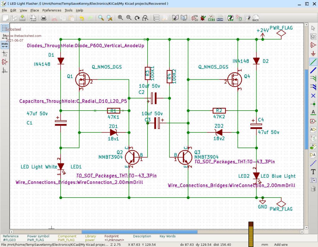

I have spent the last 3 days working on understanding and using Kicad.
Got a few problems to sort out but I'm getting there for a board . Ill throw my schematic up here for comment if I may.
Also I built the circuit today , roughly on vero board but its a start . Used electrolytic capacitors as that's all I had , no tantalums  ,and I used 2655 transistors and BUK456 Mosfets .
It does not work at this stage but it draws no power when connected. On connection it flashes each led briefly and then stops.
I put a couple of LED's in with 330 ohm resistors to facilitate a test.
So I'll have a break and go do something else for a while then come back and check the circuit again. Probably something I've done .
My Kicad project.zip
If R3 & R4 in my schematic were left unconnected instead of being joined to the + supply it would behave as you have just described.  Sorry I dont have Kicad so could not check your schematic.
PS: Clarification required, both LEDs flash at the same instant or alternately ie one flashes & then the other ? - I am assuming the latter, alternately re my R3,4 comment above.

R1 & R2 should be 4K7 not 47K. In your schematic it appears as though R1 is shorted out - the line through the centre needs to be deleted, otherwise a good effort.

The brief flash at power up would be due to initial charging of C1 & C4 through D1 & D2.
If it still fails to oscillate after changing R1 & R2 and removing the bridge across R1 it could be caused by the number of LEDs in series in the lamps. In that event adapt Warpspeed's CD4584 oscillator circuit to drive Q2 & Q3 via 10k base resistors. The 1k series resistor in the negative supply must be moved to the positive supply and the negative of the oscillator tied to ground. Remove C2, C3, R3 & R4.
