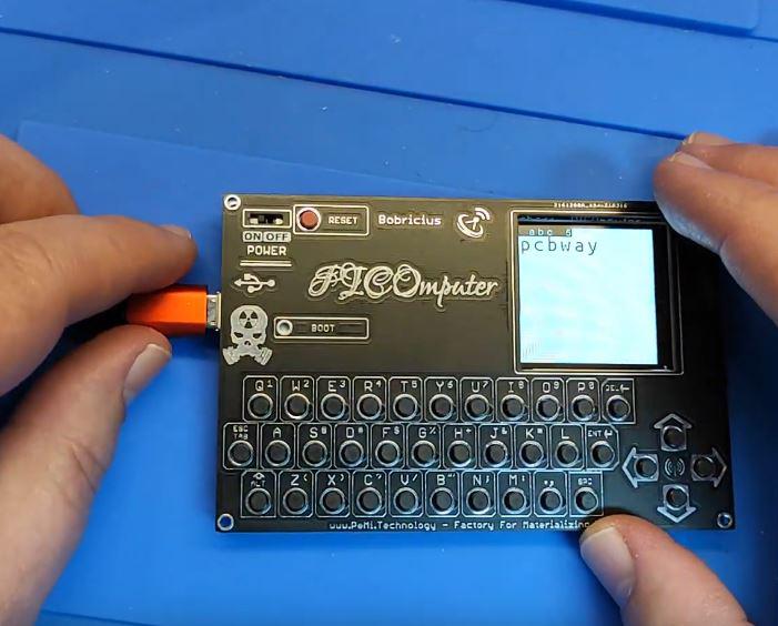

now an interesting possibility: hook two pico's together via their USB ports - the pico is capable of acting as a USB host. pico 'A' (as a CDC device) could run mmbasic, with all the I/O pins free, while pico 'B' (as a USB host) could act as a VT100ish terminal, drive an LCD screen, and scan a matrix keyboard. this terminal emulation could be written in python, largely using existing code that is already out there.
this could give you a neat little pocket computer in a form-factor similar to this:
rob   :-)
Edited 2021-05-29 01:09 by robert.rozee

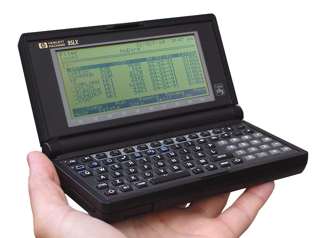

  robert.rozee said  ... this could give you a neat little pocket computer in a form-factor similar to this ...
Nice. Though you might save yourself a lot of trouble by buying a second-hand Psion Series 5 on ebay, OPL was a neat BASIC inspired language.
Edited 2021-05-29 01:35 by thwill

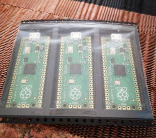

Posted: 11:39am 29 May 2021
woot! less than 24 hours delivered.
just need some firmware... now what should I use? ...

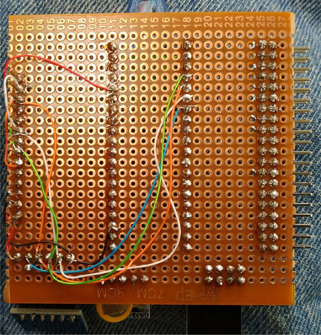

And with SD card:
Hello, world from PicoMite
> flash save 2
PicoMite MMBasic Version 5.07.00a0
Copyright 2011-2021 Geoff Graham
Copyright 2016-2021 Peter Mather
> flash run 2
> files
A:/
     4208  ta.bas
     4698  tain.txt
0 directories, 2 files
> save "hello.bas"
> files
A:/
       36  hello.bas
     4208  ta.bas
     4698  tain.txt
0 directories, 3 files
> load "hello.bas",r
> run
> list
Print "Hello, world from PicoMite"
I used this micro sd module because I had some.
Wiring:
My Newfoundland wife says I have a tendency to be what in Newfonese is a "keener". Is this proof?
