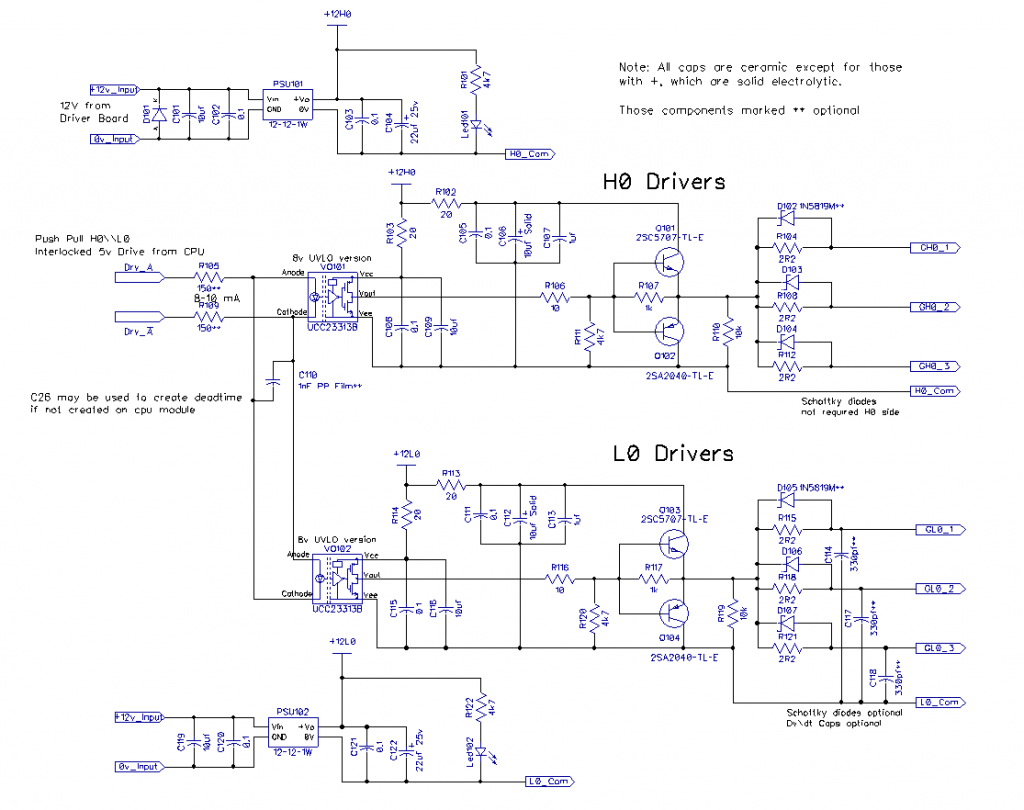

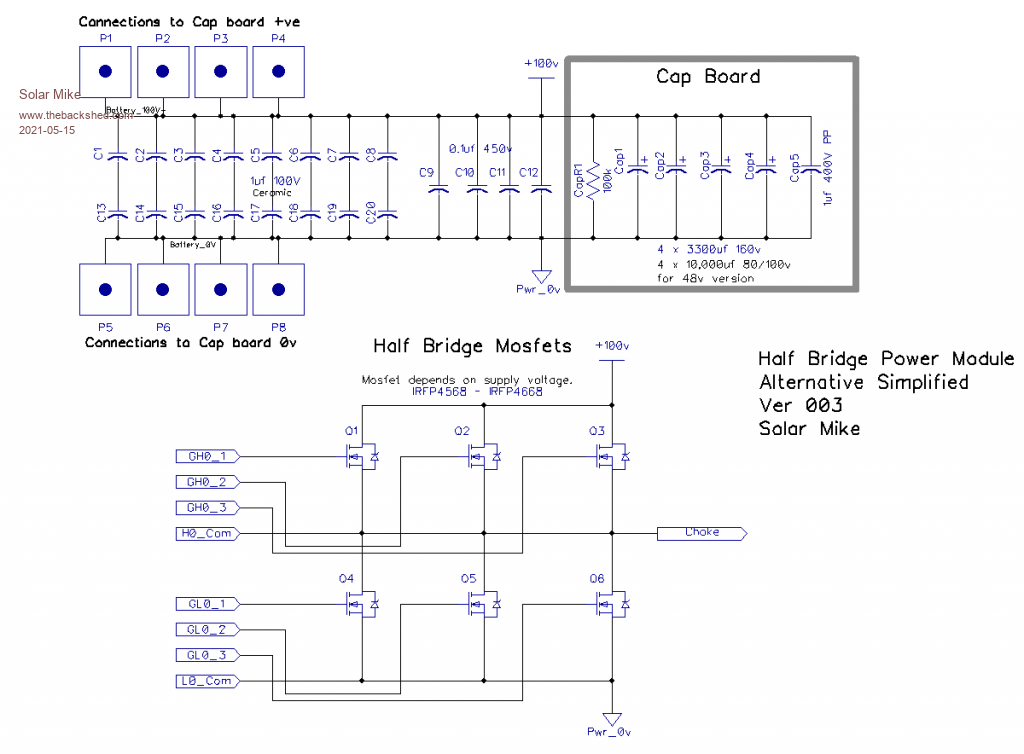

Am building two versions of this, first having tight coupled drivers on each mosfet, second using a totem pole high current booster driving the three mosfets in parallel.
Second less complicated variant shown below.
Changes:
1: Input pwm drive has been changed to interlocked push-pull, where a pair of buffers on the cpu board supply a plus\minus drive that includes the dead-time delay. To accommodate this the old simulated opto driver from ver 1 has been replaced by one that allows up to -18v on its input.
This allows an interlock mechanism where there will be no drive output if their input signals are the same.
Because this design allows multiple power modules to be paralleled for higher output power, it is not recommended to use ordinary "opto" driver chips like the 10 year old FOD3182 or similar, they have too much delay variation between chips, making any synchronous operation very hit and miss.
2: The totem pole driver is a variation of Wiseguys circuit, he has used on his inverter, I have added additional components to help alleviate dv\dt shoot thru on the L0 part as I'm not using a -ve ground bias. Don't replace the spec'd transistors with tip31/32, they are too slow and low in gain for this application.
The original Ver1 will also be changed to use the newer UCC23313B driver chips, so I can swap between boards to see which performs the best, or produces the less smoke.
Edit C110, not used here as the dead-time will be created on the Master CPU board, have allowed a place holder for it on the pcb, should anyone want to use a different master driver with no dead-time output and driving a pair of 1/2 bridge modules only.

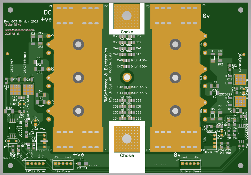

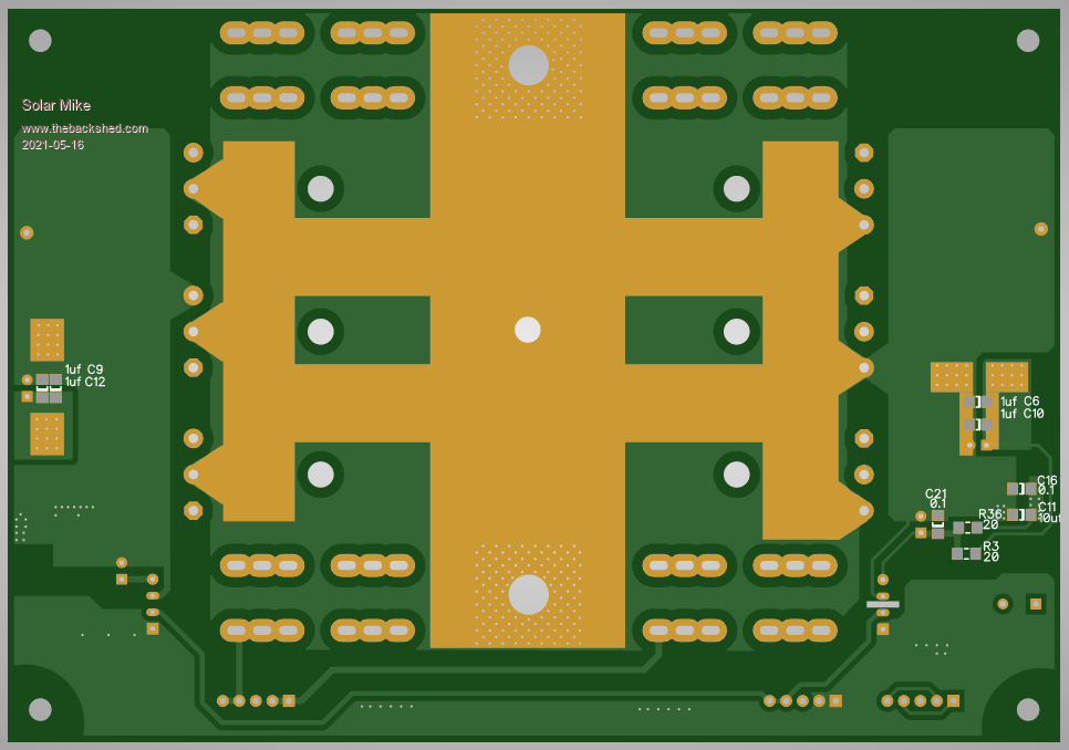

PCB for above, couple minor circuit changes, will post later after doing some more checks.
Mike

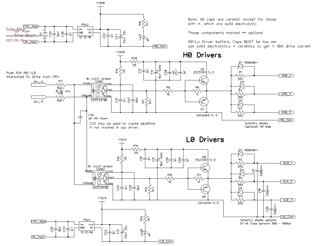

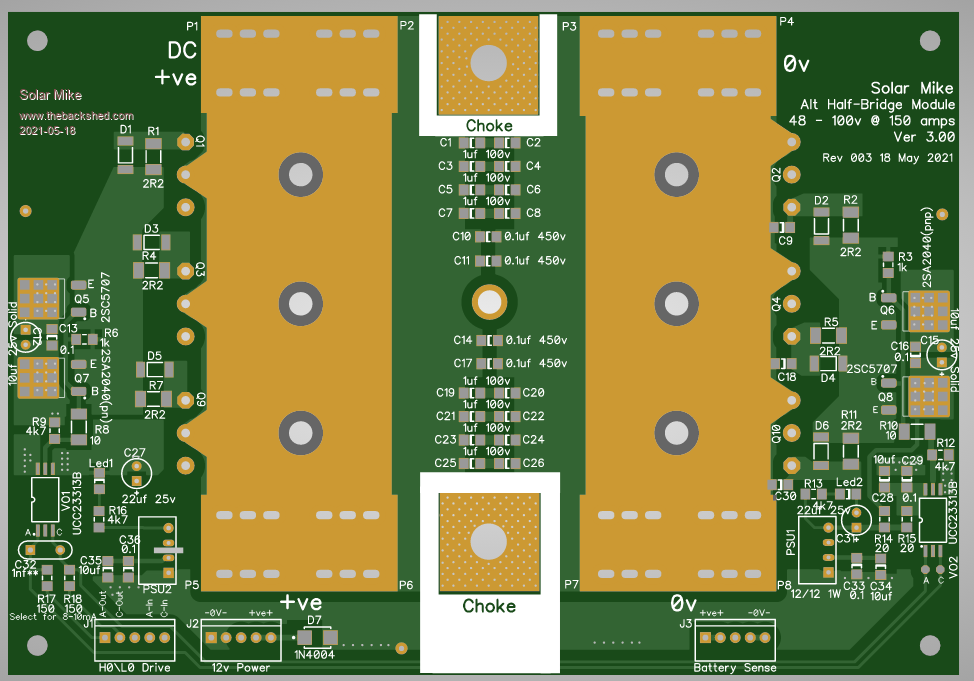

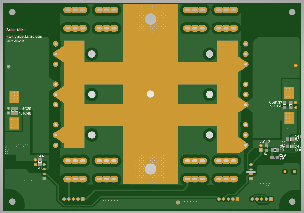

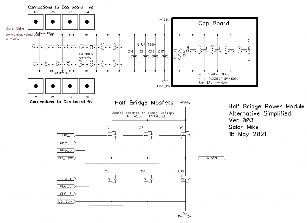

Have a final schematic and pcb for the alternative simplified half-bridge power module, no changes have been made on the bulk capacitor board.
Few changes made are; removal of 10K resistors on mosfet gates, not required as there is already a path to source via the buffer transistors. Couple of extra bypass caps added here and there.
With the cap board bolted on and if 1oz copper is used for both, 150 amps would be a conservative upper limit, no busbars etc.
There is room to add busbars, however the 8 bolt on terminal posts for the cap board then become a limiting factor.
This design is not for high current anyway, but to have multiple parallel modules combined in a synchronous arrangement to get the desired power output.
Initially I was going to use 2oz copper, but with the first test version will go for the cheaper 1oz.
Will next alter the first version using gate drivers on each mosfet to use the same UCC23313B coupler, then send them off to be made.
As it stands its not really compatible with the CPU + driver module that Poida has created, so I will have come up with an alternative as the next stage in development in order to test the design.
Mike

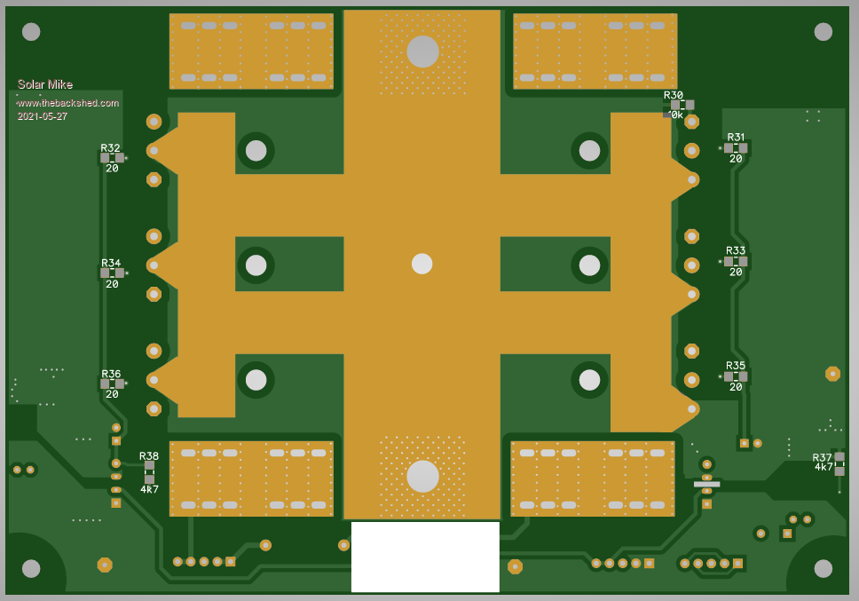

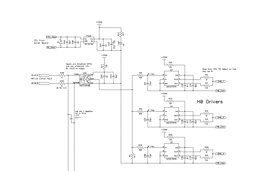

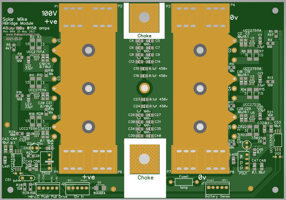

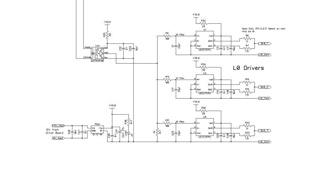

Have finally made changes to the first more complex design with a driver/mosfet; added the same cross coupled UCC23313 simulated opto-couplers to the input, will have to now modify the schematic to match.
Think I have settled on a suitable driver module incorporating deadtime etc for these, will make this a small sub board that plugs into the main CPU pcb. 10 Pins (0v, 5v, +12v, CPU_H, CPU_L, CPU_Enable, Out_H0L0, Out_H1L1)
Will also create a 2nd capacitor pcb that uses different sized caps before sending the gerbers off.
Half Bridge modules are 113 x 162mm

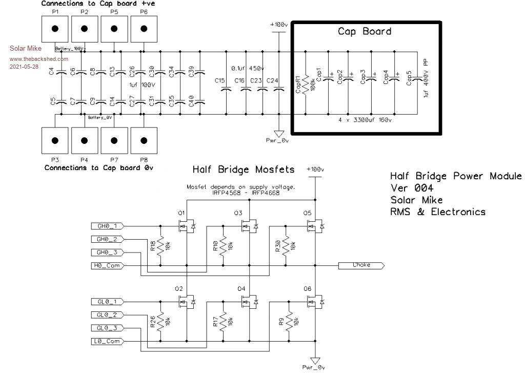

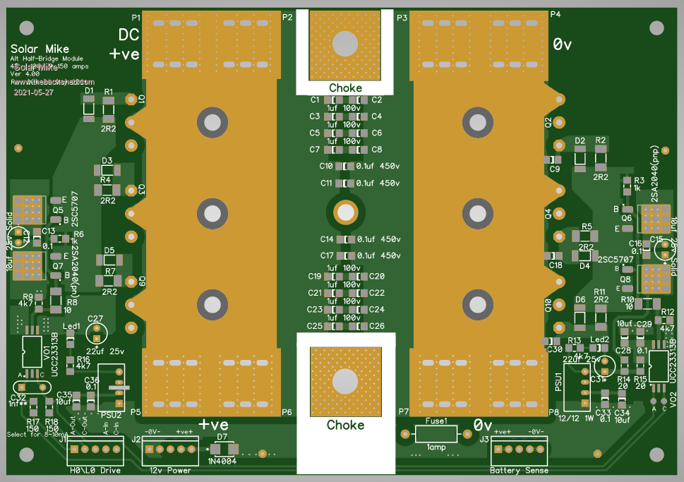

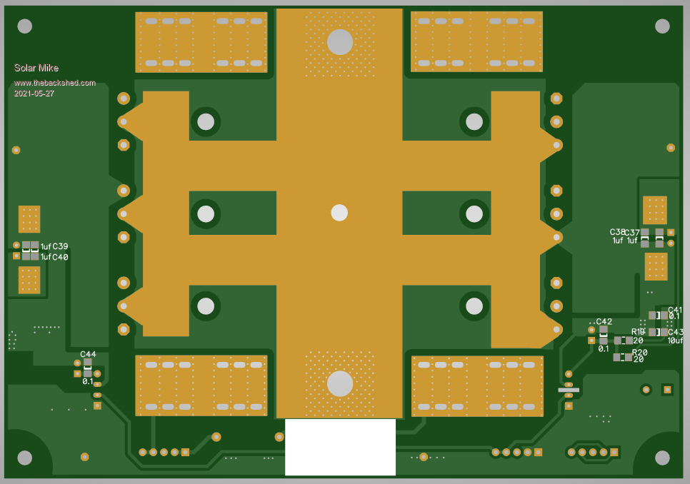

Top:
Bottom:
Alternative layout:
Will post gerbers once schematics updated.
Mike
Edited 2021-05-27 12:57 by Solar Mike

Circuit:

Just noticed an error on the note for the L0 1.5r gate input resistors, it should read:
R7,15,23 can be 0r as the mosfets have an 1r impedance and the driver has a 0.375r output.
The lower these resistors the better resistance to false turn on from the H0 stage.
When I test the board will try both 1.5r and 0r
Mike
Posted: 01:50am 28 May 2021
Resistance also provides some damping to the parasitic inductance and capacitance.
See how it goes, but if you see ringing and overshoot on the gate waveform, adding some resistive damping or a ferrite bead can be beneficial.
Its all a tradeoff....

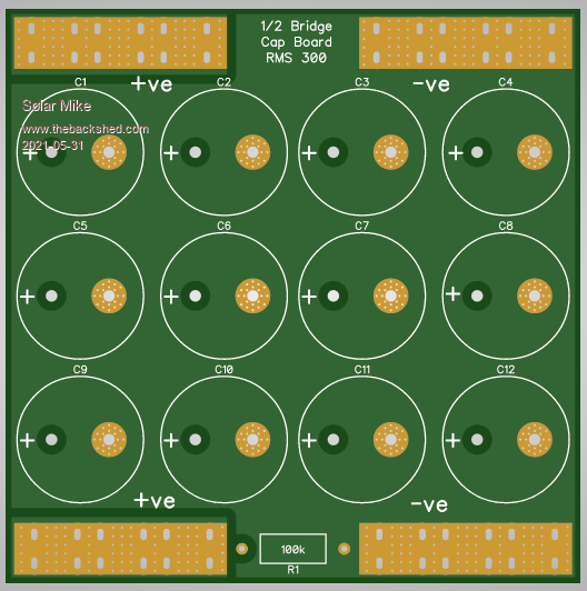

Have sent gerbers for all pcbs + several additional cap bank cards to JLCPBC Cart, now have to do a simple Dead Time driver module to include in the above, to save postage.
Drawing two designs for this now, will use the Si8234AB-D-IS1 chip to get the variable timing as one module, the other will use an LM5105MM/NOBP chip, they both have similar functionality but stocks are running low everywhere, so I think 2 driver cards is a good idea incase of shortages.
Expect each will be a small plug in pcb about 50mm x 50mm
I have received the Pi Pico boards, whether I can use them for the CPU is another story.
Here is another Cap Module to use smaller value electrolytics, have placed right angle connectors on the pcb, so I can stack the boards vertically using a 0.5mm x 45mm wide copper shim as busbars.
Mike
