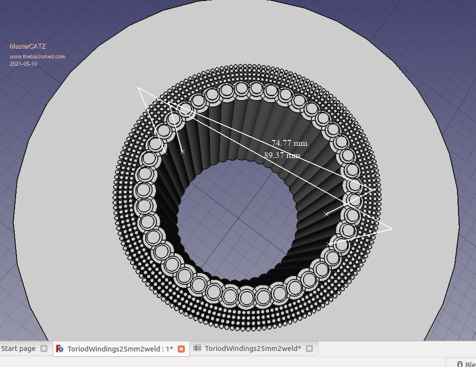

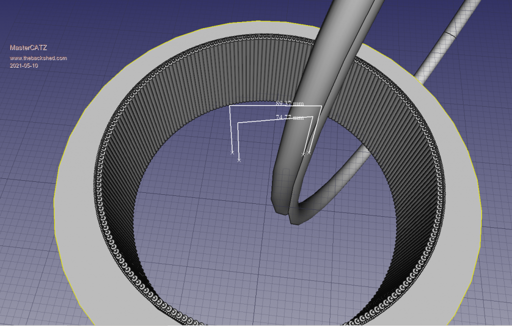

does anyone know the maximum size of the hole in the center ?
because it bugged me not having the primary making contact over all of the core
using the 50mm2 cable
I widened it up so I can use 25mm2 side by side single layer
it has a 90mm opening after being wound is is this bad?
or is having the center gap of the primaries the goal
50mm2 had 75mm gap
230mm external  130mm internal
70cm2
21 Primary Turns 2x 25mm in hand = 50mm2 circuit 250AMP continuous
166 Secondary Turns 4 Layers 2.54mm2 = 10.18mm2 circuit 50 AMP continuous
12kw continuous capable if cooled ?
1:7.9 ratio
Edited 2021-05-10 17:13 by MasterCATZ

All the questions you are asking are in the 2nd Edition OzInverter book, and yes its on its way to Australia.
The core is made of, usually 0.3mm thick silcone iron/steel, quality is important thats why we test the core during winding.
Your winding drawings look good on paper, but and a big but, in practice you should use them as a guide only as the corners/90 degree bends, of the cable bulk out a bit and things through the hole get real tight.
Just get the cables through the hole, every time a cable passes through the hole it is One turn. Remember that anything in that hole, ie a holding bolt becomes a turn and is active so insulate it.
Size of hole, depends on the stack ie, the thickness, 130mm hole is okay you can stack a bit more and a 90mm hole left after winding would be heavenly, i normally find that i can just get a 12mm dia holding bolt though my wound toroids once finished.

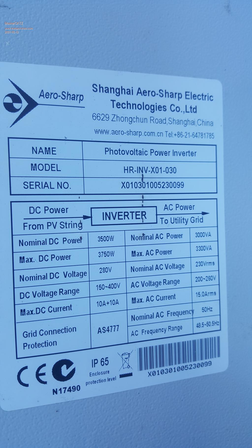

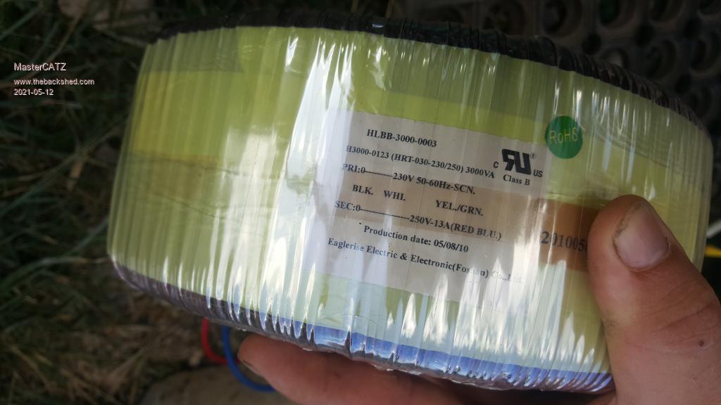

ok so the goal is to have a tightly wound hole ?
not having much luck freeing these cores they are stuck down good I might have to buy a minni crowbar to try and get under them , can not get the other 3x coils off the case either so no room to leaver , any solvent that can be used ?
and of cause the one angle I can not take photos is the transformers label it is hard against the case
tho I might be able to get the snake cam in
Haxby
Joined: 07/07/2008
Posts: 427
Posted: 04:01am 12 May 2021

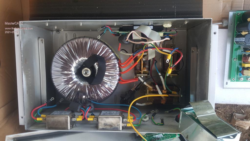

Ah that's an Aerosharp not Aerostar.
All good. Plenty of experts here on that brand.

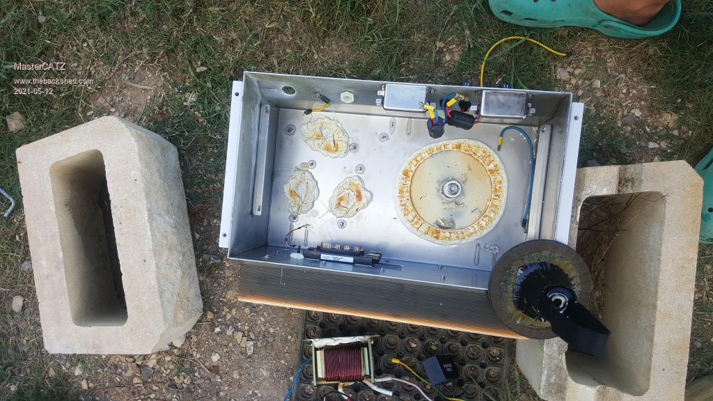

Getting the transformer out is easy! First disconnect all wires, then turn the box over, lift to about 600mm height then drop it on the ground! The toroid will dislodge and fall out. The screw and epoxy centre stay with the box.
That's how I did 7 of them so far and they all turned out great.
You might want to work up to 600mm height drops depending on how well it is stuck down. I'll video my next one.
I did mine on a grass lawn so there was no damage to the windings when it eventually popped out.
If you were to do it on concrete, you would want some styrofoam or something to catch the transformer.
Are you in Melbourne per chance?

well we ended up getting the torch onto them and heating the box up
