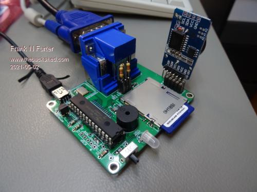

Frank N. Furter
Joined: 28/05/2012
Posts: 1185
Posted: 08:10pm 01 May 2021
Here you can see my setup:
The only thing I notice is that you hear a soft noise from the piezo when you try to write the date or time. I will try it tomorrow with a pull-up...
Frank

Posted: 08:51am 02 May 2021
The single soft "pop" noise from the speaker is normal. It shares the same SCL line.
PS. Try this updated version R112d on the website. I have added some additional initialisation on the I2C bus every time a transfer starts. Running it in all possible configurations and see no issues whatsoever with the RTC.
One thing I noticed - your date shows year 2000. If there is no RTC, the system time defaults to year 2021. The only way you see year 2000 according to my experiments, is when there a RTC with no battery. So, I would suggest check the battery in your module as well.
Edited 2021-05-02 20:31 by knivd
