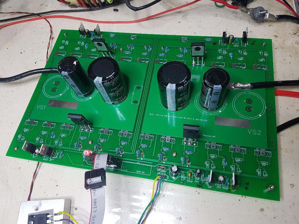

The power board PCB design is done.
I want to provide a complete home built battery based solar power system for all.
All PCB files will be compatible with EasyEDA.

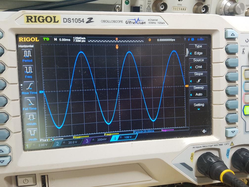

Here is the output voltage with zero load. A nice sine wave.
One error in the PCB tracks and 4 errors in the PCB silk screen.
Not too bad for a first go at a 6kW power board.
I can't complain.

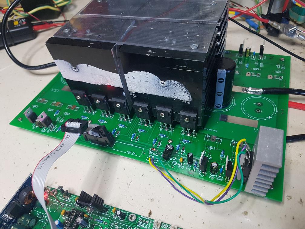

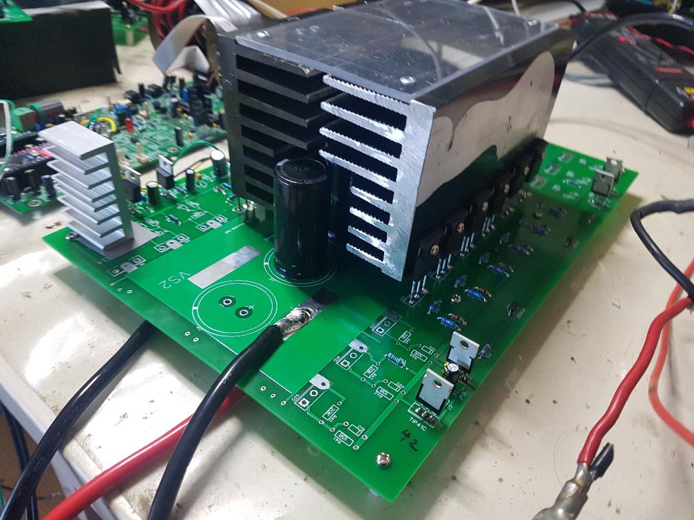

The power board has been tested to start the air compressor.
11kW peak power for 1/4 second.
It passed easily.
3 FETS on the 4 legs of the full bridge.
No RC snubbers fitted yet. (I want to see the difference
they make, if any)
2 x 10,000uF 100V and 2 x 3900uF 80V caps on the DC supply rail.
This is not enough but good enough for me.
Errors fixed on the PCB already so we are ready to go.
I will do further testing then post the PCB files.
And basic build information for the inverter.

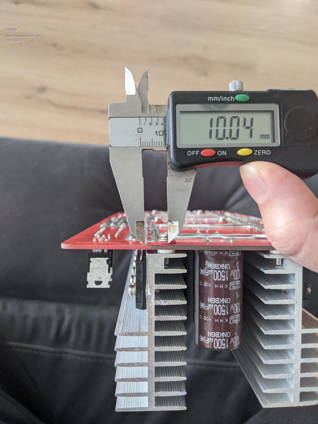

Many people on this forum seem to be copying the power board layout from the Chinese with regard to placing the big capacitors *inside* the heat sink where they get nice and hot and might have a shorter life.
A simple solution is to place them on the underside of the PCB which also has the advantage of more heatsink fin area.
I have long ago adopted the 'power capacitors on the other side' approach for my mosfet power boards. I also make these boards as two identical half bridges which has the advantage of smaller, cheaper boards, getting away with 1oz copper PCB's and a more flexible way of mounting the boards on both ends of the heat sink.

Is there a schematic of Mad's totem pole circuit? I can't seem to find it
poida
Joined: 02/02/2017
Posts: 1507
Posted: 11:11am 19 Apr 2021
here is the one I used for the above power board.
Schematic_powerboard_2021-04-19.pdf
the 10 pin IDE socket connects to the nanoverter.
It's schematic is
nanoverter_D-schematic.pdf
