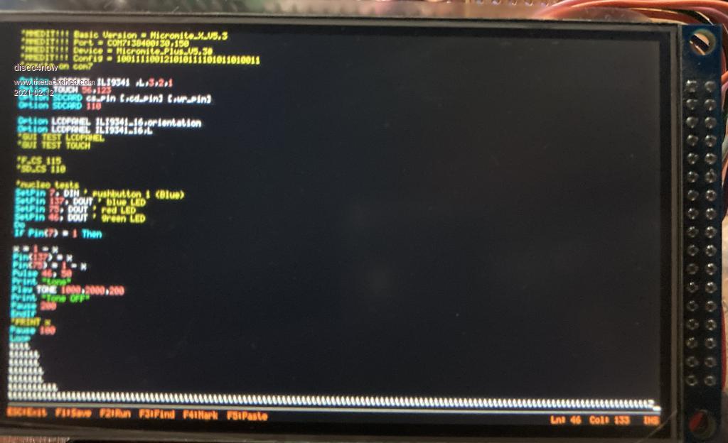

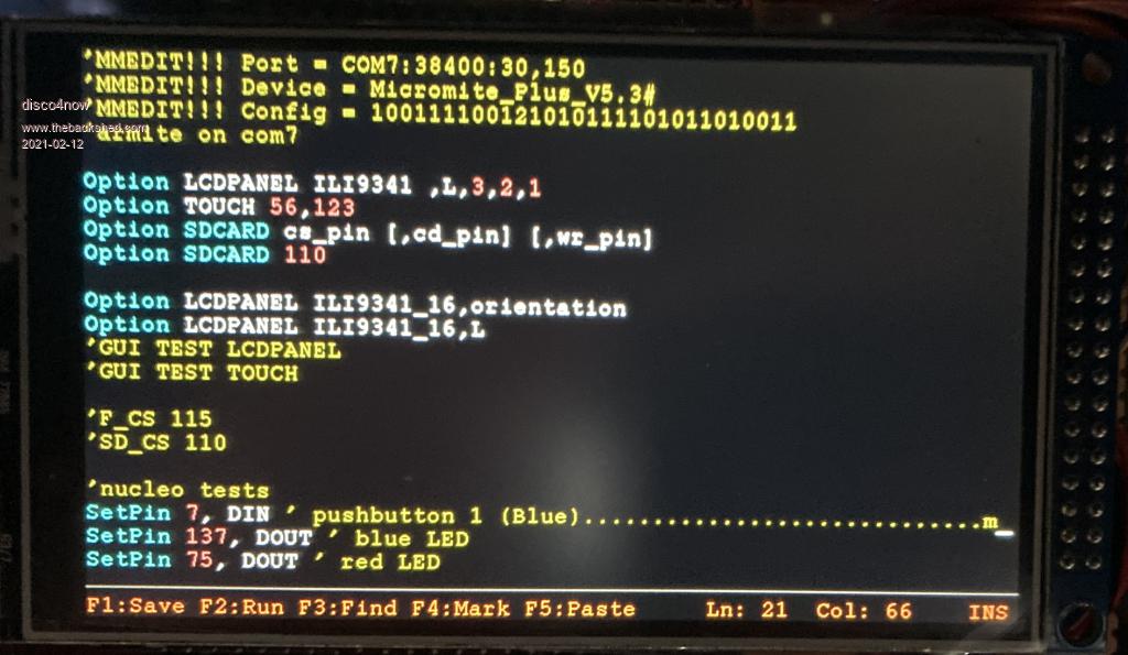

Ok, I have not use OPTION LCDPANEL CONSOLE before but here are some images on the 800*480 OTM8009A I have working. 3.97" is the claimed size.
Using font 2  about 25 lines 66 cols.
Quite usable I think. Issue at present where cursor does'nt down arrow past 3rd last
line.

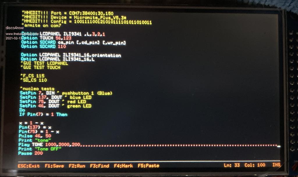

using Font 1 about 37 lines 100 cols
I think you could use this as well I think, though a little small.
Issue at present where cursor does not down arrow past 3rd last
line.
using font 7  48 lines   133 cols
This is pretty small,nearly too small to read, but with a magnifier is still very clear. You probably would not use this. Does allow cursor to last line.
This one is not really blurred, the phone must have moved, but the font is small.

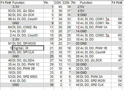

Posted: 02:03pm 15 Feb 2021

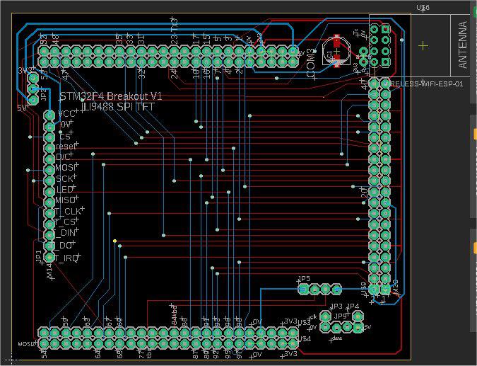

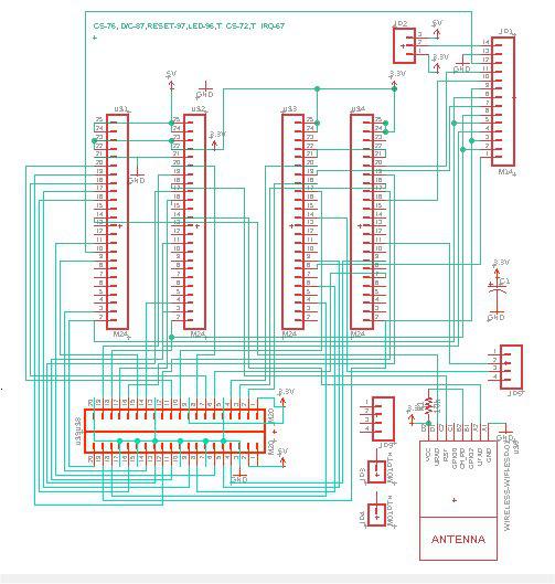

Well, here's my first pass at a PCB for an "Armmite F4 MMBasic computer", with ILI9488 SPI TFT LCD display, ESP-01, keyboard connector, and pi-type 20x2 connector, sent yesterday to JLCPCB (slow boat, since express plus customs handling adds about $30 where I am). I say "first past" because I doubt I got it all right.
The schematic is an embarrassment. I didn't have an F4 footprint, and I've never succeeded in creating a new EagleCad part, so I used 4 24x1 headers. I didn't know the pin designation for the keyboard so I placed a 4-pin header near the footprint with 5V,0V,kbd-data and kbd-clock. I'll solder links when the boards arrive, then fix and resubmit with other corrections. I did use this F4 footprint on a different PCB, so I know it works.
For the LCD control (on SPI2), I used the following pins: CS-33, D/C-87,RESET-97,LED-96,T_CS-51,T_IRQ-67
Here's the 40-pin header layout--orientation as on the CMM2, with pin1 on the lower left.

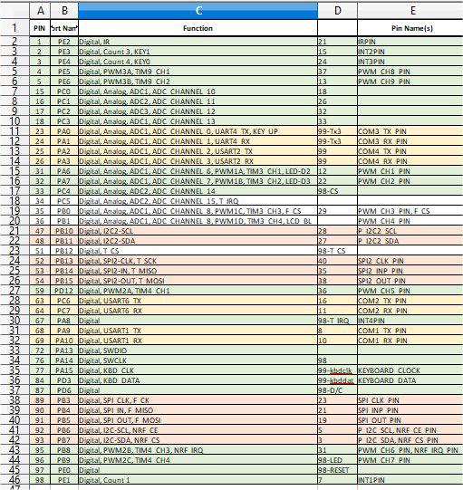

And F4 board pin usage:
One possible issue--SPI MISO (pin 90, PB4) is not among the pins on the F4 24x2x2 headers, so there is no complete SPI(1) port on the 40-pin (20x2) connector.
Regarding layout, I put the SPI LCD header inboard of the 16x2 16-bit LCD header on the F4 board so that the original 320x240 LCD could be used with this breakout board, or others using an adaptor with the 16x2 header.
I hope this will work toward making a relatively inexpensive F4 "MMBasic computer" available.
Posted: 02:19pm 15 Feb 2021
  Quote  One possible issue--SPI MISO (pin 90, PB4) is not among the pins on the F4 24x2x2 headers, so there is no complete SPI(1) port on the 40-pin (20x2) connector.
I could change the pinout to PA6. This would mean losing one channel of PWM1 outputs. e.e. PWM1A, PWM1B, PWM1C but no PWM1D
Thoughts?
Posted: 03:03pm 15 Feb 2021
Can you explain this further? There already is no PWM 1D on the 40-pin connector.
Would then PA6 (pin 31, Digital, Analog, ADC1, ADC_CHANNEL_6, PWM1A, TIM3_CH1, LED-D2) go to pin 21 (MSBasic numbering) which for a pi is SPI(1) MISO)?
Is something to be done with PB1 (pin 36, Digital, Analog, ADC1, ADC_CHANNEL_8, PWM1D, TIM3_CH4, LCD_BL)? (Which I now notice should probably be LCD_BL instead of PB9.)
Does this allow firmware configuration of SPI MISO depending on an LCD option setting?
I'm happy to consider any recommendations/suggestions for a version 2 PCB.
I forgot about breaking out sound (how?), and would probably bring out IR to a separate header, but I've never used it and don't know what considerations to take into account.
Edited 2021-02-16 01:04 by lizby
Posted: 04:10pm 15 Feb 2021
Sorry - looking too quick
PB1 is and will remain the backlight and is not directly available to MMbasic
If I make the change the numbering won't change just PA6 becomes SPI-MISO. This will be fixed.
PWM1 will end up with just 1A and 1B
A SPI TFT always uses the same SPI pins as the touch controller on the TFT header
Posted: 04:57pm 15 Feb 2021
Ok, got it, I think.
1. PB1 will be LCD_BL (instead of the PB9 which I now have).
2. PA6 will become SPI-MISO (and will connect to pin 21 on the 40-pin pi-header).
3. ? PB0 (currently PWM1C) will become PWM1A? Or only PWM1B and PWM1C will be available?
Posted: 05:07pm 15 Feb 2021
PWM1B will become PWM1A, PWM1C will become PWM1B - no other PWM1
The backlight PWM is completely separate and just runs continuously. The only issue with it is whether ON is 3.3V or 0V and different displays need a different answer. I may need to do a firmware tweak for this.
