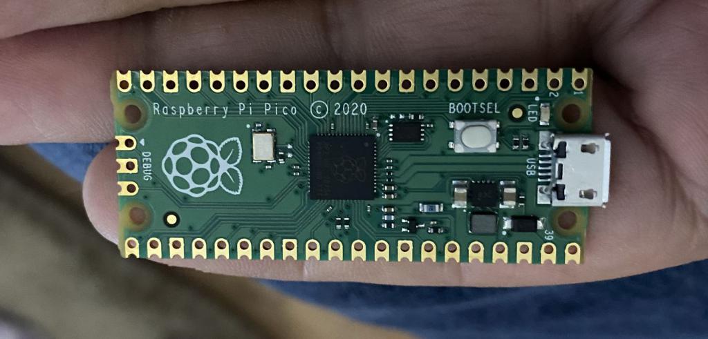

It's also Tiny - this is on my index finger

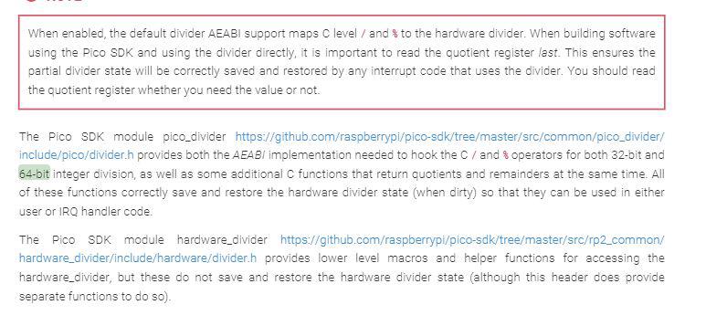

Quote from the pico_c_sdk.pdf datasheet, page 25
The SDK includes optimized 32 and 64 bit division functions accelerated by the RP2040 hardware divider.
There are graphs in the datasheet showing that the 64-bit divides are typically twelve to twenty times faster than can be accomplished by the M0 core alone.
Edited 2021-01-24 00:55 by ceptimus
Posted: 03:16pm 23 Jan 2021
  Quote  There are graphs in the datasheet showing that the 64-bit divides are typically twelve to twenty times faster than can be accomplished by the M0 core alone.
Yes understood - but that is just integer divide - no FPU just some ROM software of unknown provenance
Everyone will make up their own mind but for me this is a poor imitation of the ESP32 and has little of no advantage over a normal ARM processor such as packaged by ST. Why did they not just use the M4 core and then there would be no need for a one-function co-processor?

I don't think it's just ROM software.  It's a piece of hardware that does multiplication and division.
