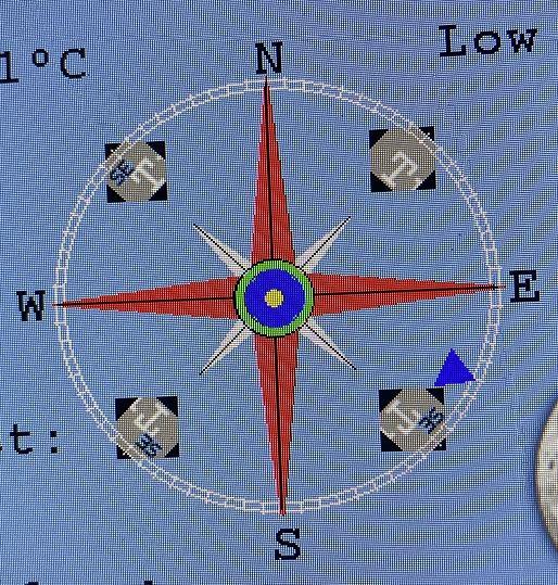

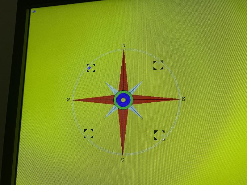

If you see this post, have you any idea why I'm getting the black triangles around the intermediate directions?
I've quite possible made an error when adapting your code.
There's also a "spare" blue rectangle in the top left corner, not sure if that's related to the code or not, it doesn't appear when I run the weather code that doesn't have the image rotate section in it
I made it yellow so it's easier to see the artifacts, and it's an up close shot of the screen
This is the modified section of your code I'm using

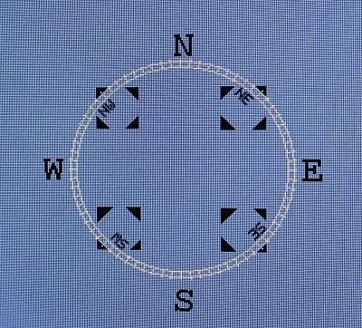

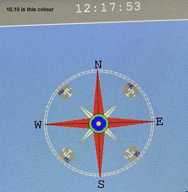

Peter:
Have you any idea why this happens?
The image rotate when it's redrawn always uses the colours located around 10,10
If I use any other location to write the text as in the examples below I get this
As you can see I tried using 540,110 to do the text so it got the background from there but  as you can see it doesn't work
Also the black corners I can't remove
Any suggestions?

This is the result, much better but still the triangle artifacts
Posted: 12:00pm 10 Jan 2021
  Quote  This is the result, much better but still the triangle artifacts
Not for me - did you try my code exactly as posted on the latest version of mmbasic attached below

Sorry I spoke too soon
Once I incorporated it into my code it's still picking up the colour from 10,10
I tried using 540,110 hoping that it would pick up that blue shade but it still uses 10,10 but with no written text nw,ne etc
