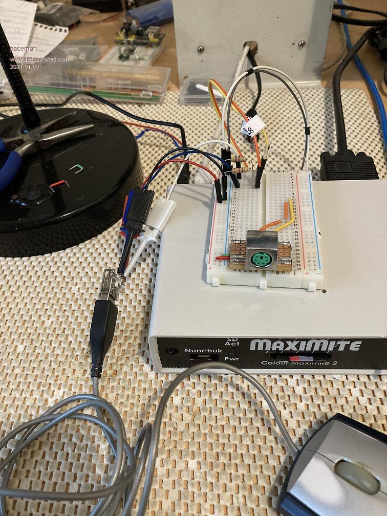

Posted: 01:16pm 03 Jan 2021
Just connected my 10 year old Porto optical USB mouse up as per Jim's diagram (no adapter) and it worked first go - I'm amazed how clever I am!    Peter's test program came up with my mouse as a Type 3, whatever that means, and it's working fine in the file manager and editor.
My only regret is there's not much point now posting a photo of my little PS2 breadboard adapter that took me about a full day to make - it's so neat too.
Thanks Peter and Jim for all this effort.

  paceman said  My only regret is there's not much point now posting a photo of my little PS2 breadboard adapter that took me about a full day to make - it's so neat too.
I'm formally requesting that you post a photo of your PS2 breadboard adapter because of said "neatness". You made it with pride - post a picture to share!

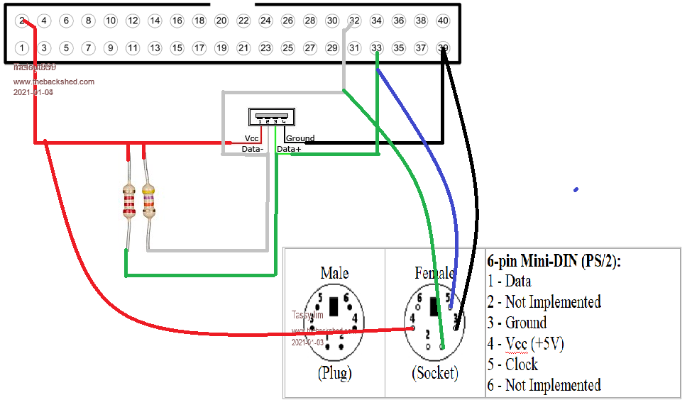

Hi.  I am trying to figure out how to make a cable with both connectors here is what I have so far.  Please advise.
Would this work and be a safe interphase.  I like the idea of being able to directly plug in the USB/PS/2 mice OR the strictly PS/2 mice with one cable.  I would appreciate the verification before I make the thing.  Thanks.
Posted: 07:53pm 03 Jan 2021
  Quote    I am trying to figure out how to make a cable with both connectors here is what I have so far.  Please advise.
Yes that would work. PS/2 is slow so there shouldn't be any issues with reflections from the open unterminated socket.
I had considered doing the same but decided that one socket and an adapter prevents accidentally plugging both in at the same time.
Edited 2021-01-04 05:53 by TassyJim

  Quote  PS/2 is slow so there shouldn't be any issues with reflections from the open unterminated socket.
 Is there anything I can do to fix that issue? I thought about the issue of duel plugins but I think it is worth it to have a universal cable for all my Mice.  Thanks.

  Quote   Is there anything I can do to fix that issue? I thought about the issue of duel plugins but I think it is worth it to have a universal cable for all my Mice.  Thanks.
I said it should NOT be an issue. If you accidentally plug both devices in, it shouldn't damage anything but definitely not work.
It depends if you are going to be swapping mice a lot or, now that I have things working, I am unlikely to do any swapping.

Posted: 01:27am 04 Jan 2021
Jim:
  Quote  I said it should NOT be an issue. If you accidentally plug both devices in, it shouldn't damage anything but definitely not work.
 I went another way and it is much more streamlined so I will stay with this little guy. Works for some of those MS mice but not some of you others.  Not a big deal.
Just a note. If you noticed I mentioned that with your HT emulator the scroll is inverted and now I know the built-in PS/2 is correct. It must be some change that matherp made for this new feature.  No issue though. Thanks.

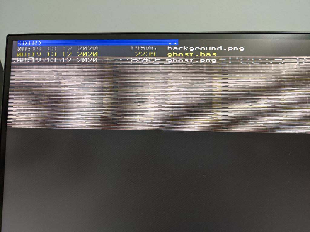

Does anyone else have graphical glitches with new beta firmware, or is it my CMM2 playing tricks on me? I have odd artefacts with graphics demos in Welcome tape, and the main menu does not work - I can't select any menu item as neither cursors or numbers do work. The keyboard works Ok in other cases.
https://youtu.be/YUvrn-p9PO8
Posted: 10:41am 04 Jan 2021
There is a problem that seems to be related specifically to the way the welcome code works. Let me know if you see the same in any simpler program as that would help locate the issue

For the keyboard issue, I have it only with Welcome tape 0.5.1. I'll check some other software later on and report (IIRC, ran some games and they were fine, but let me double check and more thoroughly).
Thanks CG, here it is, along with the USB connections sans adapter. Now to make them neat!

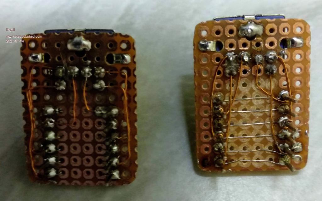

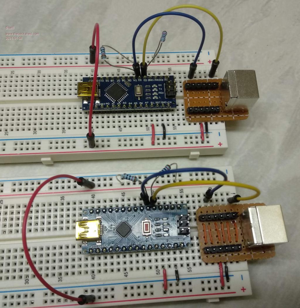

Posts: 4410
Posted: 11:35am 04 Jan 2021
Nice.
I felt much the same pang of regret:
... though looking at the underside magnified to such an extent I'm less pleased with my soldering now.
