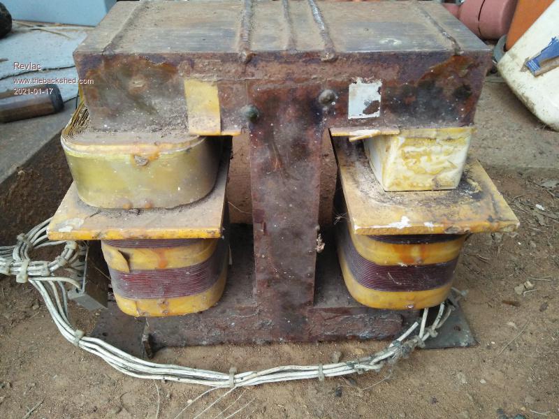

This is one candidate for a 3 phase transformer, its about 40kg as is without the winding on the center leg.
It will need a complete strip down and rewind, will start a new topic and post further details later when I get to this stage.

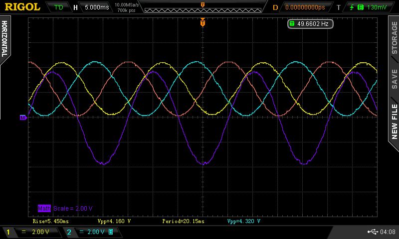

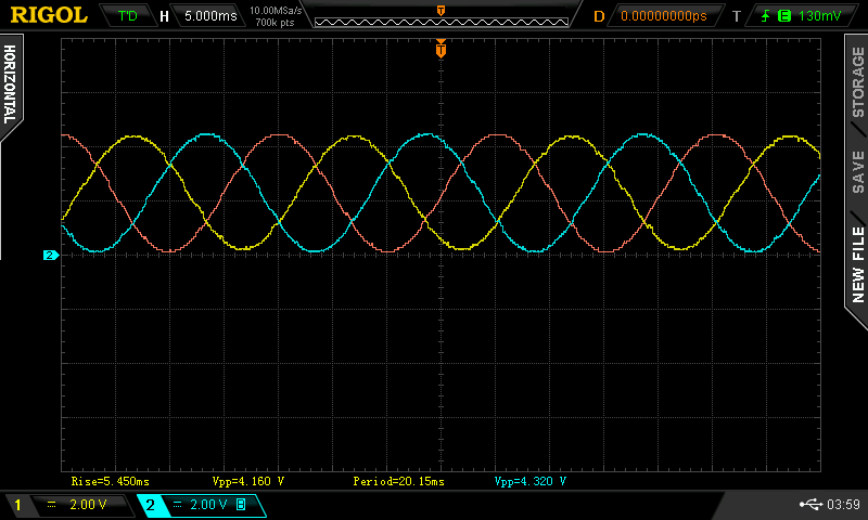

After initial testing of the above code I found a few errors.
I now get this:
the output freq is 49.66 Hz
this is smoothing the PWM to the low pass filtered average value
within the DSO to show the nice sine waves.
I trigger on the midpoint on the rise of the Orange trace
which is coming out of pin D11.
code is this
megaverter_3phase_pwm.zip
this shows Yellow - Blue which is what one of the windings of the 3 phase delta
transformer would see. Notice it's bipolar, goes from -4V to +4V, at 50Hz
This is what we want.
Edited 2021-12-02 08:24 by poida
