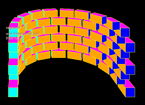

This 3D engine is fun stuff!
Peter gave us a brick wall above. But I wanted a curved wall:
There is an obvious problem in that I have to draw the bricks from farthest to nearest. (Ugghh)
A less obvious problem is in the projection. The blue faces of the bricks on the right side in particular look far too square. Something seems wrong with the projection. Have I set the viewing plane or viewing distance too near or too far?
CurvedBrickWall.zip

Nice curved wall VegiPete. It seems that the Painter's Algorithm is wrong for the right side of the wall.

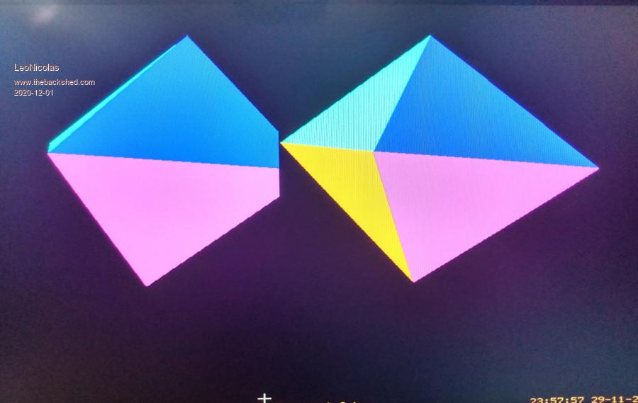

I also sow a rendering problem in the octahedron example.
The right side of the left octahedron is being cut by the right octahedron.

  Quote  I also sow a rendering problem in the octahedron example.
This is because the example code is incorrect and needs fixings for the corrected rendering

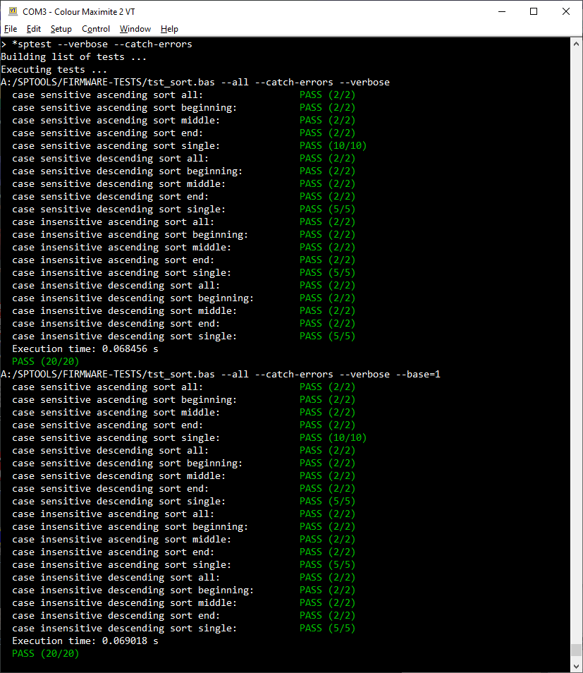

Tom, LOVE that you set up a unit test framework!!  Probably not as useful for visual things (ie how do you automatically test to see if the result of graphical commands are correct?) but still very useful for running through the various other commands and ensuring that they haven’t broken or changed in behavior.  I know the Java developers use a similar huge set of tests as they develop the language to ensure they didn’t break things as they add new capabilities in, and to test that new features are working as intended.
I really need to pull down your tools and have a go with them.. Just need to find some time to devote to CMM2 stuff...

Posts: 4410
Posted: 02:20pm 01 Dec 2020
  mkopack73 said  Tom, LOVE that you set up a unit test framework!!  ...
I really need to pull down your tools and have a go with them ...
Thanks.
My tools are very much under active development at the moment. If you do pull the code then make sure it is from https://github.com/thwill1000/sptools/tree/develop-r1b3 and not the "master" branch which is very out of date. Please also be aware that since it is a single-developer project I am being "naughty" and doing updates with forced pushes to that branch, something I would never do in "master" or shard branches in public projects.
Edited 2020-12-02 00:22 by thwill
