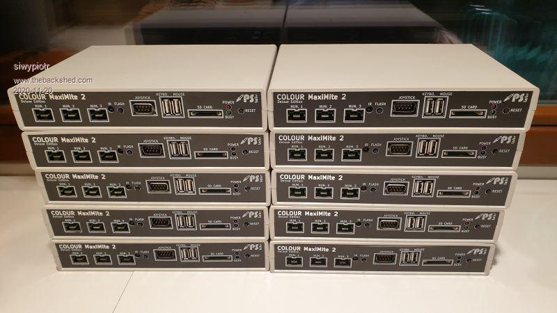

Posted: 08:31am 20 Nov 2020
It is possible that this is the last batch of Maximite that I made.
All of them I will ship with random gifts like (apart of SD card, USB cable, ESP WiFi, Mouse controller):
VGA to HDMI converter
NES controller
Nunchuk controller
VGA cable
https://sklep.pslabs.pl/Colour-Maximite-2-Deluxe-Edition-USB-Host-Contr-WiFi-p150?fbclid=IwAR15PxVSOcWdjtZHok9MINe03HlfI_iPvYUit7yYpl21YGtD8aicQkRIxEU
Since many people asked the question i would like to make small update. It is not that I scrap the project, design is finished and there is nothing that I can change to make it better. The project is and will be supported now and in the future. I need some time to develop other products like expansion system for Maximite and some gadgets for Atari ST.
It is also possible that if I will find some time I will make another batch but to do that I would like to hear from everyone if they are interested.
Edited 2020-11-21 23:35 by siwypiotr

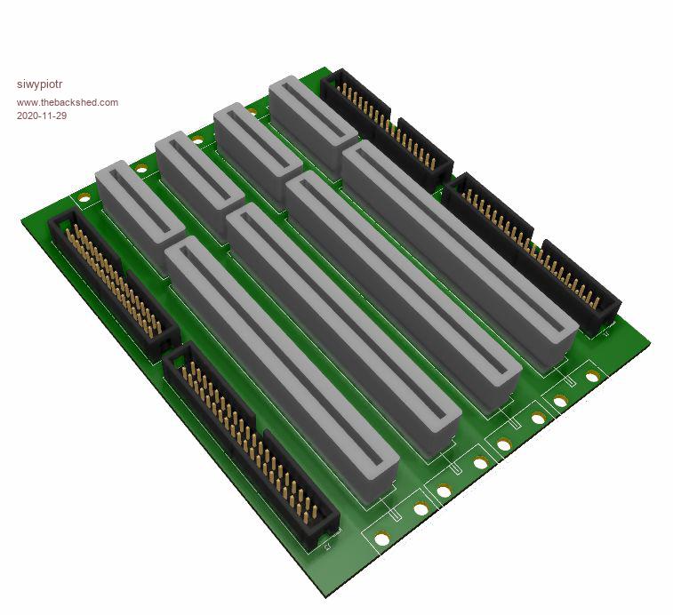

Posted: 02:45pm 28 Nov 2020
Hi
I finally found little time to continue on my expansion system for maximite. I would like to make it in size of standard Maximite 2, so it sits nicely on top of the unit.
I do not own original Maximite 2, could someone please measure original box size?
is it 139,5mm / 110 mm ?
Thank You for help.

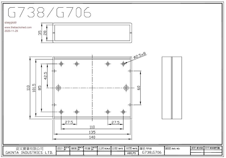

romba6
Joined: 04/07/2020
Posts: 40
Posted: 03:06pm 28 Nov 2020
My top cover is 139mm, this includes the small radius. The 'flat' part is 132mm.
the other dimension is correct.
Edited 2020-11-29 01:07 by romba6
elk1984
Joined: 11/07/2020
Posts: 232
Posted: 03:14pm 28 Nov 2020
  romba6 said  My top cover is 139mm, this includes the small radius. The 'flat' part is 132mm.
Mine is W: 140mm x D: 110mm x H: 35mm
Again mine has a slight curvature on the top / sides.
siwypiotr
Joined: 18/08/2020
Location: Poland
Posts: 127
Posted: 03:22pm 28 Nov 2020
Thank You for help,
Is it possible that cover that producer used is similar to this?
If Yes that would be nice because i want to use (one of the half) as enclosure and it will sit perfect on the top of maximite.
Edited 2020-11-29 01:23 by siwypiotr
