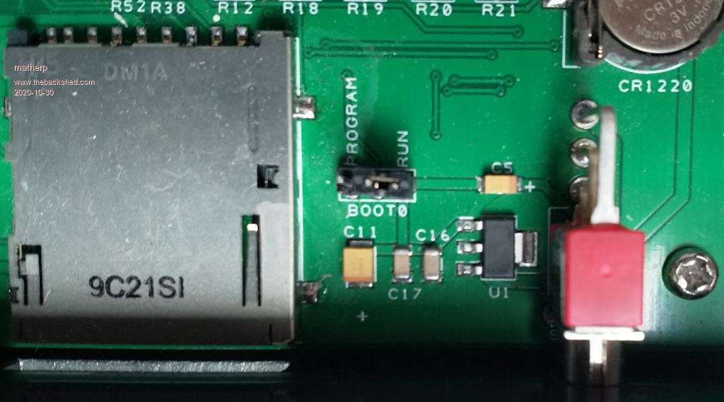

  yock1960 said  Dead bug? You mean lay it down flat?
Yes, thats exactly what I meant.
Googling the numbers:
'106C', this equals a capacitance value of 10 MicroFarad.
The first 2 digits are '10' and the multiplier factor is 1,000,000, so the value is 10,000,000pF or 10uF (10pF x 1,000,000= 10,000,000pF= 10uF).
Remember its a polarised type make sure you connect it the right way round.
No idea what the other numbers meant ... Manufacurers Code ???
I'm sure someone more knowledgeable will chip in soon with a part recommendation.

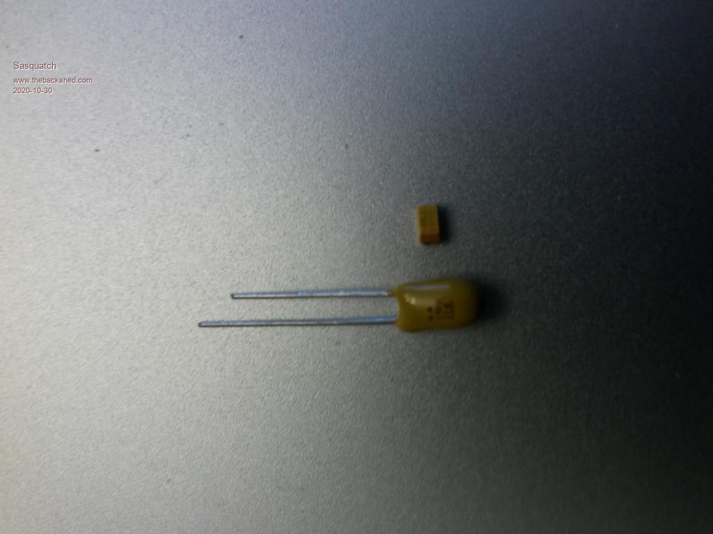

These are suitable replacements.  Sorry about the focus, that's about the best my phone camera can do.  The one with the "through hole" legs may be easier for a beginner to solder to the pads and is also a 16V rated part to avoid this happening again.  If you PM me your address I can put a couple in the mail for you!  As mentioned before, you will need to observe polarity or you will quickly fry the new part.  When in doubt "Google It"  If your power brick has a clean output, you might even get away without C5 for awhile.
Edited 2020-10-30 01:30 by Sasquatch

Please measure the voltages with the USB A-A cable in place.
If you can program the unit OK, the supply must be at least 4V to give enough voltage on the 3.3V side to allow programming to work. The regulator needs ~1.3V drop across it and the CPU probable will get away with 2.7V so 4V in 'should' work.
I don't think that the capacitor is faulty but as it's in the same circuit, measuring the voltages with power supplied via the A socket will confirm.
Faulty power supply, power supply limiting to 100mA, faulty cable, faulty B socket, faulty switch.
Hopefully bad solder joint on one of the above.

With the A-A connection, power switch off, center pin of switch to ground checks 0V. With power on checks 2.3V.
Steve
Posted: 10:43pm 29 Oct 2020
  Quote  With power on checks 2.3V
I find it hard to believe that you are able to program the firmware with voltages that low!
That will put the CPUs supply at 1 volt.
yock1960

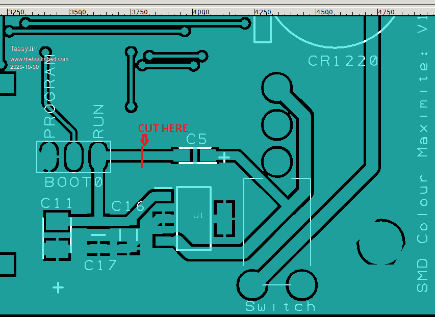

Posted: 01:32am 30 Oct 2020
  yock1960 said
Well, I'm only going by the messages from what the software says, I really have no idea.
Steve
I do believe you, I just am very surprised that the CPU will operate so far below its design minimum.
I am also surprised that your PC didn't complain about the excess current drawn from the USB. They usually have a resettable fuse to limit the drain.
Rather than removing the capacitor, you could cut the trace on it's negative side. That would take it out of service and be easy to re-instate if that's not the problem.
On these boards, the large areas of fill on the top side are 3.3V while the fill areas on the bottom are ground. That means it is difficult to isolate the 3.3V side of the regulator.
If you cut where I have indicated, you can easily scrape off the mask either side of the cut and restore the capacitor with a blob of solder.
I don't have a SMD board so I am only going by the gerber files but I think you should have room to perform the operation.

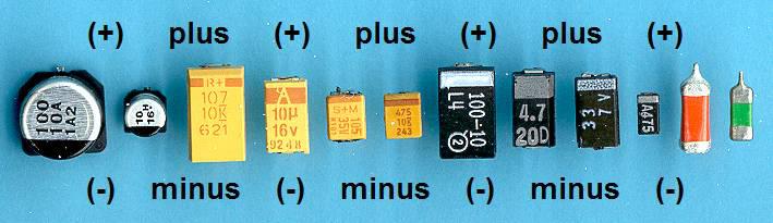

Yes, those little orange-brick type caps are tantalums. Take note that the "Bar" marking on the end of a SMD tantalum, is the NEGATIVE.  Many people(including me!) mistake that as the positive, and as with standard electrolytics, tantalums don't like being installed backwards - they will explode.  Literally.
Yes, it is 10uF, and going by the BOM, it is a 16v type NOT 6v3, so 9v should not really have killed it.  Jim does not think the cap is the problem, and he may well be correct, but that is where I would start, as it is easier to remove/isolate that then the regulator.
Others here have hinted at the idea the regulator could also be cooked now, and that also may be the case, but I would start with the cap.  Jim's idea of cutting the PCB track is a good one, if you don't have any SMD rework station or any experience playing with SMD parts.
If you cut the track and power up and the voltage is still low, then the regulator will also have to be replaced.  Something is not right at the power-input side of things.  The regulator should have no problem at all with 9v input.
Whatever the cause, I will be interested to find out what it is, so please do keep the thread updated.  Good luck.

  Grogster said  Yes, those little orange-brick type caps are tantalums. Take note that the "Bar" marking on the end of a SMD tantalum, is the NEGATIVE.  Many people(including me!) mistake that as the positive, and as with standard electrolytics, tantalums don't like being installed backwards - they will explode.  Literally.
Don't think that is correct Grogs, according to the data sheets on all the solid smd tants that I have, the bar end is anode or +ve.
Its only -ve on non solid electrolytic types.
Well, it took several passes to cut through the trace and after I finally did, I had about 30 seconds of hope, as the busy light went out after powering on...but still no display. Voltage now checks about 1.7V on the center pin.

Posted: 09:52am 30 Oct 2020
  Grogster said  Take note that the "Bar" marking on the end of a SMD tantalum, is the NEGATIVE.
easy tiger!
(from the many bits of paper stuck to my workshop wall... I posted without watermark so you can all take a clean copy and stick it to yours   )
Edited 2020-10-30 19:57 by CaptainBoing
Posted: 10:51am 30 Oct 2020
  Quote  the bar end is anode or +ve.
Definitely!!!
