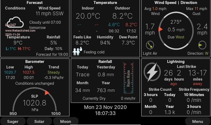

This is the main program
and it's for this
I'm trying to extract some of the values to send to a Micromite to drive a stepper motor based gauge on the wall to display physically some of the elements like outdoor and indoor temp and so on
I added the SI7021.py module myself and the python code to get it working as I don't have a second Weatherflow air sensor to use for the indoor temperatures
