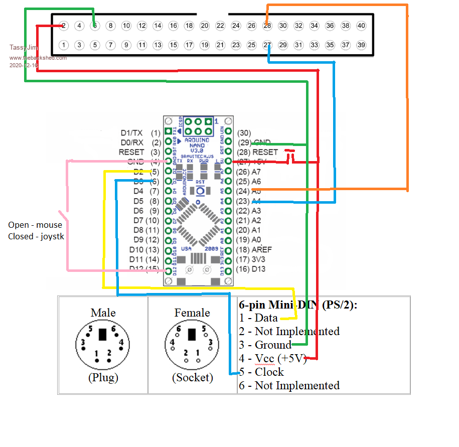

For the mouse this is all the required connections:

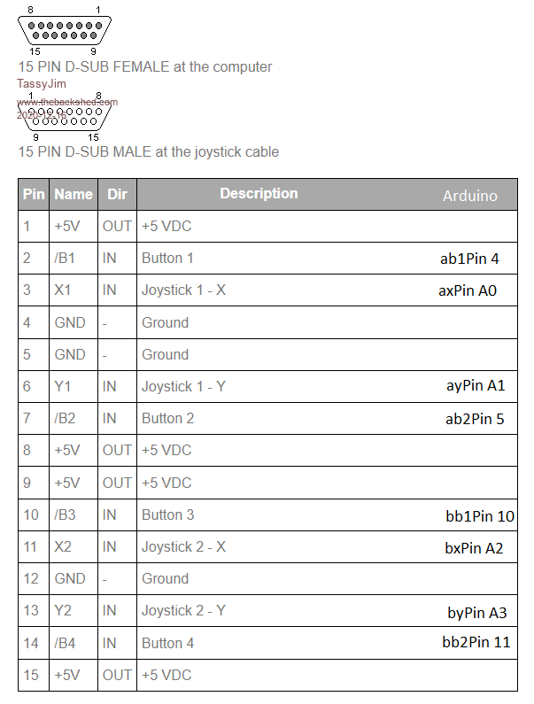

The joystick port is connected using the following table:

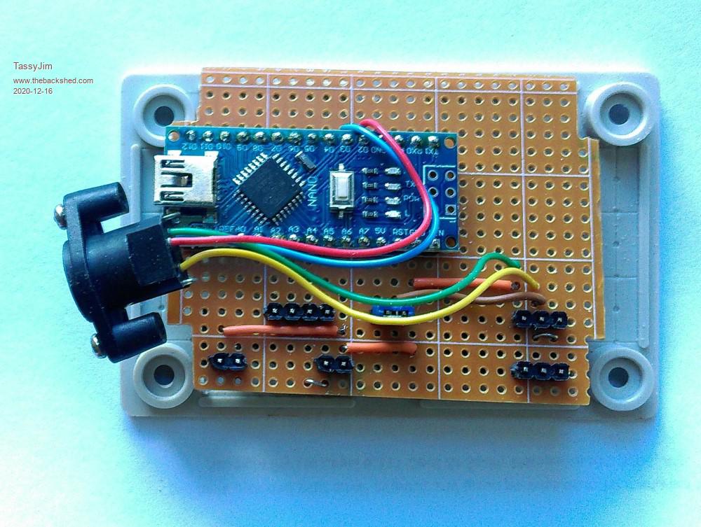

PS/2 mouse only

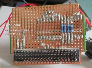

Underside with 10k resistors added.

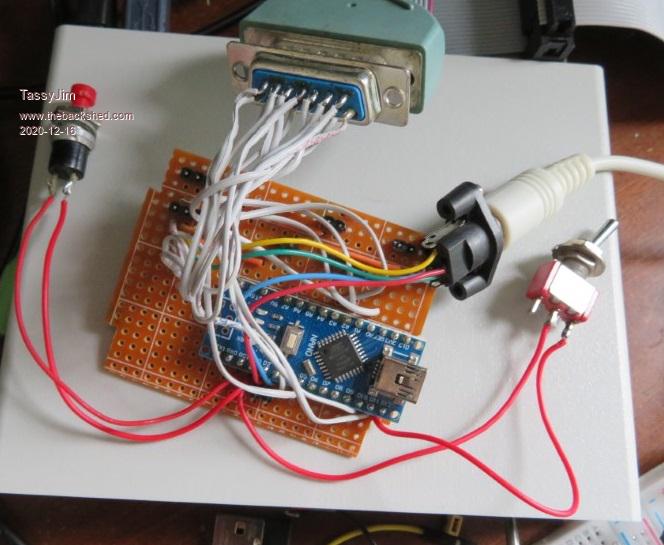

Complete with external reset button, mode switch, joystick port.

Hi Jim.  On the mouse only diagram, what is that symbol on the line from pin 2 on CMM2 going to pin 27 on nano and 5+ on ps2 port? Is that for a momentary switch normally closed? I am going to build this today and want to make sure I got everything right.  Thanks.
Edited 2020-12-17 03:32 by mclout999
Posted: 07:31pm 16 Dec 2020
A reset done via power?
Posted: 07:53pm 16 Dec 2020
  mclout999 said  Hi Jim.  On the mouse only diagram, what is that symbol on the line from pin 2 on CMM2 going to pin 27 on nano and 5+ on ps2 port? Is that for a momentary switch normally closed? I am going to build this today and want to make sure I got everything right.  Thanks.
That is a jumper so you can remove the 5V from the nano when programming it via it's USB cable. If you don't disconnect the micromites 5V, you will have both 5V supplies tied together and that is not a good idea.
You could always unplug the device from the micromite every time you want to reprogram it but having a jumper on the power is much easier. That way you can use the Arduino IDEs serial port monitor to watch what is happening while using the mouse. I certainly needed that while developing the program.

Thanks, Jim.  that makes sense.  I was just going to unplug each time but now I think I will add the jumper.  I am having trouble getting the fine soldering on the salvaged PS/2 port I ripped off an old PC motherboard. I hope to get it going soon.  I also took most of the day trying to get my PC to see the com port and it turned out I had way too many USB devices and Hubs plugged in and it just did not have enough system resources to add the USB serial port.  That was a first and I didn't know that was a thing. I will drop a line if I get it to work.  OH, where is that mouse testing program you had in early versions of the zip?  I looked back to all the downloads I made of it and this one is the most recent one.  Will it work with this?

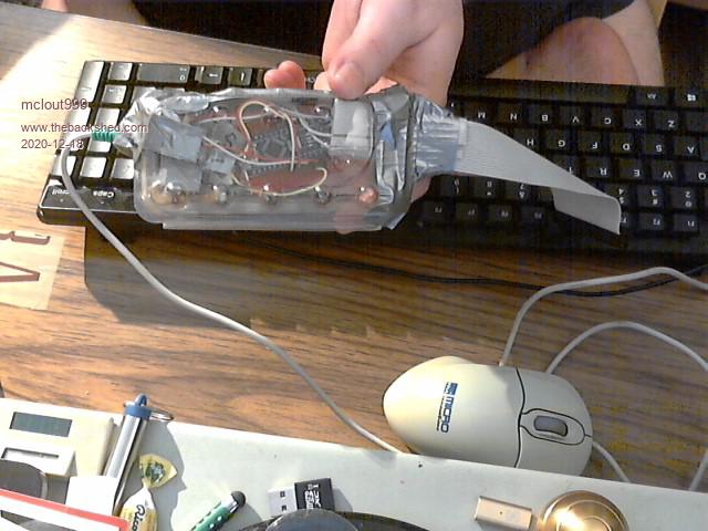

Well, I finally made my mouse interphase.  This is my FrankinMouse setup until I get the parts to make a tidy one.
The scroll wheel is not working from your second test program.  Not sure if that is an issue with the mouse.  I get all three buttons and a smooth mouse movement. Thank Jim for a wonderful option and I love that it is open source and so affordable. because I had all the parts but the NANO it all cost me $1.30 shipped.  That is very cool and I also did my first Arduino project and got some soldering practice.

  mclout999 said  Well, I finally made my mouse interphase.  This is my FrankinMouse setup until I get the parts to make a tidy one.
Good to see it up and running!
I did the second program with the cube before the scroll wheel code was fixed by Peter so that is why it doesn't do anything.
I might change so the wheel does the zoom in and out instead of left clicking.

Jim, I tried to test BigMic's fix for controlling the mouse resolution(in your last test code)
  Quote  I2CX WRITE 41, 1, 2, 28, 10
but it seems to have no effect. I had to add PAUSE 200 after that line or the mouse was not detected. Not a big deal but that was nice to be able to control that on the HT version.
  Quote  https://www.thebackshed.com/forum/ViewTopic.php?FID=16&TID=12884&LastEntry=Y#161150#160828
