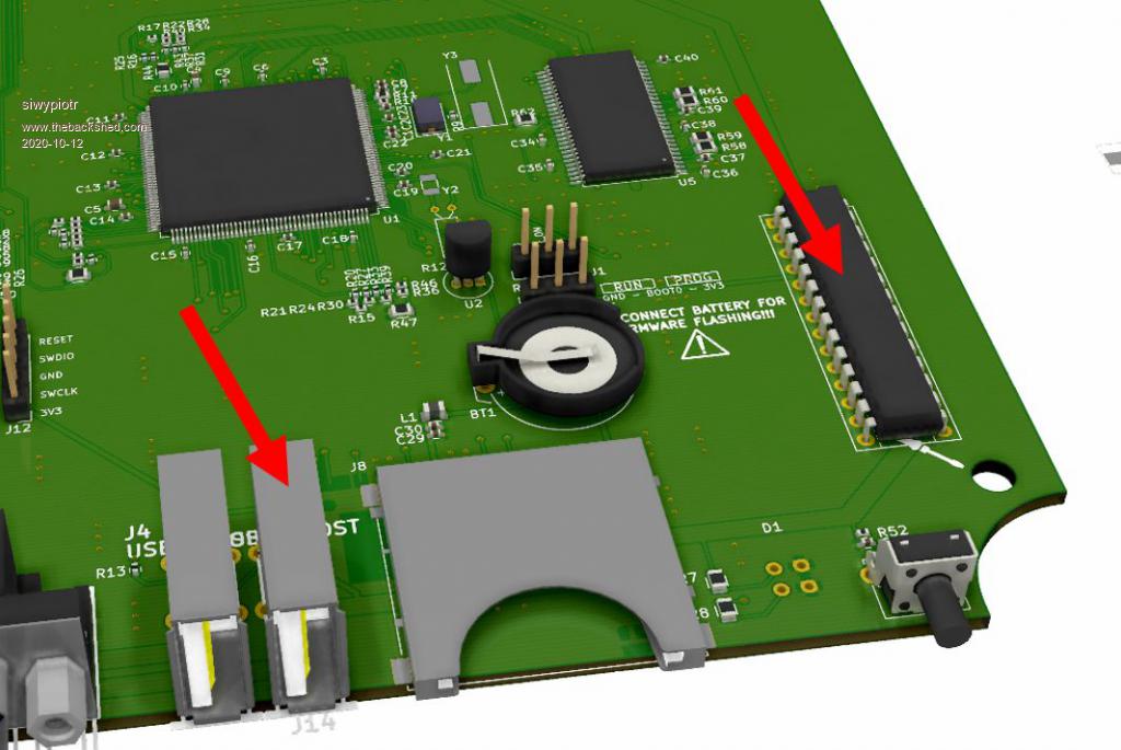

siwypiotr
Joined: 18/08/2020
Location: Poland
Posts: 127
Posted: 07:14am 12 Oct 2020
Dear Maximite users and creators. I have described my version of Maximite on this forum:
https://www.thebackshed.com/forum/ViewTopic.php?PID=156733#156733
I noticed that many people are asking about the mouse support. Since Im working on next model I can implement it.  I can do it by adding additional STM or similar microcontroller with USB support and send data to main processor using i2c or other protocol.
But I do not want to create additional standard, creators of the firmware have to agree how it should be done and I will follow their guidelines.
If anyone has ideas how it should be done I will be happy to hear it.
Posted: 07:43am 12 Oct 2020
  Quote  But I do not want to create additional standard, creators of the firmware have to agree how it should be done and I will follow their guidelines.
I intend to support the Hobbytronic  I2C mouse protocol (very simple) on any of the CMM2
I2C channels. Any device that can fully mimic that protocol (commands and responses) on the same I2C address should then work
siwypiotr
Joined: 18/08/2020
Location: Poland
Posts: 127
Posted: 09:37am 12 Oct 2020
OK, I will add PIC24FJXXGB002. My design has 3 port for Wii Nunchuck so either I will remove one or add jumper for user to decide if he wants 3 controllers and no mouse or 2 with mouse.
Posted: 10:00am 12 Oct 2020
If you go with the PIC24FJXXGB002 you have to buy the chip pre-programmed by Hobbytronic. It has a custom bootloader to provide security.
siwypiotr
Joined: 18/08/2020
Location: Poland
Posts: 127
Posted: 10:13am 12 Oct 2020
  matherp said  If you go with the PIC24FJXXGB002 you have to buy the chip pre-programmed by Hobbytronic. It has a custom bootloader to provide security.
I have seen HEX file on his web page, can not I used a JTAG and flash the micro with it?
Posted: 10:18am 12 Oct 2020
No, the bootstrap has all the entry points and in any case they deserve income from their efforts
siwypiotr
Joined: 18/08/2020
Location: Poland
Posts: 127
Posted: 10:36am 12 Oct 2020
I changed my mind, there will be stm32l4 series or something cheaper. There is also option that I leave a place for soldering the Hobby chip by the user.
Edited 2020-10-12 20:42 by siwypiotr
siwypiotr
Joined: 18/08/2020
Location: Poland
Posts: 127
Posted: 12:40pm 12 Oct 2020
I added mouse port, on PCB there will be DIP socket. Anyone who needs a mouse can buy the DIP-28 chip from Hoppy Electronic and install it.
3d i2c is used (PB7 - SDA3, PH11 - SCL3)
Posted: 12:49pm 12 Oct 2020
You need to add the supporting circuitry - xtal etc
