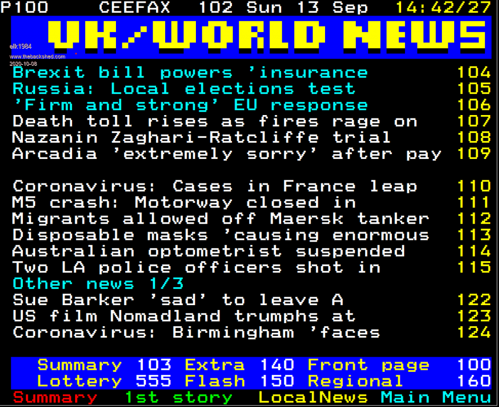

  thwill said  In addition to BBS support what might be nice to see is a Viewdata/Videotex implementation like the ZX Spectrum Next cloud have with NXTel. It must be possible.
So many ideas, too little time,
One of my three projects in flight at the moment.  I've recreated the Mode 7 font complete with graphics, and I know the format used by by wxTed (for Teefax).  I'm in the process of writing a page creation programme and a viewer - although hooking it into a real BBS server is beyond me, I was going to use it standalone with an IR remote as a "kiosk".
Screenshot is from wxTed, I'll try and post at least a static from my program later this week.
