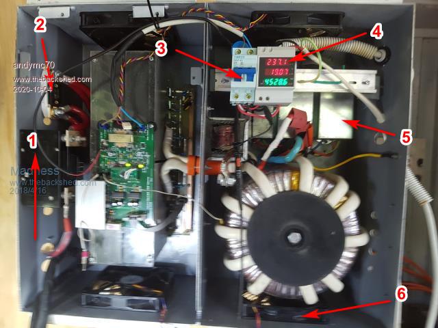

So i have found the following internal pictures just wondering a few components.

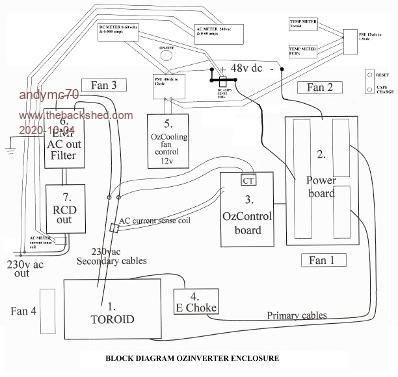

Also i have add an image that i can not read correctly when enlarged to see the overall system. I am trying to get a better understanding of how its all put together.
1. I do know what it is?
2. I think is a current shunt.
3. I think this is circuit breaker, what size do people recommend. Also do you just run cable straight to the electrical panel.[I mean you get an electrician to do all this].
4. I do know what it is?
5. I do know what it is?
6. Fan what size do you recommend, is bigger better. I was looking at 140mm 12v.

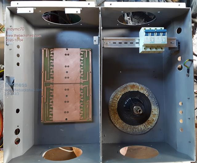

Also what/how have you setup the front panels of the inverters. If you have picture  that would be great.
Here is the schematic that i can not read when i enlarge it.
Also i am wondering how you remove the old toriod holder shown here on the left hand side.
Andy
Posted: 11:16am 05 Oct 2020
1 is a switch
2 is a fuse
3 is a 63A AC circuit breaker
That is my original build, 1 and 2 have since been replaced with a 80A DC breaker. 80A Does seem on the light side but it has never tripped with normal and heavy use. The reason for using 80A is it will trip faster if you have a major failure. I had quite few of those in the early days and with a 200A fuse the circuit board was always badly damaged if things went wrong. With a 80A breaker MOSFETs can fail and trip the breaker before tracks get blown off the PCB. As mentioned above that was in the early days before using Totem Pole drivers. My Inverter has now run for over 3 years without a hiccup using EG8010 chip.
I use 140MM fans they can run up to 100% especially when back charging at 100A for a few hours. I would not use anything smaller. Most of the time the fans are not running and natural convection is sufficient even here in Qld.
The AC output from the Inverter in mine goes through the 63A breaker to a 63A Breaker/Change over switch in the AC switch board. I have done this to allow having a second inverter wired up ready to be turned on. The change over will only allow one Inverter to be connected.
The Toroid holder in the photo above is not in it's original position, I ground off the original and welded in a new bolt where I needed it. There is about 5MM clearance between the Toroid and the fan.

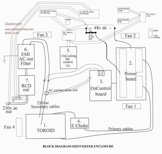

Try this .....
or this .....
BlkEnclosure1.pdf

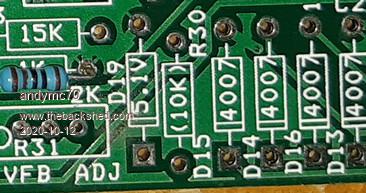

I have a couple of questions for the nanoboard.
R30 Bom says 6.8k 1/4w, where as PCB is 10k shown in pic.
Also R21 is 470 on BOM and 1k on PCB.
Also i am wondering which is positive the square or circle for the diodes and caps.
Andy

  andymc70 said  hello
Andy
D5, D14 etc. pictured there has the band marked on the silkscreen and so just line up the diodes to match the band.
The line is negative for the caps. Just check a couple and see if the pin next to the line marking is connected to ground. Nearly all caps are negative to ground. The two charge pump caps C1 and C7 are not connected to ground via either pin.
R21 is just setting the current for the over current trigger LED
so anything that lights the LED with a 5V supply will do.
470R and 5V will be 10.6 mA and a good match for most LEDs

I used 3 x 1N4007 diodes in series to give me the 12V (or near enough) in place of a
12V regulator. These 3 voltages are not super critical.
(and your DVM might be a bit out too...who knows)

  poida said  I used 3 x 1N4007 diodes in series to give me the 12V (or near enough) in place of a
I am assuming your using the diodes to drop the voltage, so around 1 volt each diode. If this is correct, just wondering why a voltage divider is not used? Also what is a DVM?
Andy
