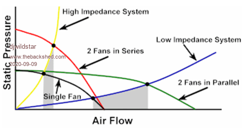

@vegipete - Air intake filters and positive case pressure are great at keeping dust and lint (and cat hair) out of the inside of the case.  If you're going to use air filters, positive pressure is the way to go -- it is otherwise impossible to put filters over all of the possible air-entry-points in the case.
If you want to set up the fans in a series configuration (one blowing in and one blowing out), I'd suggest moving one of them.  It wouldn't be hard to place them on opposite sides of the back panel and arrange a baffle that directs incoming cool air over the CMM2 and ensures that outgoing air is drawn over the amplifier.
I went with a parallel configuration because that provides for a nearly-linear relationship between the impedance of the case and the overall airflow (the green line between the yellow and blue lines in the attached chart).  It also made it easier to direct where the cool air went, since I could drill intake holes in the bottom directly underneath the CMM2 and amplifier rather than having to set up baffles inside the case.

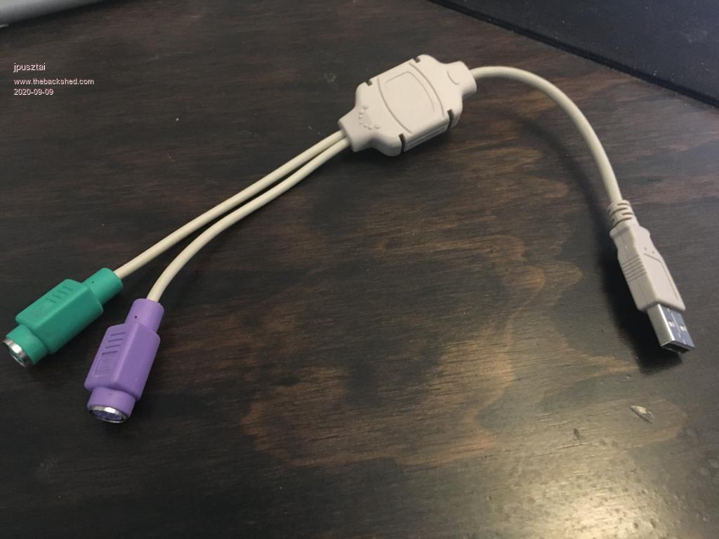

Will PS/2 to USB work in the CMM2?

I can only give you the "Works On My Machine (TM)" guarantee, but yes.
Unfortunately, it has no identification on it, but FWIW, mine looks like this:
A lot of the adapters are simple converters with no logic in them.
IF your keyboard is designed for both USB and PS2 and you have the correct adapter, Yes.
Most keyboards are NOT designed for both USB and PS2.
If you want to use a standard PS2 keyboard on the CMM2, you will need an 'intelligent' converter.
