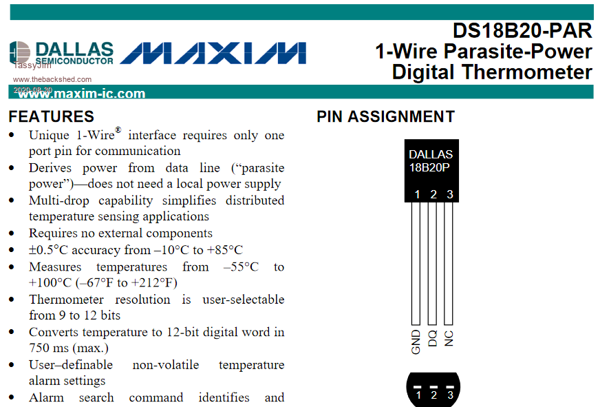

Posted: 05:36am 30 Aug 2020
I still think your sensors are in parasitic mode.
Are they encased or can you see the designation on the sensor?
https://datasheets.maximintegrated.com/en/ds/DS18B20-PAR.pdf
Unfortunately, they use the same family code as the 'normal' ones so can't use software to see.
But they DO work OK so not a big deal.

OK, The "P's" have it!!!!!!!!!!!!!!!!!!!!!!!!
Checked out about a dozen of them. All P's
Trap for the ignorant...
Just tried on the CMM2 before reading your last message with the same results. (obviously)
May order some real ones to see how they go.
Thanks Jim. I hope it wasn't too much of a time wasting exercise for you.
Maybe need a note in the various manuals.
Brian
ChopperP
Posted: 06:43am 30 Aug 2020
You can still have a string of them.
You could write a 'start' routine to start all at once then come back later to read the results, just like the inbuilt TEMPR function.
Parasitic power is OK but not for really high temperatures or long runs.
Just don't mix them with normal ones. It would make like too difficult.

You learn something every day, however I'm now slightly confused.  Why do they make a special parasitic powered version when the "normal" version can work in both three wire and parasitic modes anyway?
Chopperp
Joined: 03/01/2018
Posts: 1139
Posted: 08:06am 30 Aug 2020
Good question Geoff.
Looking up RS now.
Have in their blurb for a normal unit DS18B20+ :-
"They feature a 1-Wire communication interface and powered from that data line".
May have to give them a call check if they are the real deal or not.

More playing 1-wire trying to get the grips with it.
For the Parasitic Mode (Power = 0) I added  SELECT CASE to set Tconv according to the Bit value (precision) in the ow_Tempr() function.
The timing values are the same as the manual which are on the conservative side of the specifications.

ChopperP
Posted: 09:34pm 01 Sep 2020
That works if you know that your attached devices are DS18B20s
Other variants have different timing choices and there are plenty of devices sold as DS18B20 that have questionable timing.
(I got into trouble calling them fakes)
I did think about fine tuning the timing but decided it was safer to stick with "slow and steady wins the race"
For your situation, changing the timing is worthwhile.
Chopperp
Joined: 03/01/2018
Posts: 1139
Posted: 10:47pm 01 Sep 2020
Yes, the mod is specific to my needs & they did work with shorter times.
I was wondering why all readings were taking the same length of time.
Using onewire with multiple devices means you have to get the codes & find out which one is which is obviously done individually but you need track of them. Also, if a sensor is replaced, it's code is needed & software updated accordingly.
One thing I found out yesterday when playing & reading the data sheets & the manual etc was about the strong pull-up that is used in the parasitic mode.
I was always under the impression that you really needed an external deice to do that. (not that I did).
It dawned on me that the data input gets changed to an output & set high for the period required. It even says this for flag 8 in Appendix C.
More playing.
Thanks.
Brian
