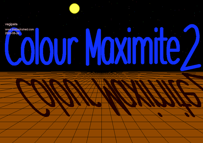

Here is a bit of fooling around with colourful text and simulated 3-D.
CMM2-Intro.zip
Maybe useful?
I don't know if sound would work well with this - there might be too much of a performance hit.
Enjoy!

Yup, that's kinda funny. MOD file playback stumbles noticeably as the sun moves. And don't take the SD card out while its playing!
WAV and MP3 files are no better. Too bad.  :-(

Thanks Pete,
It's much better than what we've got so I'll pull it into v0.2 even if it it ultimately proves to be another placeholder.
Edited 2020-08-24 20:06 by thwill
