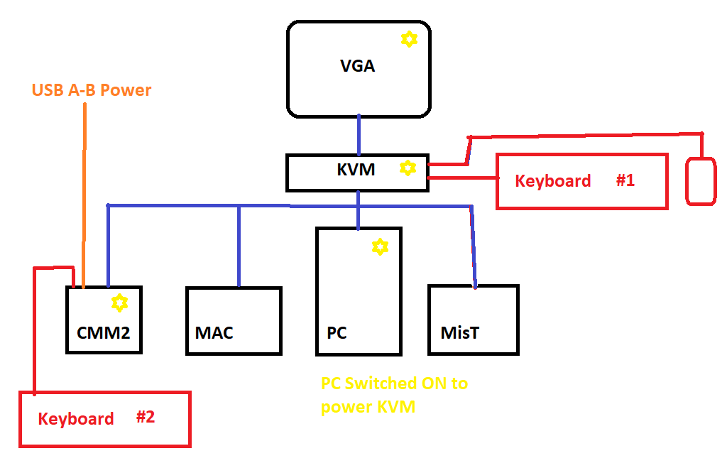

What KVM switch, it would be useful if you could link a picture or to the specs of the switch you are using.
Personally I would use the KVM to simply switch the video only (for the CMM2) and use an additional keyboard.  Source a small keyboard for the CMM2 if you are short of desk space.
Something like this:

Ah, I can see why now.  It must be taking its power from whichever device its acting as the console for, and the CMM2 does not supply any power to it.
Not surprised it will not work as a keyboard for the CMM2, it has a usb hub built in to run a scanner/printer/etc.
You cannot connect a keyboard with a hub to the CMM2.
Shame that, it would have been a tidy solution.  My only suggestion would be a mechanical kvm switch.  This one from amazon might do the job if you have some spare vga cables to hook it up.  Experimentation would be required as I have not tested this personally.
You might be better served with a cheap 4:3 lcd monitor as that is the native aspect ratio for the CMM2 anyway and most modern montors are widescreen.  I picked up a brand new in box 19" Iiyama for £20 on ebay for use with my CMM2.  Could be cheaper in the long run.

  capsikin said  So you can't leave the KVM USB cable that goes with the CMM2's VGA cable unplugged, but you could plug it into something other than the CMM2. The Mac or one of the other computers perhaps, or maybe (if it works) a USB power supply.
Thats pretty much what I was suggesting in yellow on my diagram.  Apparently that solution does not work.
I'm not sure if we're talking about the same thing. So 2 of the USB cables from the KVM switch are plugged into the PC right? The one with the PC's VGA connection and the one with the CMM2's VGA connection? That's not obvious from the diagram.
Womble
Joined: 09/07/2020
Posts: 267
Posted: 12:39am 17 Aug 2020
  capsikin said  I'm not sure if we're talking about the same thing. So 2 of the USB cables from the KVM switch are plugged into the PC right? The one with the PC's VGA connection and the one with the CMM2's VGA connection? That's not obvious from the diagram.
Ah, no that was not what I meant.  But its a good idea.
One for Hendricus to try ...
EDIT: although that would leave the PC keyboard still "live"
Edited 2020-08-17 10:41 by Womble

Thank you capsikin.
Using the Mac mini to serve as USB power source for the KVM channel for the CMM2 works! Just plug in the Lenovo keyboard directly into the CMM2 and then switch the KVM back to the CMM2 for the VGA signal to pass through works well.
With this setup I can get started. I am a happy man

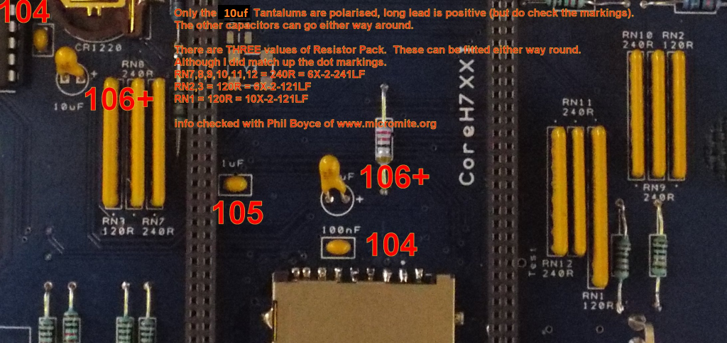

  xmarkf said  I have assembled the Silicon Chip Mag board.
It does have one thing that has me concerned. The tantalum caps have been substituted for a non polarised type
Naturally being in the UK I have the
Maximite 2 Kit v3.0 PCB from micromite.org (Phil Boyce/WW in the UK)
https://micromite.org/shop/maximites/colour-maximite/colour-maximite-2-kit/
This is the v3.0 PCB with the resistors replaced by Resistor Packs
I also have a v2.1 PCB which I picked up as a spare.  I believe this is the version that comes with the Silicon Chip Kit (from looking at the magazine photos).
The capacitor markings on the silkscreen are the same.
Only the 10uf Tantalums are polarised, long lead is positive (but do check the markings).
The other capacitors can go either way around, I believe they are MLCC types.
Capacitor Markings:
10uF = 106+ (polarised Tantalum)
100nF = 104 (can go either way round)
1uF = 105 (can go either way round)
