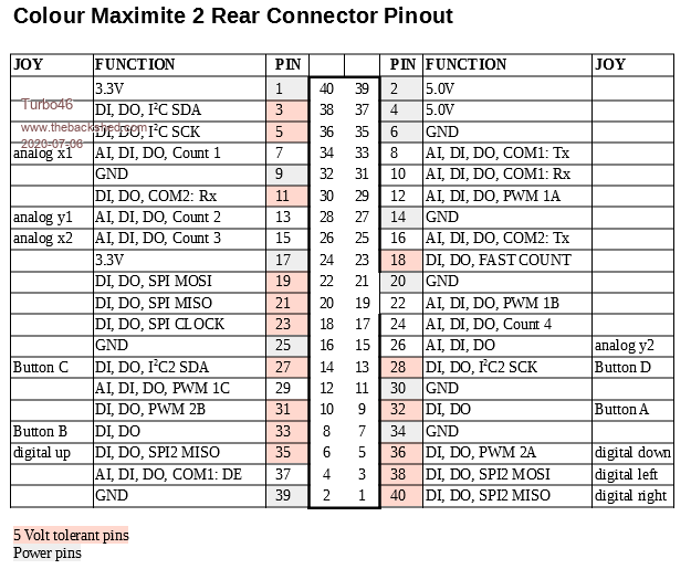

Could I please make another suggestion for joystick pin allocation?
If I am correct, it is unlikely that analogue and digital joysticks will be used in the same game? so how about using the analogue pins for one or the other to suit joystick being used:
analog x1 / digital up - pin 7
analog y1 / digital down - pin 13
analog x2 / digital left - pin 15
analog y2 / digital right - pin 26
Button A - pin 32
Button B - pin 33
Button C - pin 27
Button D - pin 28
That means that joystick with a pot(paddle?) is not catered for but it should leave enough pins for a second joystick if the need arises but that may interfere with COMs functions.

This shows the pins chosen by VegePete along with the normal functions.

I reread things and thought about it more - both I2C and the joystick buttons use pull high, active low signal, and so the signals shouldn't harm each other. Maybe you already thought of that when you designed it.

As I said before, it's a pity that the original reason for this post was not achieved. I would like to build an I/O interface box in a case the same as the CMM1 and 2 to provide communications ports and an Atari joystick connector among other things.
A standard pin allocation for joysticks would allow that. There is no point doing that if everyone is going to go their own way as they did for the original Maximites. I don't want to remove the lid to move jumpers around.
I would love to have a 'standard' joystick pin allocation included in the manual as threatened above. Probably the suggestions above could be refined a little because:
1. It is unlikely that a nunchuk and a joystick will be used at the same time.
2. It is also unlikely that an analogue joystick and a digital one will be used at the same time.
3. It would be best to avoid communications ports because that has been a sticking point in the past.
4. Probably only need to consider one joystick because I suspect that the vast majority of games will be single player.
I also like Tom's idea of a 'controls.inc' file that games programmers could use in their games to provide a standard allocation of controls functions.
