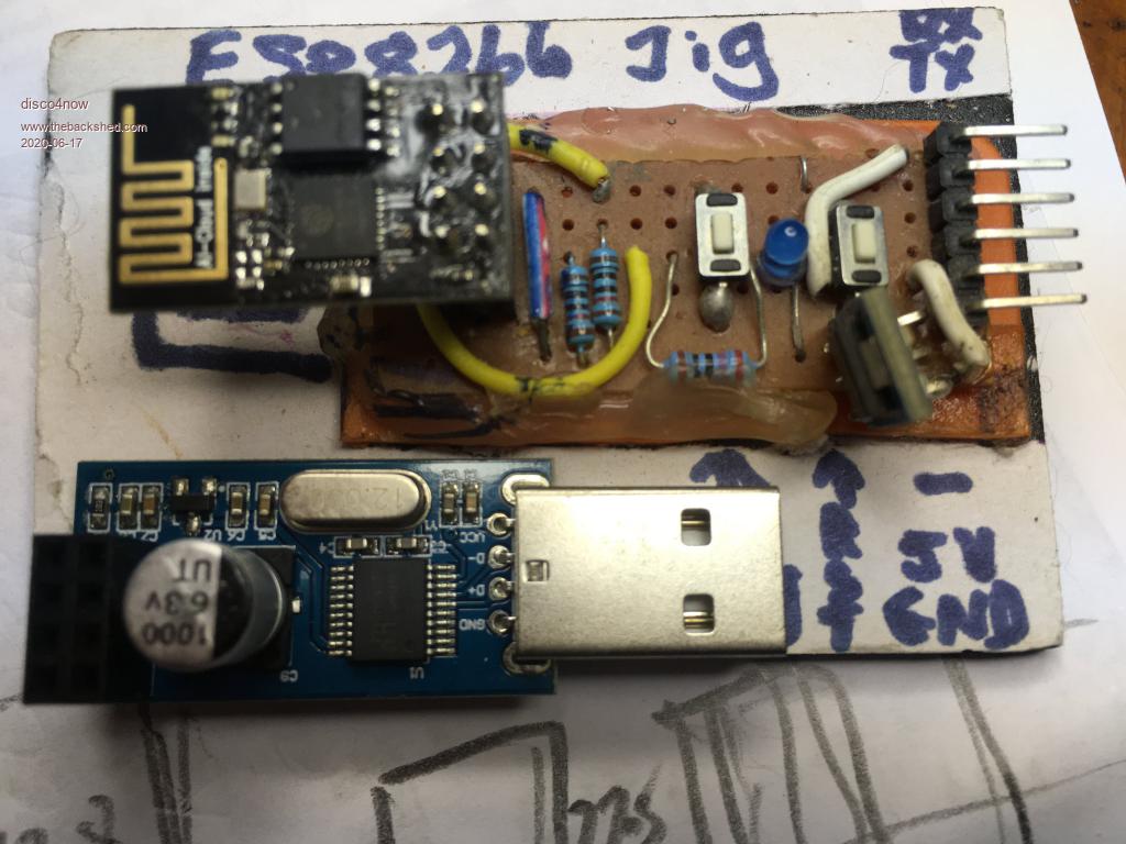

I use this circuit
from here. You connect to it with a USB to serial adaptor.
Hold the flash button down and reset to get it in programming mode from memory.
Using 5V to power the ESP-01 could damage it beyond repair. My USB adaptor had 5v out so I put a 3.3v regulator on the adaptor board.
Also one from Banggood that has USB inbuilt. You need to add the buttons to it I think.
Edited 2020-06-17 21:12 by disco4now

I use a breadboard version of disco4now's circuit (but without the regulator--I power it from 3V3 off of an 18650 battery). I would not be certain that 5V off of a USB/Serial module would always be beefy enough (but if it works, it's "good to go".)
I also use the adapter with mods shown here
It allows you to flash the Annex firmware to the ESP-01 without the RST and FLASH buttons.

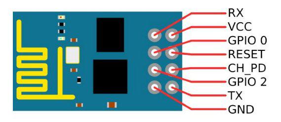

Here's a pinout image that I keep handy:

I checked my USB to serial converter. Although it says it was the 3.3V version, the V+ was at 5V. Sig lines at 3.3V. Definitely use a regulator
Good pinout image.
