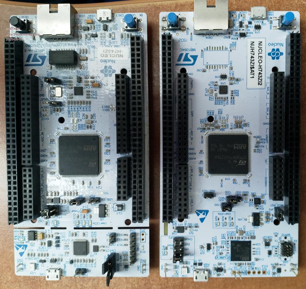

I've flashed my Nucleo-H743ZI (MB1137 Rev B) with it, and the flash reads back OK (so long as I don't let MMBasic run, as it looks then to overwrite part of the flash).
I've got a USB-serial device (set to 3.3V) connected to Gnd, PD8 & PD9 for the console and at 38400 baud I see the MMBasic start-up messages (V 05.04.18 etc) and the ">" prompt.
I can't input anything, nothing even echoes.
If I press RESET I get the start-up messages each time, as expected.
The USB-serial device works fine (checked by connecting its Tx to Rx & with other boards).
The Nucleo board seems OK generally (ran its test program OK before I flashed it, and its STLINK enumerates apparently OK).
Is there some magic I need to do that I've overlooked?  Maybe with jumpers?
I'm powering the board via CN1 (STLINK end of board) before powering up the USB-serial (in case it can leak power).
I expected this to be the easy bit!
Thought I'd next check the strrev in the thread works OK and go from there...

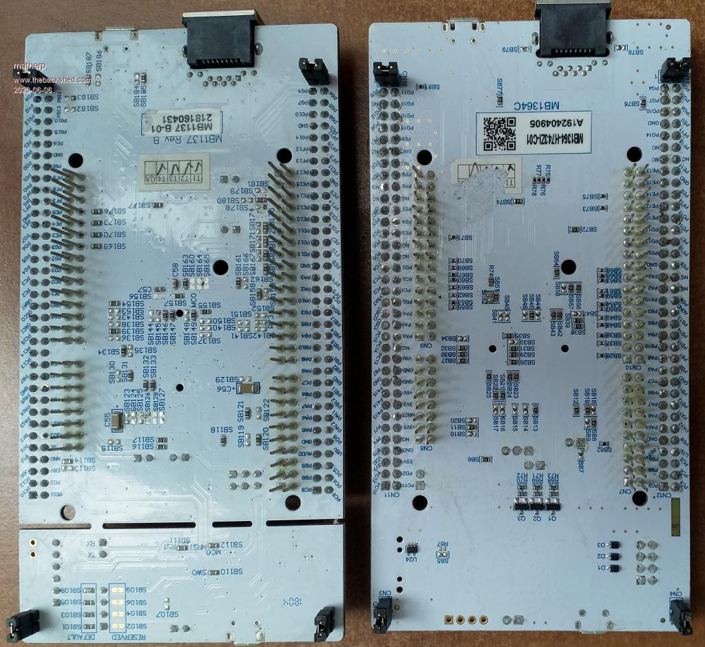

Posted: 03:03pm 05 Jun 2020
Not sure which version you mean but pics of my board attached,
 both tested with RC18, both work, both verify properly if H/W reset selected in STM32CubeProgrammer. After programming disconnect ST-LINK and press RESET.
You should be using the ST-LINK VCP as the console unless you disconnect it it will conflict with direct connection to the pins

Posted: 03:40pm 05 Jun 2020
Looks like the left one - with PCB marked MB1137 Rev B.
But for the console I've connected direct to the pins :(
Will now investigate VCP (never heard of it!).
edit: aha - got it! Can use /dev/ttyACM0
