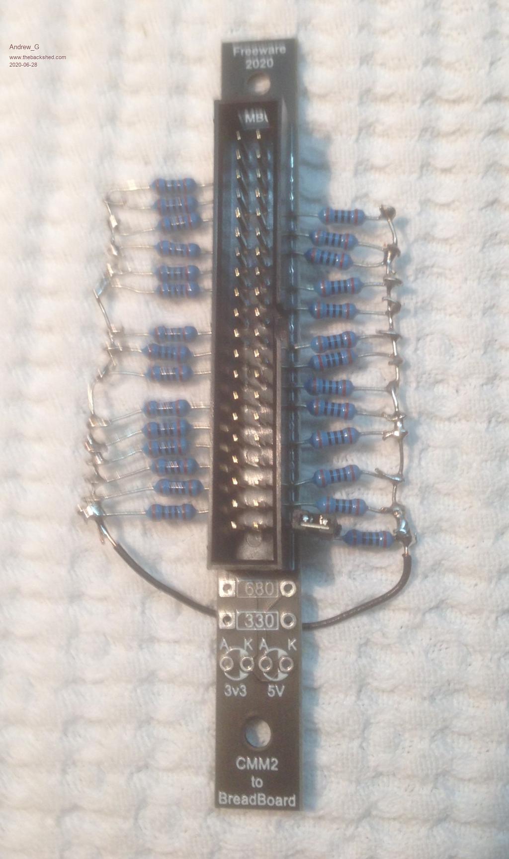

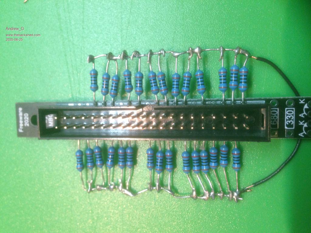

I've just finished building my CMM2 and HAD to test it with Jim's Pin Tester.
I had ordered 200 Ohm resistors and they turned up at the same time as BigMiks
CMM2 to Breadboard adapter (minus the header pins).
My CMM2 passed Jim's test. I'll use it now to test all the IDC cables I make.
(I know its not pretty - but it works).

  Andrew_G said  I've just finished building my CMM2 and HAD to test it with Jim's Pin Tester.
If you have this plugged in when the CMM2 cold boots, does it reset OPTIONS?

Sorry to cut across the current thoughts but I wanted to answer CG:
  Quote  If you have this plugged in when the CMM2 cold boots, does it reset OPTIONS?
Cold boot - Yes the options are reset! - 1) is that what you expected? - why?
AND without it plugged in, if you set options, plug it in and then run Jim's test, any options are still there.
BUT with it still plugged in (with or without running Jim's test), if you set options, they are NOT set, AND all options are reset.
2) is that what you expected? - why?
Cheers,
Andrew
Posted: 06:26am 27 Jun 2020
The pull-up used during boot to initiate a reset is not strong enough to handle the load my tester puts on it.
When the pin tester is plugged, it keeps pin 40 low during the boot sequence.
When you change some options such as keyboard, the system does a reboot and if my tester is plugged in, you loose all settings.
If that's a problem, you could put a switch on pin 40 and only close it during testing.

It SHOULD have a switch.
It is always good practice to plug things in while shut down and that is something I should have allowed for.
I will modify mine cos I did get caught by the resetting today.

Here is lousy picture of my mod to the resister ladder posted above to include a jumper to pin #40 (much easier if I'd done that before soldering all of the resistors).
Now all I have to do is to leave the jumper off, or the whole thing not connected, before booting the CMM2.
