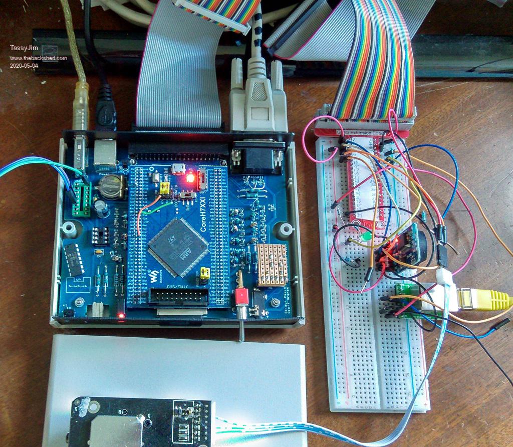

Posted: 10:16pm 03 May 2020
  JohnS said  Nice!
What's it like running Life?
I get about 10% faster than the H7.
It would depend on a few settings. Turning off Serial console etc will speed things up a bit and I haven't tried the different video modes to see what difference that makes.
I have been very impressed with the fast 'feel' of the CMM2 when using it to develop programs. Even SDcard access seems fast when loading images etc.
It took a while to get used to disk based but once I got my head around that way of thinking (just like big PCs), programming came easier.
If you use a RPi breakout board, make sure it is used the correct way around.
I had to re-terminate the cable on mine to get the orientation correct.
There is enough IO to keep most users happy.
