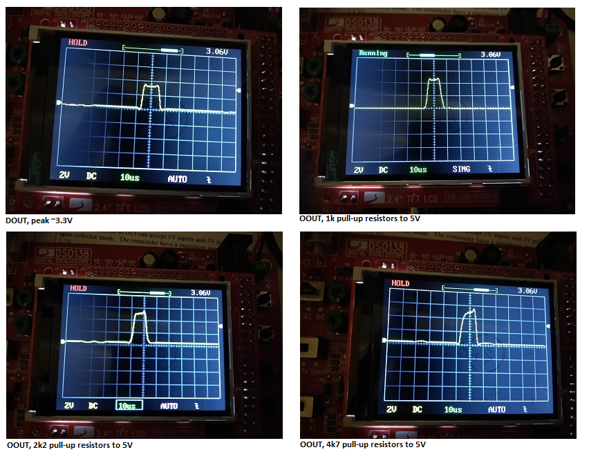

  Turbo46 said  ... and you don't have your LED matrix connected as well ...
I don't. That's the next step.
  Turbo46 said  ... the difference between it working and not working COULD be the impedance when the output signals are driven high. The clock and latch pulses may not be getting through properly due to long leads and capacitance. It seems that the "A" button is always correct because it does not rely on a clock pulse to be read.
I would try lengthening the clock and latch pulses and/or lowering the pullup resistor values to (say) 1K.
- Using 1K pull-ups worked.
- Using 2.2K pull-ups didn't work.
- Lengthening the CLOCK and LATCH pulses seemed to have no effect.

Increasing the pulse length doesn't seem to have any effect, and
looking at the datasheet for a CD4021B (assuming I read it correctly)
the minimum clock pulse width at 5V is 180 ns, comfortably less
than the 12 us I am using.
Incidentally my DSO shows that the pulse width for:
Pin(CLOCK) = 1 : Pin(CLOCK) = 0
Is ~60 us on my Colour Maximite. This is however presumably
hardware dependent which might be a good reason to consider using
Pulse instead since that should presumably have hardware independent
behaviour.
In the absence of a better explanation I'm wondering whether the
problem is the pulse shape (presumably the gradient of the rising
edge). As the shots I've grabbed below (apologies for the quality
I only have a rudimentary DSO) the pulse definition becomes worse
as the resistor value increases. That said the difference in
gradient doesn't look significantly different and even at 4k7 the
clock rise time still looks less than the 15 us the datasheet
specifies ... again assuming I'm looking at the correct thing.

It seems clear that it is not the pulse length that is the problem. I think you are right and the problem is the rise time of the pulse although all examples of your traces look well withing the 15us rise time and the required logic levels.
You don't say where your traces are taken from? They may not be much different at the Maximite end but could be different at the CD4021 end after the capacitance of the cable and that of the input gate has it's effect on the edge of the pulse.
I would be checking the cable resistance from the Maximite to the CD4021 including the connector and checking that there is no difference between the 0v at the Maximite and the controller. Or I might just say blow it, 1K works so I'll use 470R just to be sure and leave it at that.

I haven't had the opportunity to poke the signals further. The traces I photographed were measured at the "4021" end ... though the scopes ground was attached near the power supply - would that matter of all the grounds were connected? The scope only has a single probe so I can't measure the clock pulse near the Maximite and near the "4021" simultaneously. I note that in the CMOS Cookbook it says "The rise and fall times on the clock input of clocked blocks must be faster than 5 us. Otherwise, erratic operation caused by clock skew can result." I'm not entirely certain how to interpret that, but the rise time is certainly in the 5 us ballpark.

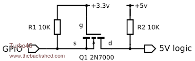

I have used those once or twice, and they work great for 3v3 pins.
Matherp's OC output on 5v pins is fine for 5v pins, but if you don't have any 5v rated pins left and still need to interface bidirectionally between 3v3 and 5v, these little things are just the ticket, and cheap at about $1 each little 4-channel board.

I looked at them when Bill suggested them but they were out of stock and still are. They may be available elsewhere but I didn't look.
The trouble with Banggood is their stuff takes sooo looong to arrive. I'd like to known what the chip is too.

Those level converters use a simple FET in a clever configuration. I will now try to remember the circuit.
Peter
edit. So I googled FET level converter and circuits popped up.

Ah, thanks Peter.
I Googled 'FET level shifter' and there are lots of them like this.
