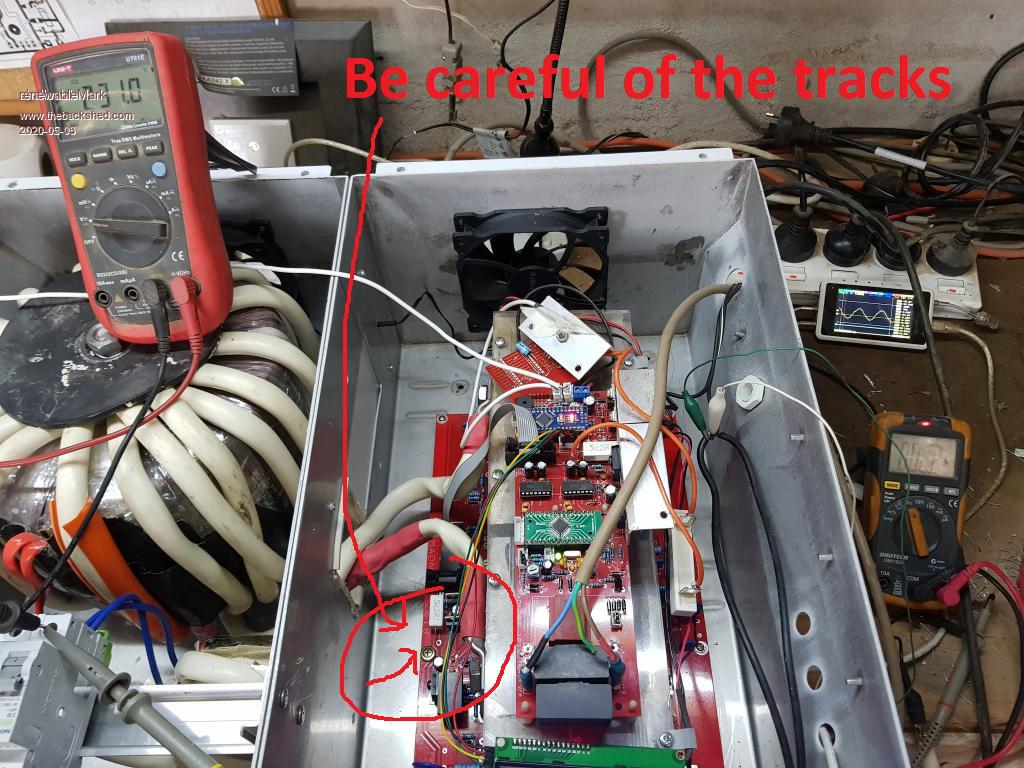

Try this type of transformer if you don't like the one you're using, that type is very touchy with the adjustment.
I think There are a few nib spares in my shed if you want one quicker than china post.
Also I can't see great detail from the pic, but just be careful of the tracks and your mounting screws.

Mark is quite right about those screw heads being very close to the pcb tracks.
Check out flea-bay, you can buy 3mm nylon screws, 3mm nuts, washers, and plastic spacers.  It removes any doubts about something on the pcb shorting down to ground.
