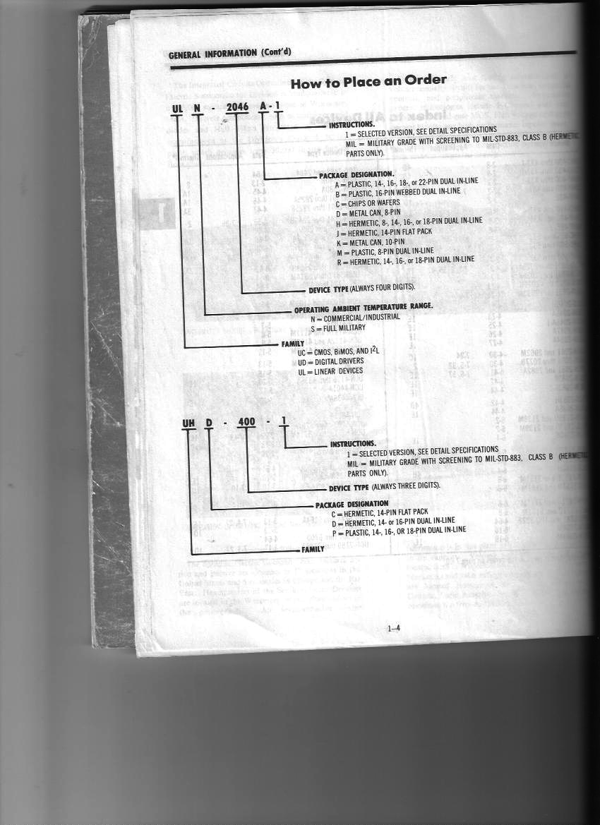

Posted: 08:33pm 09 Feb 2020
  thwill said
Can I ask are UDN2981, UDN2981A and UDN981AT the same thing for my purposes? Likewise ULN2801 and ULN2801A?
Yup, for our purposes all the same.
The UD pullup source drivers are classed as digital (on/off) devices which is fair enough.
The UL pull down devices are just a big darlington transistor which could(?) conceivably also be used in linear analog mode, but also works just fine when switched on and off digitally.
Edited 2020-02-10 06:34 by Warpspeed

Posted: 08:40pm 09 Feb 2020
  Warpspeed said
Great, and thanks for the extra effort to post the image.
