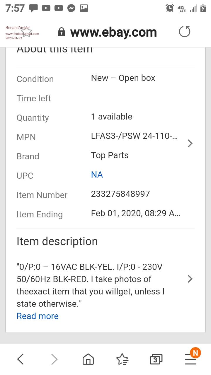

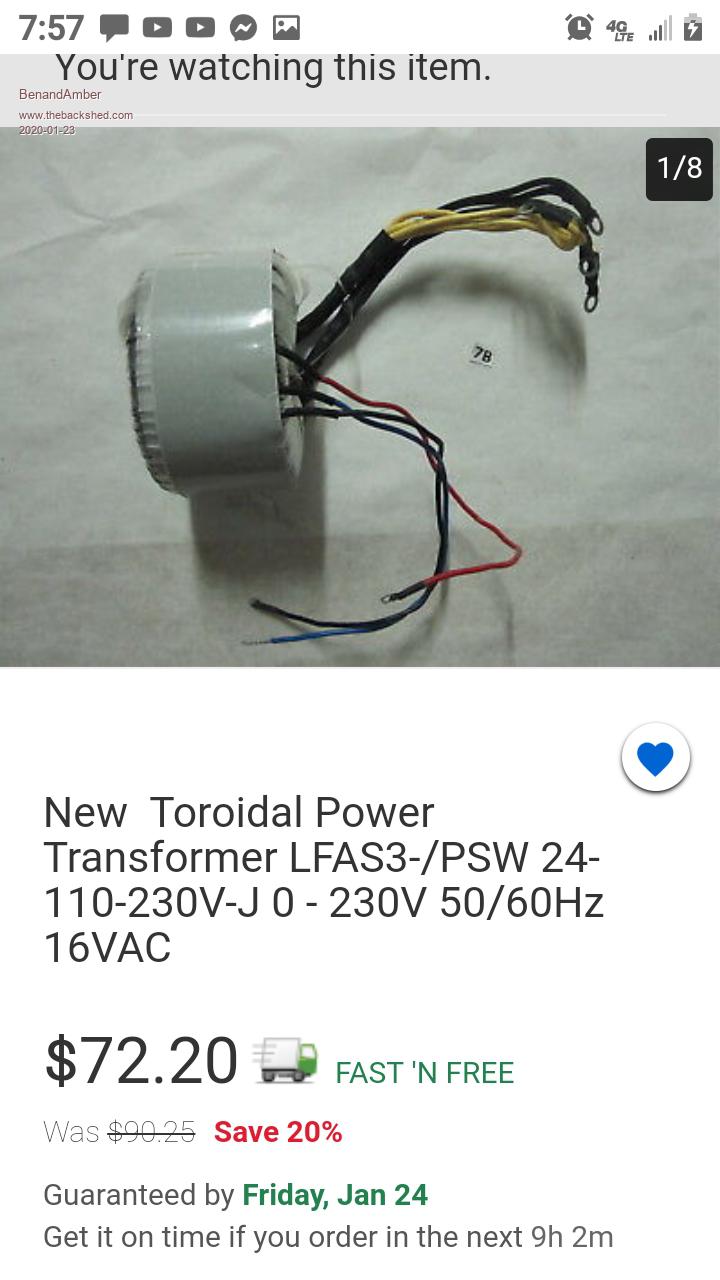

BenandAmber
Joined: 16/02/2019
Posts: 961
Posted: 12:57am 23 Jan 2020
I keep an eye on eBay for Transformers
I seen this one down to $55 last time they List It
If you offered them 55 bucks I'm pretty sure they'll take it
I'm still not sure where you live so may be helpful maybe not

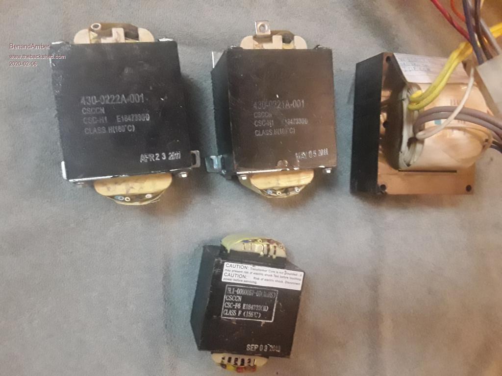

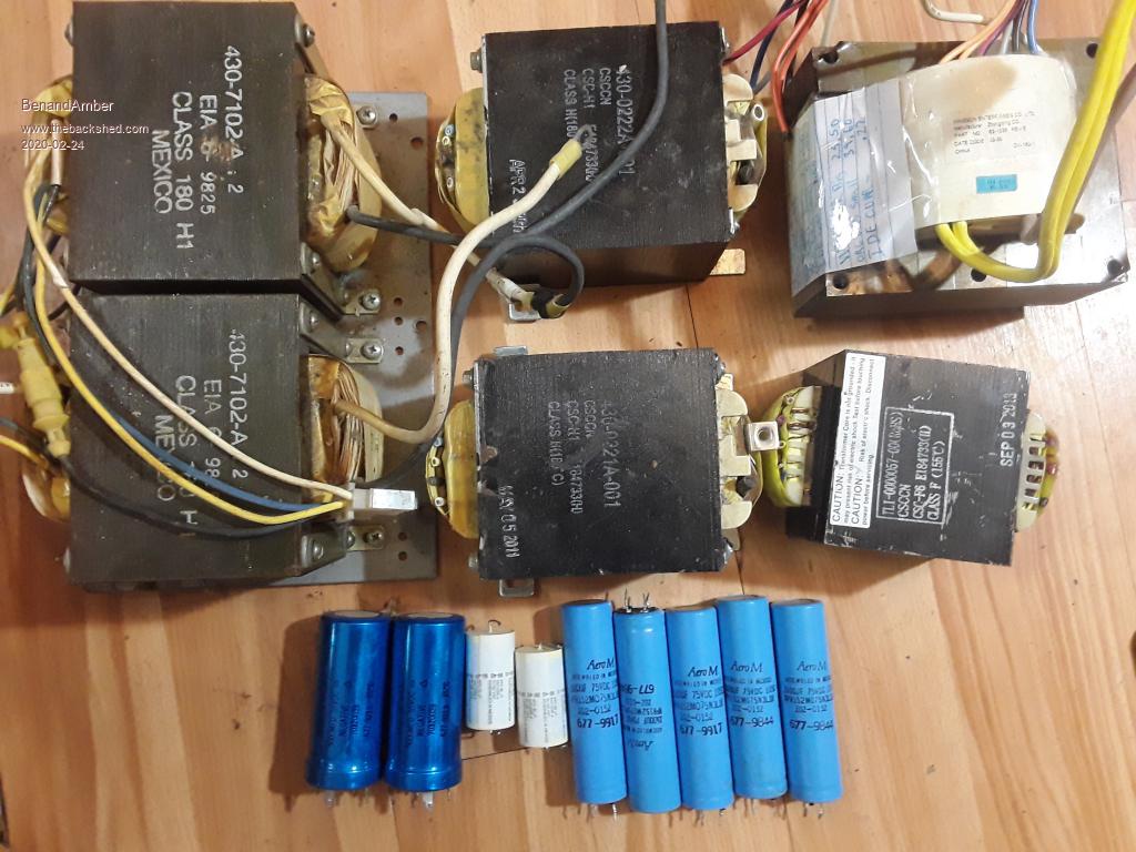

BenandAmber
Joined: 16/02/2019
Posts: 961
Posted: 09:28pm 23 Feb 2020
I sent you a private message
I have a few other ones also
The two that are bolted to the same plate on the left I would guess weight 50 lb
Edited 2020-02-24 07:33 by BenandAmber
