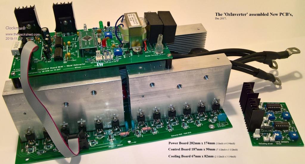

There are several quite different ways to drive a pwm bridge, quite apart from the actual physical circuitry.
First there is bipolar drive, in which each half bridge is continuously driven with a full pwm sine wave. All four mosfets are driven constantly all of the time with pwm, which generates two anti phase sine waves at the transformer primary.
That is probably the best, but switching losses are going to be higher and all four mosfets need efficient high frequency high powered gate drivers which costs more.
Then there is unipolar drive, and there are different versions of that.
Two mosfets are driven with high frequency pwm, and the other two mosfets are switched hard on, and hard off, at only 50Hz.
The two mosfets being pwm'd can either be the two lower mosfets, or the upper and lower mosfets on one side of the bridge.
There can be problems if you start mixing driver boards with power boards if the power board has a wimpy gate drive circuit for one pair of the mosfets.
If all four gate drivers are capable of high powered gate drive, then it should be o/k.
Mad's totem pole driver power board is certainly a step forwards and recommended if you are going to go with pwm.
But as you try to switch more and more current by driving more parallel mosfets, the Gods of fire and destruction may become angry.

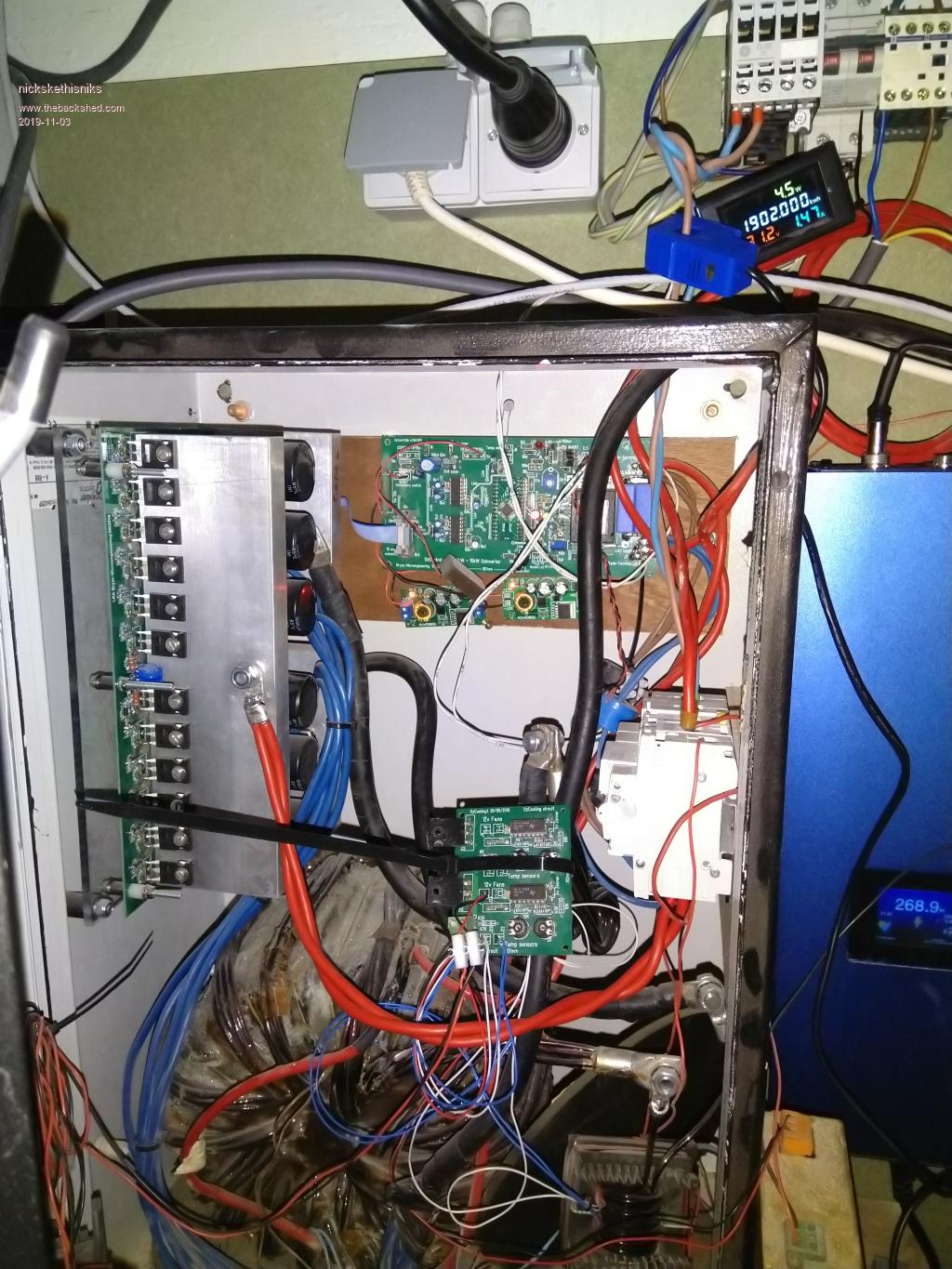

If I need to choose again I would do a Warpverter I think, but I still don't have one. I will make one in the future
WHY? I would chose a Warpverter because it "can" be more powerfull, I trust the design more, it's not simple to switch high current at high frequency, the warpverter topology solves that for a bit I think.
BUT:
The Ozinverter is cheaper/kW , smaller/kW, I think also less Idle current.
I have made a verry powerfull OzInverter (clockfrmann boards), and I'm running it more then a year now (1900kWh), now the whole house is running on it. Load to 6000W is no problem at all. I'm not pushing it further because I know I screwed up the electric conductivity between mosfet and heatsink. (heatsink is used as conductor). I still need to check/improve that.
I only had 2 faulty mosfets and drivers, and that was my mistake during testing, I made a ground short circuit with high side scoop measuring.
I still use the ribbon wire between power and drive electronics, I use 6 irfp4110 mosfets on each H-bridge leg. And my inductor is way to small for the loads I put on.
I must say it only sees temperaturs between 12 and 20°C.
The only thing it doesn't like is the startup of the mobile airconditioner and hairblowers and heatguns, oh he really hates it! ( terrible noise) I think they cut the sinewave in nasty stuff.
I made a few changes to the original: IR2010 drivers, 15V (12v original?) supply to gatedrivers, I think I have put a diode between control electronics and power electronics, so it shuts down on a proper way. I also used small buck converters (5 and 15V) to reduce idle power even more.
With what I read and followed here from other builders I think the nanoverter combined with the totempole drivers powerboard is a more improved robust version. But the original ozzinverter is easiest, less components to solder/program.
Important is to use genuine parts! A lot of problems could be avoided if you use genuine parts from the start.
Oh I configured my sun 2000G grid tie inverter, so it's in parallel with my OZinverter. The sun2000G inverter senses if there is powerdraw, if there is powerdraw the sun2000g inverter will sent back that power (max1800W).
Example if there is a load of 3000W, the grid tie inverter will put in 1800W, the ozinverter will only do 1200W. The sun2000g will even see the other grid tie inverter and will not give power if there is not more power needed.
A picture of the monster (the way it looks):
btw, the watt meter is confused because of the backfeeding... it sees 1.4Amps but only sees 7Watts?

  rogerdw said
Thanks for your input too nickskethisniks.
Very interesting to hear your views and your first hand experience. Nothing beats personal experience, no matter what 'theory' or opinion says.
Gutsy looking torroid in your build and nice clean looking output board.
I'm surprised by the smaller size of your heatsinks compared to most that have been shown  ...  how have you got on with heat  ...  or are you in a cooler area?
Point taken about genuine parts too. Will need some help to know exactly what suppliers can be trusted and who to avoid. Thanks.
Cheers,  Roger
Yes, good notice, my mosfets are bolted too 12mm thick aluminium, since the system is in my basement it  never sees temperatures over 18°C. They get warm but never too hot to touch. Constantly running it around 3000W is no problem. For high peak load it has enough thermal mass to collect. I "was" planning to bolt some fins on it, but it works fine like this... Not recommended for hot climate.
The frontdoor has 2 fans of 120mm 5W, that are running from the moment my inductor reaches 30°C. The inductor is @ this moment the weakest link in my system.

Ok, there's a lot in there to absorb. I had wondered about the length of ribbon flopping about just waiting to pick up something  ...  but I don't know enough about high powered fet ccts to have thought about your other points. Easy enough to avoid if thinking about it before starting ... hopefully!
Good summary on Oz  ...  that makes sense.
Thanks for the explanation  ...  though I don't think I'll get away with that for mine as my shed will get a lot warmer than 18°C in summer. Try 40°C+
Your inductor is in the square former at bottom right corner?

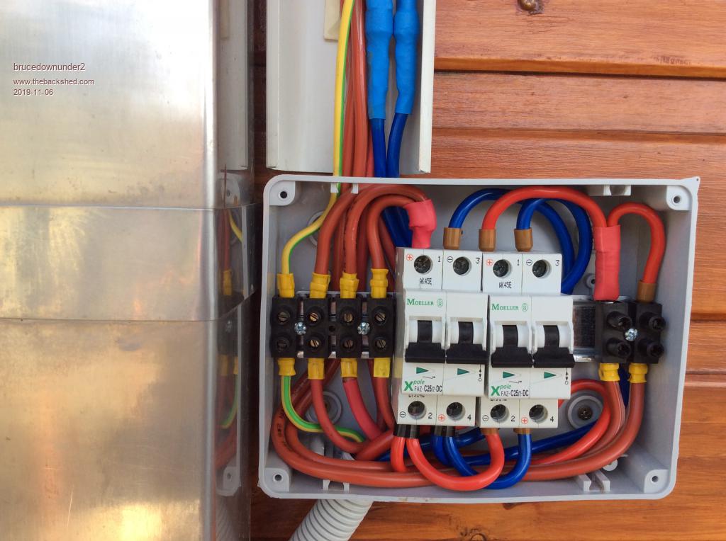

I just finished a disconnect box for my 2 strings of 1Kw panels .
Tried to resize , sorry.
Bruce

  brucedownunder2 said  I just finished a disconnect box for my 2 strings of 1Kw panels .
Bruce
Thanks Bruce, I was going to ask for photos of layouts etc once Mark started mentioning them. That's a very tidy (and tight) connection box.

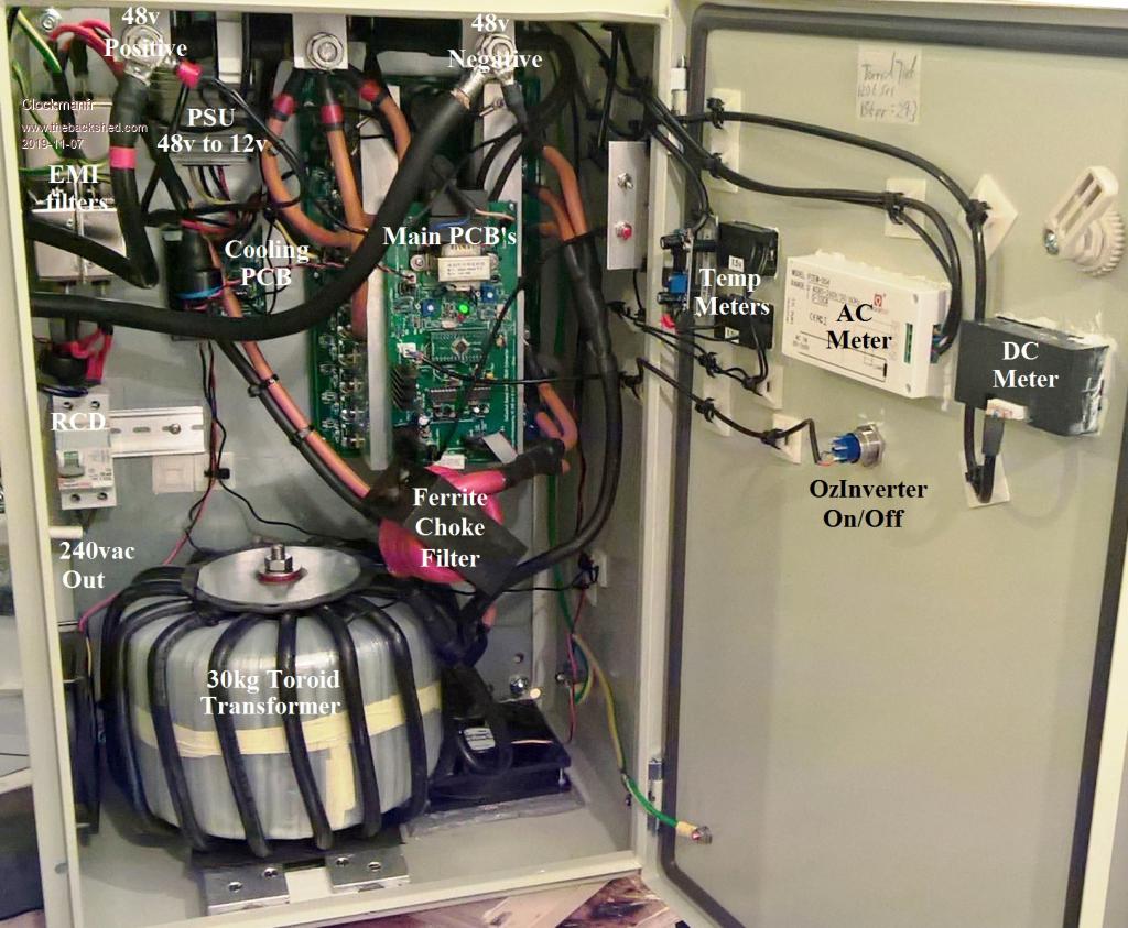

Inside of a working OzInverter.
Keep the cables tidy and air space between the cables, especially the power cables, or parasitic frequencies will be induced when cables get close to each other.
I thought it was standard common sense to keep AC high voltage separated, AC low voltage separated, High voltage DC power cables separated and low voltage DC cables separated. Etc etc.
The ribbon cable between control and power board is short, and should be no longer than 200mm and should have air space around it.

Thanks Clockman, that does help. I had seen a couple of those photos and videos before but it's good to refresh my memory.
I had also wondered about the physical layout and location of wiring etc. Also about fitting shielding perhaps  ...  or even those rectangular ferrite blocks to go over the ribbon etc etc.
For you to mention that it's important to keep the ribbon at 200mm or less  ...  I'm assuming you suspect that interference can potentially get into the ribbon and create false triggering of fets on the OP board??
Still, if you and oztules had already built quite a number  ...  a direct copy should make it possible to replicate.
