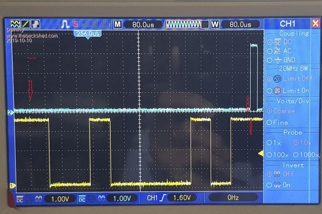

Posted: 12:41am 10 Oct 2019
Regarding the interrupt timing, I ran the following code on a 170 and fed characters into it from a terminal.
The delay between the end of the stop bit and the Rx interrupt service routine activity starting was around 80uS - it varied a little by 5uS or so and this is because there is no way of determining EXACTLY where in the do/loop sequence the interrupt occurs.
This is exactly in line with what you would expect as each MMBasic line interpretted takes on average 30uS so the jump to the interrupt service routine then get the character with INPUT then pulse the pin ~ jump time + 30uS + 30us.
If you omit the INPUT statement, the lag is less than 10uS between the end of the stop bit in the received character and the leading edge of the pulse
This is absolutely repeatable so any delays in servicing an interrupt are solely due to what other activities the 170/MMBasic is trying to do at the time the interrupt occurs.
Looking at the interrupt priority order, only higher priorities will break into the processing of the COM interrupt service routine.
SETPIN 18,DOUT
PIN(18) = 0
OPEN "COM1:9600,512,COM_Int" AS #1
DO
LOOP
SUB COM_Int
 A$ = INPUT$(1,#1) ' with this statement in, lag is roughly 80uS
 PIN(18) = 1       '  - with it out, lag is less than 10uS
 PIN(18) = 0
END SUB

I come back with my gps problems. and of courses, a new problem
my pb is false timing of "settick" function.
I explain
I have my uart interrupt (who work weel), and hardware interrupt (from gps module tick 1 sec). and I need an timer internal interrupt, for that , I use "SETTICK 10, sub1,1" instruction.
if I close my com port (without interrupts), it work normally (100 call each seconde)
if I use Com port in interrupt mode (to receive gps frames), sub1 work only 41 to 43 time each second and most important,some time it can take 600ms between 2 calls.
my question is:
can an tick interrupt be masked by other interrupt and in this case, interrupt is lost, or tick interrupt is buffered and when most priority interrupt is finish, tick interrupt is send to programm??
Posted: 03:48pm 13 Oct 2019

I think that error means something is wrong.
Are you perhaps, due to going around your FOR loop, removing an extra character which has flagged an interrupt?  I suspect so, i.e. by having the loop you then cause the error.
uart interrupt is send when one (minimum) char is in buffer. if I receive interrupt and "loc(#n)" say there is no char, this is wrong!!
my code
sub spcomrec5
ai1=Loc(#2)
if ai1=0 then
  print "error i1=";str$(ai1)
  exit sub
else
  dtx$=Input$(ai1,#2)
  nbcar=nbcar+ai1
end if
end sub
