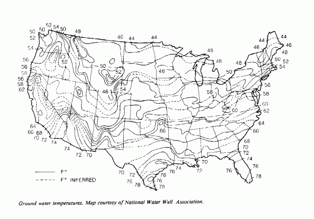

Uncle Sam sometimes can be a big help. This is a map showing thermoclines of the average deep ground temperature (in °F of course) everywhere. At a depth of 2 M the temperature will vary plus and minus 10°F from these average temperatures, +10° about September 15, -10° about March 15. I don't know if the Australian governemnt provides anything like this. (My house sits down there in that sharp corner of New York 4 miles from the giant IBM microprocessor fab, just about on top of the 52°F thermocline, so my annual deep ground variation is from 42°F to 62°F.)
I know very little about the annual seasonal air temperature variations or the annual seasonal variations of deep ground temperature you guys down under experience. Nor do I know how much cloud cover you have. (I seem to dimly remember that it was intensely sunny when I rode a train from Sydney to Perth back in 1949.) I therefore can't comment much about your attempts to collect solar energy.
I can stress that you should try to pick the lowest hill if you're going to try to pump heat up a hill. If anyone wants to really analyze heat flow in his house I'll be glad to assist if I can. Be forewarned that I will probably tell you a lot of Polack jokes at the same time.

Geothermal power is always there, but it is extremely low density giving very low power production per unit of surface area. It originates in the liquid iron / nickel core of the earth which is kept in its molten state by the continuous fisioning of vast masses of trans-uranic elements.
The earth is constructed like a soccer ball with a diameter of 8000 miles and a solid crust averaging 125 miles thick. High density geothermal heat escapes along the boundaries of tectonic plates -- in the mid ocean rifts and weird places like Yellowstone National Park.
Coralling this heat just before it reaches the surface and detouring through a heating system or an electric generator has absolutely no environmental impact. All that it does is move the point where the heat energy would escape to the atmosphere from somebody's backyard to somebody else's toaster.
Paul in NY
