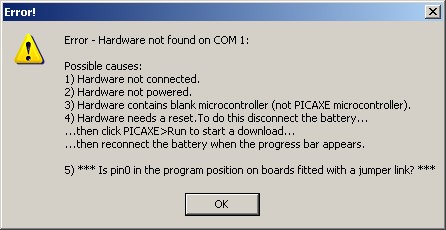

Before you said you were getting this error message
Or has it changed to this one which is what I'm getting now and I can't track it down? My chip is perfect in a different board.
If your having same error I'm looking for the common component at fault.
Cheers Gill _Cairns, FNQ

the first error is the main one i get, i did get the 2nd one once, when i connected to my sons computer, I could see firmware ok, then i got the 2nd error then i tried to program the chip and got the 1st error.
even with the LED test which removes most components i get the 1st error, i checked LED polarity and the resistors b4 assembly.

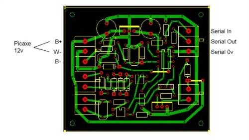

Of minor concern but major effect is where you connect the 12 Volt power to the terminal strip. B+ is clear as it's the top one. The middle one is W- (Windmill neg ?) and the bottom one is B - (Battery neg ?). For setup and testing connect 12 volts across the terminals you have marked B+ and W-. Your terminal B- is for your Amperage metering and is not used for powering up the Picaxe.

well done gill glen and gordon many thanks, the board was fine i just added the caps and re-made a new serial cable, also found an incorrect resistor on the power circuit part of the board whist i was soldering on the caps.

my question is whether i should change the 10k resistor on the top pin to the opto to a 39k like the power circuit does to the 22k as i am using this for a 24v setup, if so i may of cooked the opto, dont panic Gill lol this is on my 2nd board i made for 24v not the one you fixed for me
also whether i should change any other resistors for the 24v board, the block picture in the circuit diagram folder only shows the 22k for the voltage part of the circuit and doesn't suggest any other being changed.
