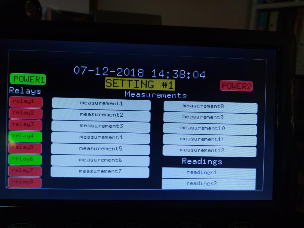

Im driving a 4" backup camera display with the composite output from a RPi Zero W.
 Haven't loaded the MMBasic on the RPi yet playing with "learning" Python.
  There is a lot of code at Adafruit
  Adafruit  1115
  code on git
 Adafruit more upto date git code
  Here is some MMBasic test code for the ADS1115 derived from the code at Adafruit.

Sorry Peter that I didn't get back sooner. The setup is at another location
 and I haven't got back there.
 The display has two video inputs and will auto switch to an active source.
 Video one source is a backup camera with power controlled by the RPi.
 The RPi replaced the DuinoMiteMini I started with.
 The MMBasic for it didn't have some of the newer commands/functions and (wifi)
 The display is a bit off on the right edge and at times there is a bit of jitter.
 It was to be for my Three wheel E-bike. But that project is a long term thing.
 The end goal is to have it show me whats behind me and stats on the bike i.e
 speed, battery time, voltage, current. With the RPi Zero W wifi I want it to
 send images to my phone when some one get close. And maybe do a two way voice
 thing like the video door bell things. For now other projects need my time.
Have a look at mini Maximite
I was looking at it for my bike project when the RPi zreo W came out.
The RPi zero W with MBasic is where Im headed just need time for my projects.
