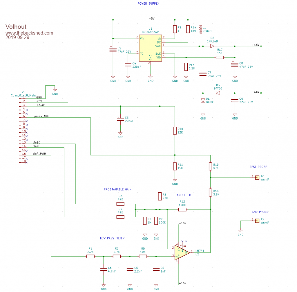

@Volhout
On the schematic R9 is shown as value 1E, what value should it be?
Trevor
Posts: 6254
Posted: 09:09am 23 Sep 2019
Hi TrevoH,
1E means 1 ohm
TrevorH

R16 is 3.9k (according to your correction earlier). R16 is the output resistance of the instrument. If a lower output resistance is required, is it simply to replace 3.9k by e.g. 1k? Suppose that R15 (47k) then also need to be changed?

Hi Pluto,
Your suggestion to lower the output impedance to 1k may work. I would change the 47k resistor to 51k to prevent overdriving the ADC (clipping).
There may be some effect for the power supply and opamp though.
The opamp output is +/- 14V roughly. With 1k output resistance that would be 14mA in case of a short circuit. I have not checked if the power supply can deliver this much power at +/- 16V. You may need bigger caps and diodes. And maybe need to change the 1 ohm to 0.5 ohm.
The MC33063 is fine. It has different temperature range, but for the rest is seems identical.
I am glad you are having fun with the circuit....

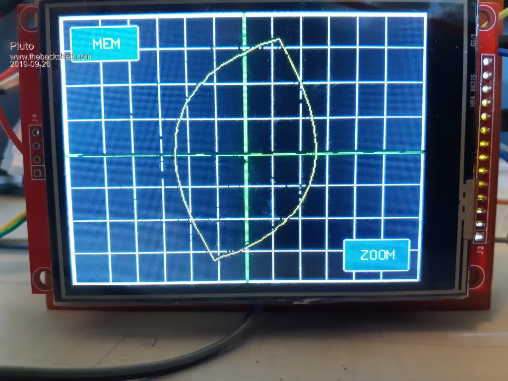

Horisontal grid approximately 2V per division and vertical about 1mA per div. in normal mode. About 1V/div in ZOOM mode (No decimals!)
This is in fact sufficient accuracy for me to get approximate zener voltages, LED voltages, etc.
Added just a few lines to Volhout's code in Sub draw_window :

I am sure there are more clever ways to do it than my quick and dirty approach.
Please note that the grids are gradually disappearing when curves are displayed over the grids. Fresh grids by restarting the program.
Thanks Volhout for an interesting instrument. Looking forward to see coming versions!

About the degradation of the grid lines. If you add these lines to the touch interrupt (just before the end), then at every touch at the LCD the grid is redrawn.
That is what I plan to do, regardless whatever method or alternative I choose...

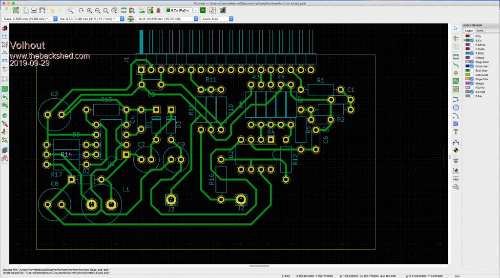

May have been a habit from one of my former jobs?

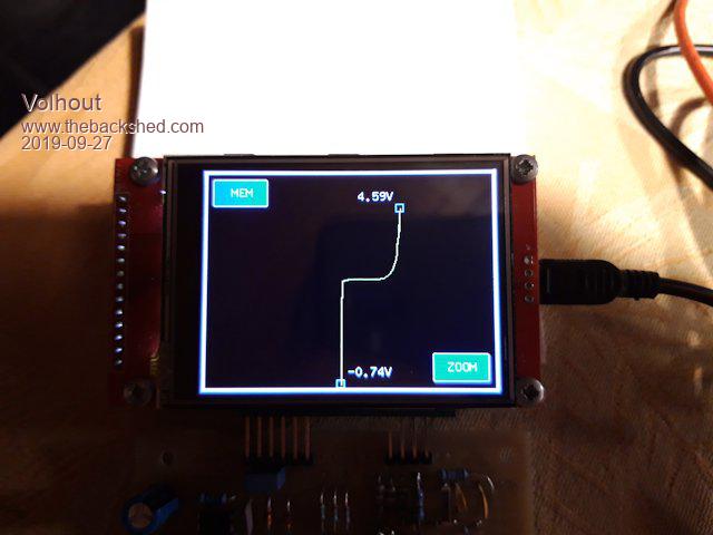

I planned this week to work on the board layout, but was triggered by the work done by Pluto to improve the software. So I spend some time behind the screen, and added dynamic measurements. Found that more accurate than a grid.
The measurement values are calculated from screen coordinates, and are therefore not as accurate as the ADC could do, but since we do relative measurements mainly, this seems accurate enough. Actually, it is so accurate that we may not need the zoom mode anymore....
Here a screen shot
I am a bit hesitant to insert the code, since it is becoming large. But anyway, here is the listing. The measurements are calculated using is 1 second timer, so it doe not slow down the waveform plotting constantly.
Enjoy....

Small project hardware update.
I noticed that the opamp LM741 runs close to saturation when driving -14V.
The LM741 was chosen because it has a max voltage rating of +/-22V. In our circuit t is powered from +16.2V/-15.3V which is safe. Can't use a +/-15V rated opamp though.
So I decided to increase the voltage from the power supply to +16.8V, and the negative voltage to -16.5V. This is done by following changes:
R17 changes to 15k
R13 changes to 1.2k
Diodes D1 and D3 change to small schottky diodes (BAT85 or 1N5819).
I will reflect these changes in an updated schematic later this week.
Another thing: I noticed that the LM741 and uA741 parts are basically obsolete. Prices at Farnell are up to 10 euro per piece. A good replacement would be the MC34071 or the TLE2141. These are available in DIL and have +/- 22V supply range (cost around a dollar). Haven't tested these part yet. If there is demand for this circuit beyond the 3 or 4 people involved now, I may redesign it to work with standard +/-15V opamps or use a discrete amplifier.
That's all folks....
Edited 2019-09-27 18:23 by Volhout

Pluto
Joined: 09/06/2017
Location: Finland
Posts: 421
Posted: 09:55am 27 Sep 2019
Hi Volhout,
I replaced the UA741 op-amp with TLE2141IP (+/-22V max supply).
Voltage output swing improved from 25.7V to 26.5V and the shape of the output wawe improved at the minimum output voltage; Became a sharper "V" with TLE2141.
TLE outputs are very equal for negative and positive outputs. Better than LM741.
I do not have MC34071 for testing.
The price of TLE2141 is $3.5/5pcs=$0.70/pcs from AliExpress. Same cost as MC34071.
Tested your new program version. I like it!
Thanks!

Posts: 6254
Posted: 04:24pm 28 Sep 2019
I updated the schematics, and show a layout proposal.
Happy prototyping
Edited 2019-09-29 02:25 by Volhout
