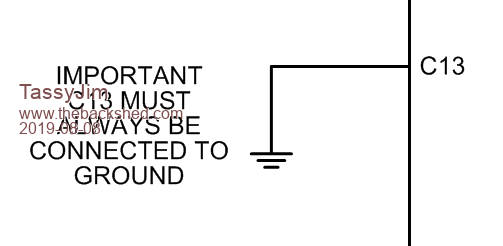

Can you put it into bootloader mode by grounding C13 while booting?
The yellow LED should be flashing.
The original instructions for MMBasic on the UBW32 requires C13 to be permanently grounded but in my case, it is only grounded briefly while booting for bootloader mode. All other times it's floating.
From the original but not in my case.
If you can get bootload mode working, run the Bootloader.exe and see if it finds the UBW32 again.
There is no need to actually re-flash it but it wouldn't hurt if you did.
I don't know if the UBW32 I have still has the original bootloader or the one provided by Geoff.

My UBW32 CMM has C13 permanently grounded. I used the as-supplied bootloader to load 4.5C and it's worked fine ever since. I have a PicKit 3 so could flash 4.5C directly but I've not needed to do that.
