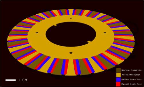

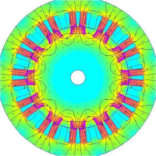

Rotor Design
I may be able to get a friend in Brisbane to laser cut laminations for a rotor and keep the 36 slot stator and remain on budget...which isn't much
I have included the rotor I have designed (last image below) with the proposed positioning of the magnets. I have kept the scale of the rotor within the dimensions of my stator which is being restored at this moment.
The current thought is to purchase 36 neodymium magnets (N45) at 5mm x 20mm x 20mm for each rotor. The cost being met by recycling copper from old motors I have stripped. I may have several (first image below) individual rotors (coloured black) fixed to the one axial shaft (coloured green), with the thickness of each rotor being determined by the depth of the magnets (a rotor 40mm deep/thick would require two sets of magnets, which would make a total of 72 magnets per rotor) arranged in the following manner...
The last image below shows the positioning of the magnets for my rotor. I found a link on this or another forum to 3d software "freeware" that helped me design this image... design software here
There are 18 rotor teeth (labeled as "active magnetism", coloured orange) that have effective magnetic flux towards the stator.
Nine teeth are south pole (blue) orientated and the other 9 are north (red).
There are 18 remaining rotor teeth (labeled as "neutral magnetism", coloured brown)that have no effective magnetic flux towards the stator.
There is room for improvement...
...remove the "neutral" teeth and insert larger magnets - but cost will stop me here I think.
...enlarge the "active" teeth size to accommodate the increase in magnetic flux created by larger magnets.
Dumbass question, is this an 18 pole rotor?
Any thoughts on this proposed setup using my 36 slot stator would be great Edited by CraziestOzzy 2008-08-06

I'm not sure I'm seeing this in my head right. Dinges is probably the man to work these magnetic thinggy's out... So I will make some observations so that he may sort us both out perhaps... should he wish to comment at all.
If someone is going to cut the laminates, why not cut them to do dinges style of rotor (in laminates instead of solid).... less material,cheap steel, and better results, standard magnets etc.
I think it is 18 pole as you have drawn it, but pole leakage will be greater than using a normal orientation, and if you are going to custom cut, why not cut for best results. Burying magnets in the material will never give the same results as surface mounts apparently.
To add insult to injury, the cogging would be a real problem.
Just my thoughts on it... and I might not be "getting it"
........... oztulesEdited by oztules 2008-08-06

Hey Craziest,
Oztules basically said it all. Yes, it is an 18 pole rotor. But with 36 stator slots (and assuming you want it to be a 3-phase generator) rewinding wouldn't be straightforward.
http://www.powercroco.de/Kombinationstabelle.html
The above link is to a (huge) site mostly for small CD-ROM RC-motors but much of the theory applies to our gennies too. I checked and you can theoretically rewind for 18 poles/36 stator slots (see the handy calculator near the top of that page) but only two phases, it seems.
I don't see the advantage of using laminates to mount the permanent magnets (PM) into, as there's no changing magnetic flux these laminates see there will be no eddy current losses. A solid steel rotor core should work just as well and be much easier to manufacture.
Then there's the cogging you'd have to take into account. I won't go into detail here because the next point will (or: should ) stop this plan immediately...
Oztules was right again (ouch, hurts to say that aloud) when he mentioned the flux leakage. I ran a quick FEMM (magnetics finite element software) to make that visual:

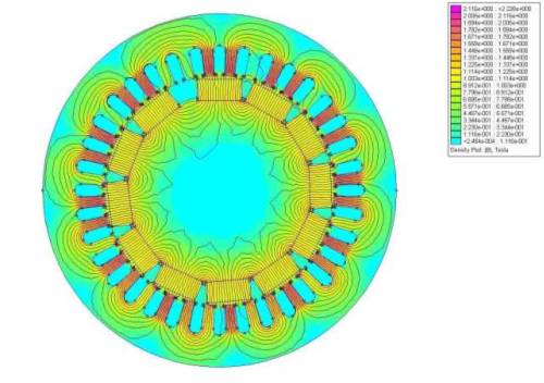

The full, high-resolution images can be found here:http://picasaweb.google.com/motorconversion/Temp
Notice how much of the magnetic flux gets 'shorted' inside the rotor ? About 2/3, by my estimation. Relatively little flux leaves the rotor to enter into the stator (where it would be actually useful). It would make very bad use of the magnets.

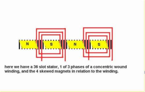

yeah, quick reply. Cheers...i was thinking of skewing the stator teeth to reduce cogging and have laminates as mentioned...will look at Dinges thoughts when I come back home and read both your thoughts more thoroughly. Much appreciated Oztules and Dinges.

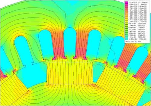

CraziestOzzy.
It does not matter for these purposes (rotor) whether you use laminates or solid steel to transfer the flux lines to where you want them... only that you Do Not Use Aluminium as a substrate to put the magnets on.

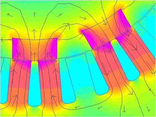

Here is a simulation shamelessly stolen from Dinges file archive. Note Carefully the flux lines, not just the ones you want to do the work, but the return lines... thats right , they must make a full circuit.
And a closer look. Notice the few magnetic circuits that do not go where they were going to be useful. It will always happen, we just need to design it so that it is easy for the flux lines to take the route we want them to take.... there will always be a few stragglers. There is a small leakage between magnets here, note the little circuit between the center and right magnet. So look out for paths that encourage leakage from one magnet to the next, or straight back to itself.. eg from sinking the magnets more than 10% into a steel rotor to hold them .
You will see that the flux is concentrated exactly where he wanted it, in the teeth where the coils in question was seated. Every line leaving every magnet is closed somehow.
Note the rotor, all those lines joining up the magnets return circuits. If you made the rotor out of aluminium, flux would jump from the front of the magnet straight back to the back, and never see the gap you want it to jump. Thats why you must have steel backing the magnets so the return path is assured. In the axial flux types, we use heavy steel plates at least 8mm thick to achieve the same thing.
We use aluminium as a jacket precisely because it does no affect the static magnetic lines and does not encourage leakage of flux from the front to the back, it just mechanically holds the mags in place (dinges used epoxy instead I think).
We cannot use Aluminium if the magnetic fields will cut it.. ie in the stator, as we just generate enormous eddy currents. Or any place where alternating or moving fields may cross the al.
The best way to do it is to have a steel rotor with mags facing the stator, held in place by some magnetically inert material.
Think Magnetic CIRCUITS, and you will do a lot better.

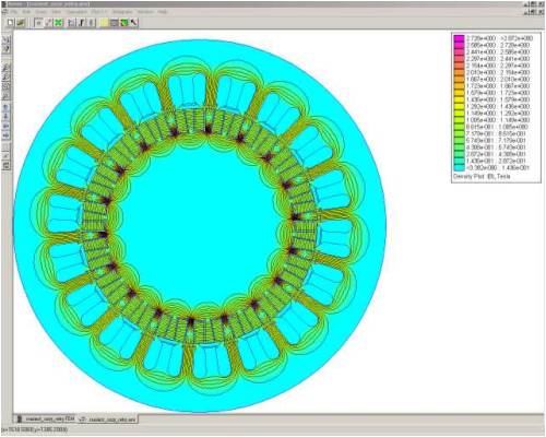

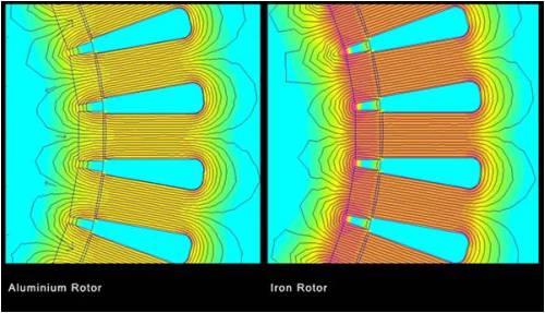

Well, Dinges is right...just read the previous replies after I had downloaded FEMM and learned a new interface to confirm and disprove some wild theories I had about magnetism...I had to use a freeware CAD type program to create the geometries and import them into FEMM.
I did confirm that a magnet placed next to a stator tooth with an air gap of 0.5mm redirected the flux through the tooth as I had previously thought after Dinges corrected me on some false assumptions I had when he showed me some FEMM analysis of my previous ideas...
The rotor is solid aluminium as I was advised to make it simple so my mate in Brisbane won't have a dummy spit with something complex.
The whole rotor/stator combination is working in theory and looks just dandy...
Next task for me is to experiment with smaller N40 magnets so I can cover every stator tooth with a magnet or something similar anyway.
Big thanks to Dinges again for re mentioning the FEMM prog...makes life so much easier

  CraziestOzzy said  The rotor is solid aluminium as I was advised to make it simple so my mate in Brisbane won't have a dummy spit with something complex.
Good to see you got it working ! Nothing like playing around a bit in software to try out the latest crazy idea that gets in your mind. Won't even have to get your hands dirty.
One thing though, the aluminium rotor isn't a good idea. It may work, sort of, but a steel rotor will make much better use of your magnets. I'd try to run two simulations, one with an aluminium rotor (as you've done above) and one with a steel rotor, and then compare the flux-densities you get in the stator. It's my expectation they'll be quite a bit higher using the steel rotor. Would be nice if you could upload the results to this thread.

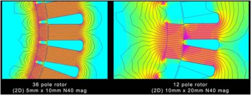

  CraziestOzzy said
Very nice. I see one thing wrong though in this simulation, an error I made in the beginning too: you haven't defined a boundary condition around your stator ('zero' boundary condition). This causes some of the magnetic fieldlines to leave your stator which in reality doesn't happen. So, define a 'zero' boundary condition and assign it to the outer circumference of the stator. Then run the simulation again. All magnetic fieldlines should then stay within the stator.
  Quote   Next task for me is to experiment with smaller N40 magnets so I can cover every stator tooth with a magnet or something similar anyway.
This may not necessarily be a good idea. I normally strive for 2/3 of the circumference of the rotor covered in magnets, not 100%. Have a look at these pdf files written by the master, Zubbly himself:
http://www.otherpower.com/images/scimages/4/z_conversion_all .pdf
http://www.otherpower.com/images/scimages/4/zubbly2.pdf
As far as 'stator coverage by magnets' goes, your current setup looks actually pretty good to me. It's a 12-pole rotor too and that should make for easy rewinding in a 36-slot stator. In the current situation your magnetic poles will fit exactly within a stator coil, which is the ideal situation that Zubbly describes in one of those pdf-files.
I'm talking especially about this image from Zubbly in his pdf files:
If you 'cover' the circumference of the rotor for 2/3 with magnets you'll nearly automatically arrive at this situation, with a bit of space between the magnetic poles. Each magnetic pole will then (roughly) 'fit' inside a stator coil. If you have a look at Zubbly's photo gallery (http://www.anotherpower.com/gallery/zubbly) you'll see that in most of his conversions the magnetic poles cover about 2/3 of the circumference of the rotor, with a space of about 1/3 between the poles.
Only thing you'd still have to take care of is the decogging. Apart from that it actually looks 'fine' as is to me.Edited by Dinges 2008-08-09

CraziestOzzy, Whilst aluminium will work, it will be a poor performer compared to the same magnets on a steel rotor. If you have a look at your strongest fields, they are concentrated in your magnet. If you look at Dinges, his strongest flux is inside the stator teeth where you need it.
So you have wasted some of your flux.
It is worse than it looks.
When you do your calculations for turn/s volt it will be lower than the steel version, and you will have to cram in more turns than you would if you had used steel. This will impair your performance as the new resistance decreases the power of the stator as a square function.

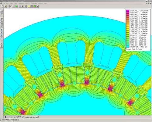

If your man wants to cut steel laminate plates rather than machine a solid steel rotor, then this will be a lot better than aluminium I should think.
Your magnet managed densities of 1.7 and the stator mostly ended up at 1.2 to 1.3
Dinges magnet started out at .8 or .9 at the magnet, and managed to get the density up to 1.5 in the stator where you need it. That means he seems to have doubled his flux where he needed it from his source, you have managed to tie up most of the flux inside the magnet, rather than the stator.
The amount of lines in the magnet itself makes me feel that there is something wrong with this. There seems to be too much flux to go around... like you have n50's in there or something.
There is no leakage shown, and this is highly improbable. I would expect leakage to the next tooth as there is no circuit between magnets, and the tooth is midway... it should have attracted some lines.

Well, thanks Oztules...food for thought and point taken.
As some concern is expressed about cogging, I mentioned before I will be having offset stator teeth.
As requested, the next picture shows the difference between using an aluminium rotor and an iron rotor to house the magnets.
I am going for an iron one
...there was heaps of loss and some hysteric mayhem occurring within the aluminium rotor that was relatively non-existent within the iron rotor. There are heaps of smaller arrows imitating a lump of spaghetti that can't be seen here due to downsizing for the web. It was not looking good for the lighter weighing aluminium. The arrows show where the loss occurred within the aluminium rotor:
The next picture shows the flux densities compared with change in magnet size and pole count.
I liked the even distribution of flux using the 36 pole setup with the smaller magnets. Each magnet had its own stator tooth. The downside here is that the close proximity of the magnets (<5mm) retained most of the flux in the rotor and did not "send" it to the stator.
I also liked the 12 pole setup where the magnetic flux was substantially increased using larger magnets with the downside of having 12 stator teeth "dead" with only 24 teeth doing something useful. I will be reducing the outer diameter of the rotor to about 10% of the height of the magnets to see if I can direct flux to where it is wanted...into the stator.
Irregularities in flux distribution is due to my design on the FEMM program, something I will work on later.
So I think I am settling for the larger magnets of a 12 pole rotor working its magik on a 36 slot stator.
It is easier to machine on a 3 axis mill and easier to wire and also using a multi rotor setup, lighter to send in the mail for individual packages. I will have to raise the magnets so that they are not seated 100% into the metal rotor...way too much loss at 100%. You are right Oztules when you said to avoid magnets at close proximity to each other and seat the mags ~10% into the metal rotor. Looking forward to checking these points out inside FEMM.
I am also looking as mentioned, at having several rotors at a thickness of about 60mm each. I am very much aware about resistive losses and will be watching my wire combinations closely. The best part I like about this multi rotor setup, is that I can simply add more rotors to the shaft when finances allow for expansion. I obviously will have additional stator laminations to cover the expansion.
Once I have my complete design together, I will run it by you gurus first before I send the CAD file to the mill shop in Brisbane.
Cheers and thanks heaps for valuable input...I have come a long way and learned heaps since I posted my initial crazy idea.

Cool, 12 poles 36 slots is the way to go. Iron core, and if you follow Dinges rotor design (except yours will be geometric 12 sided with skewed stator), with the small ridges to separate the magnets, you will do well.
Adding to the design sounds like a lot of work. Each time you will have to carve new blades, and rewire the stator to reflect the new power curve of the alternator...
I think the hysteric and eddy losses for the Al rotor reflect the logjam of fieldlines under the magnets which are unstable, and will probably switch the lines in the inner center from one side to the other at the slightest tooth ripple.... changing fields through the AL and generating currents. An animation with higher resolution may show this to be the case... or I'm full of it.
It may help to get a better idea of your Femms by getting the slot geometry closer to realistic. Your slots can't be shaped like that surely.

Craziest,
Good to see you've seen the light.
One more thing, something I neglected earlier to say to Oztules in this thread but which I'll mention now: be careful when you compare two different simulations to eachother just based on the colours. Standard, FEMM assigns other colours to the *same* flux density in different simulations. 'Autoscaling' it's called. This can bite you if you don't realize it. That's why I always include the colour legend in my simulations. You can also force FEMM to always use the same colours for simulations by specifying the lower and upper scale limits. Just a heads-up.
The irregularities may be artifacts caused by FEMM. Judging by the output you're using automeshing to generate the grid. I normally don't use 'automesh' but determine the mesh-size myself. I also normally generate pretty fine meshes. This makes the simulation take a bit longer to calculate and show the results but I prefer the more detailed results.
I agree with Oztules, I'd build the rotor just once, rewind just once and get it over with. After your first genny you probably have a desire to build a few more (if you're like the rest of us ) which still gives you plenty of opportunity to experiment. I so far haven't heard of anyone who could stop after his first genny. It's habit-forming...
