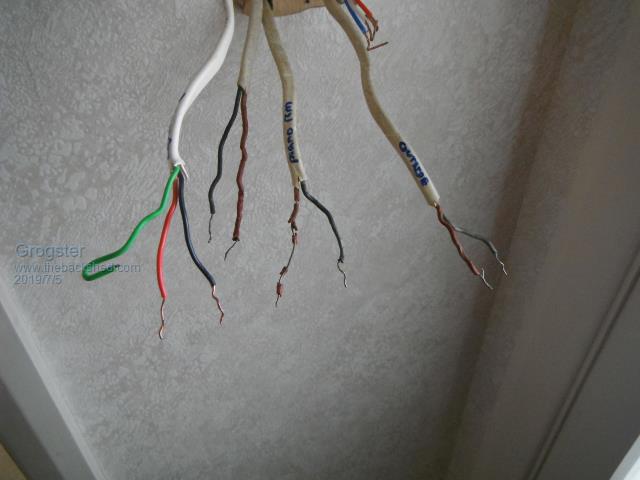

EDIT: Original post I have tried many times today to post:
Yes, pigtails are not generally used in NZ. I expect that is the same in Australia, as we share the same code. (the AUS/NZ standard)
99% of most domestic single-phase installations have the TPE/T&E loop around all the outlets AT the outlet, so you have an incoming 'FEED' and an outgoing 'LOOP' to the next outlet. On the old fuse-based panels like I have here at home, there are generally about three outlets on any one feeder. The new regs I think require that outlets are split into two or three per MCB, and I think that nowadays those three outlets are also protected by an RCD. That would make sense. I know I have seen configurations like that in new houses that they build. This does make for a rather over-complicated main panel though, IMHO....
[Quote=Boppa]Re the extra cabling to light switches, it's been required for a while for all lighting circuits to have the earth fitted (so TPE, rather than twin) but it was the norm to chain at the bulb and just have a twin down to the light switch from the light fitting, now it's becoming the norm (especially with touch or smart switches becoming more common) to chain at the light switch ie TPE to the switch, and again up to the light fitting, with the chain to the next room coming from the switch rather than the light fitting...
(if that makes sense)[/Quote]
Yes, it does. This is how pretty much every lighting circuit I have seen over here works in a simple domestic MEN install. A feeder in, a loop out, and a third wire to the light fitting(or fittings). Also quite common to find a forth cable in the same box, if there is a 2way switching arrangement such as in a hallway, where you have a switch at each end of the hall, and either one can switch the hall lights on or off. Things get kinda crampt in THOSE boxes, if you are unlucky enough to have a single wall-plate with all that behind it!
My house, luckily, uses dual switch plates(double size ones) for the hallway 2-way and the two outside lights, so that gives me a bit more room to move!
Here is a shot of the wires at the double by the front door:
Nothing was labelled - I have been labelling as I find out where things went to. The labels are only to help me, as these cables will be used as draw-wires to pull in the new feeds. I am using 1.5mm T&E/TPE for the new runs, as I had a roll and a half of that on the shelf, so...
But you can see how the twins at the switch end of things have also disintegrated when I touched them. You can also see a PVC T&E there, which is a feed to the lounge-room that was done years ago when some wall lights were added during the doing up of the lounge. The red/white/blue at the top of the image is also PVC, and is the 2way circuit back to the other door switch. The two rear-rooms also are wired in PVC, so I don't need to touch them, just the original rooms.
EDIT: Yay! Gizmo has fixed the problem. Edited by Grogster 2019-07-06

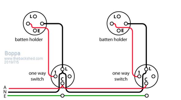

Grogster- ugggh, yeah those cables are toast all right...

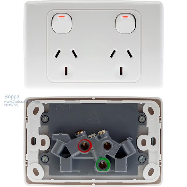

Lizby- there are several differences between US outlets (here powerpoints or more officially GPO's)- we dont have 'pushins' or separated screw outlets, the wires are twisted together for mechanical strength then fitted to a single screw in clamp (Ocassionally you will find a pigtail fitted, but only where there are too many wires to go into the GPO 'holes'
Australian GPO

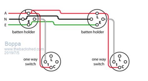

Re the 3 and ground, that's where they want a Active supply, switched Active to the lamp fitting, Neutral and Earth all at the switch (required for most IOT style smart switches) where previously they only had 3 per switch in newer installs (Active feed, Active switched and Earth) and older ones only had two (Active feed and switched Active to lamp...
Old way, looped at light, 2 wire feed to switch...
Newer way, looped at switch, '4 wire' or '3 conductor and ground' switching
(note that diagram is incorrect in one respect- there should also be a green earth wire running to earth light fitting as well, that's required by law now)

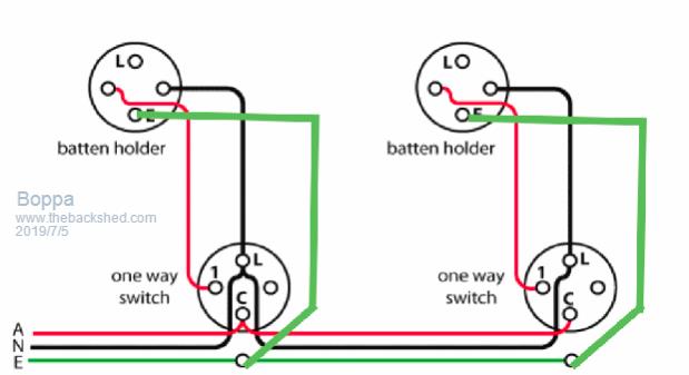

This is what it should be like (biggest advantage imho is its all in TPE- less rolls to carry around LOL)

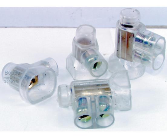

Interesting too that wirenuts are in such common use in the States, I have never seen them used here, and quite frankly not sure if they would even pass inspection
BP connectors are the norm in Australia
The single screw ones are used on A or N wires, the double screw ones are used for earth wires
Edited by Boppa 2019-07-07

Boppa--your last diagram would be the way I have always seen it in new installations in the U.S. and Canada (connectors are different, of course), and what I'd have called wired "hot to the switch".
That's as opposed to your first diagram which is what I would have called "hot to the light" and which has not been allowed in new installations in the 40 years of experience that I have had (not as an installer)--in the locations I have known of--there may have been local variations.
Still wondering what an additional connection to the "batten holder" would be for.

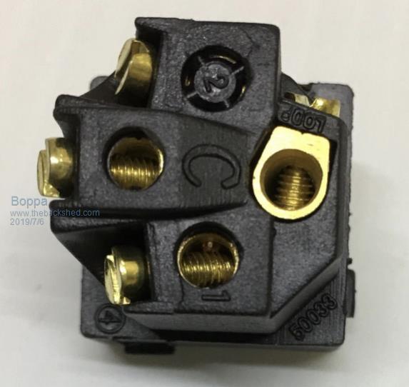

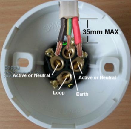

'Hot to the light' is still allowed here (and indeed is the most common still in use) although 'hot to the switch' is preferable as it allows a lot more flexibility
What additional connection?
If you mean the L (loop) connection, it is exactly that- a unconnected terminal built into the fitting- basically a built in BP connector
If you mean a fourth wire to the light fitting from the switch, I can think of several possibilities- especially as you lot don't do 'hot to the light'...
One would be an unswitched Active to the light fitting (for running 'IOT' or 'intelligent' fittings that need power permanently)
Another would be for an Active for a fan (The number of times I've wished they put in an extra wire for ceiling fans/ bathroom extractor fans etc) although I doubt that would be foremost in their minds- making things easy for the sparkies.... HA!!!
Light switch with 'loop'/L connection (the partially blocked 2 is for 2 way (or 3 way as the yanks call it for some reason) switching ie a switch at each end of a hallway so the light can be turned on or off at either end- if you need to use it, just pop the blanking plate out with a screwdriver
Same loop terminal is on light fittings
